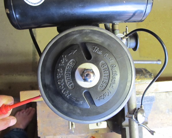

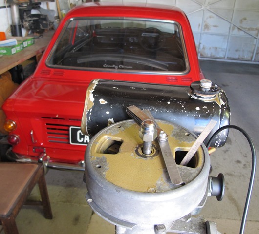

With a screw driver down the plug hole I estimated where TDC is, then clamped the flywheel in place with a G clamp to enable me to take this image.

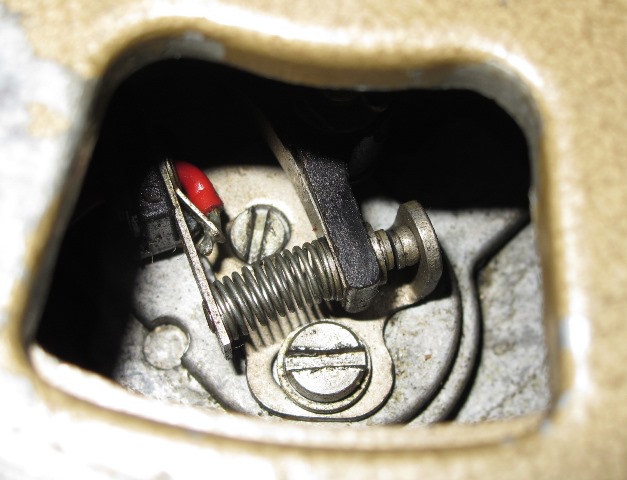

The points are wide open, should they be?
On my 1967 Hillman Imp the spark takes place three degrees before TDC, where should the spark happen with a British Seagull engine?

Re: Forty series Wipac 2 fault?
The timing screw was not tight, it was where it should be ? but not tight.
I removed it, used a tourch to inspect where it should go, then on re tightening the base plate moved itself to what I assume is the correct position, I then tightened the screw.

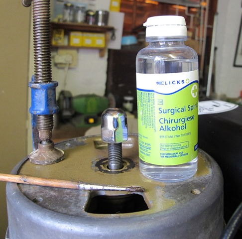

The G clamp screw is holding the flywheel and at what I think is TDC, it is not screwed down hard.
I also did as the hand book says and used alcohol to clean the points.
I then teste for a spark on the spark plug, no issues in that department, the motor still does not fire up !
I was asked on another page to clean the points and check the timing.
I have seen in the Service Sheet that for the Forty series the HT lead needs to exit the base plate in the 8 o clock postion.
My re screw driver is pointing to the center of the HT entry.

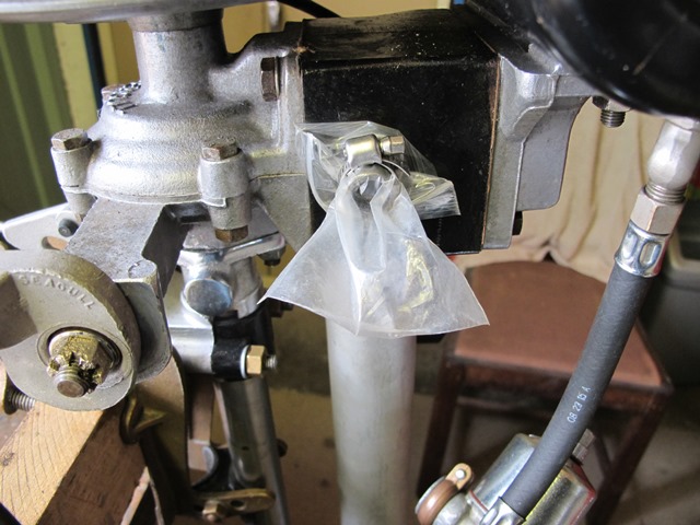

Having proven that there is suction at the carburetor spigot with a small plastic bag, I next need to test for a timing issue by moving the base plate?
Do I move it clockwise or anti clockwise?
