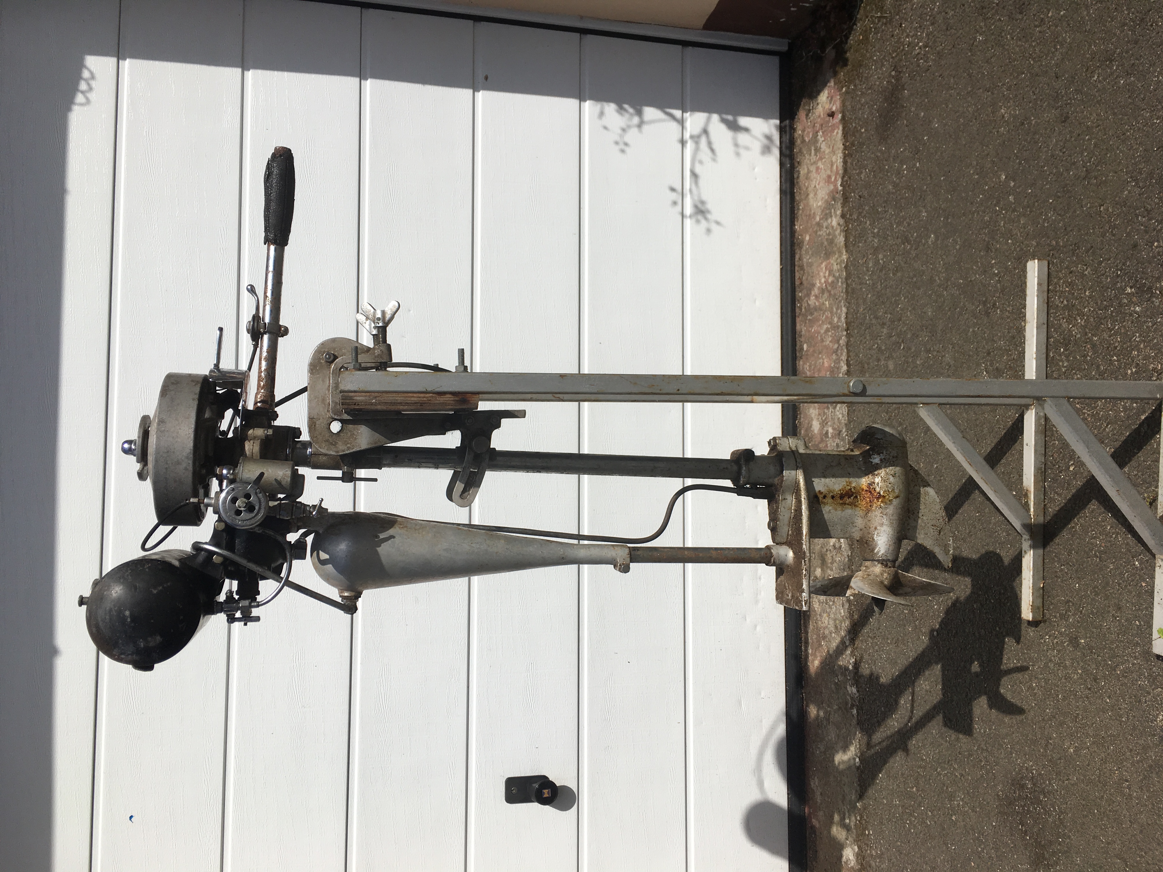

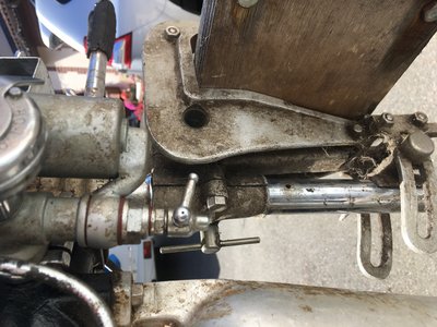

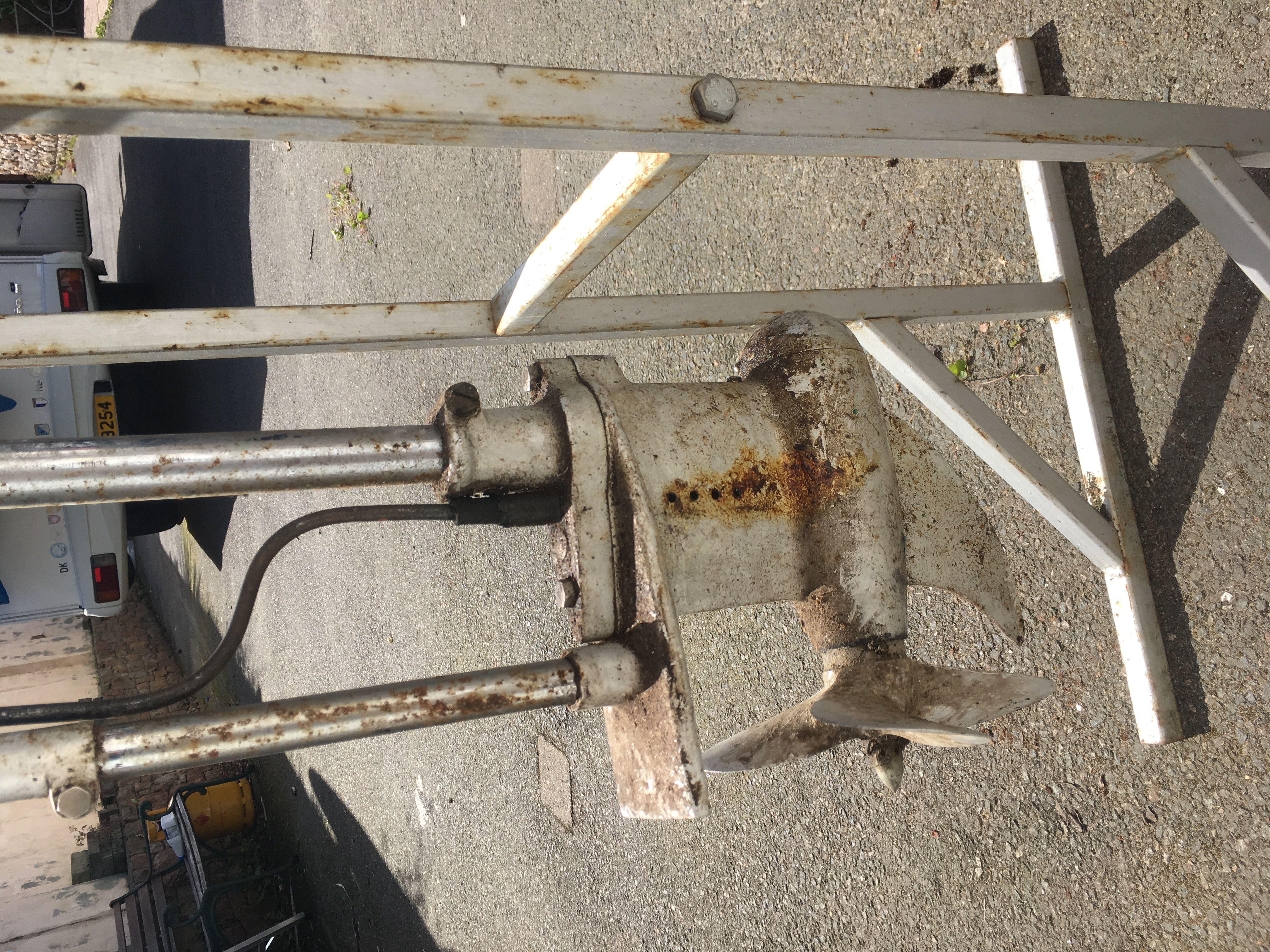

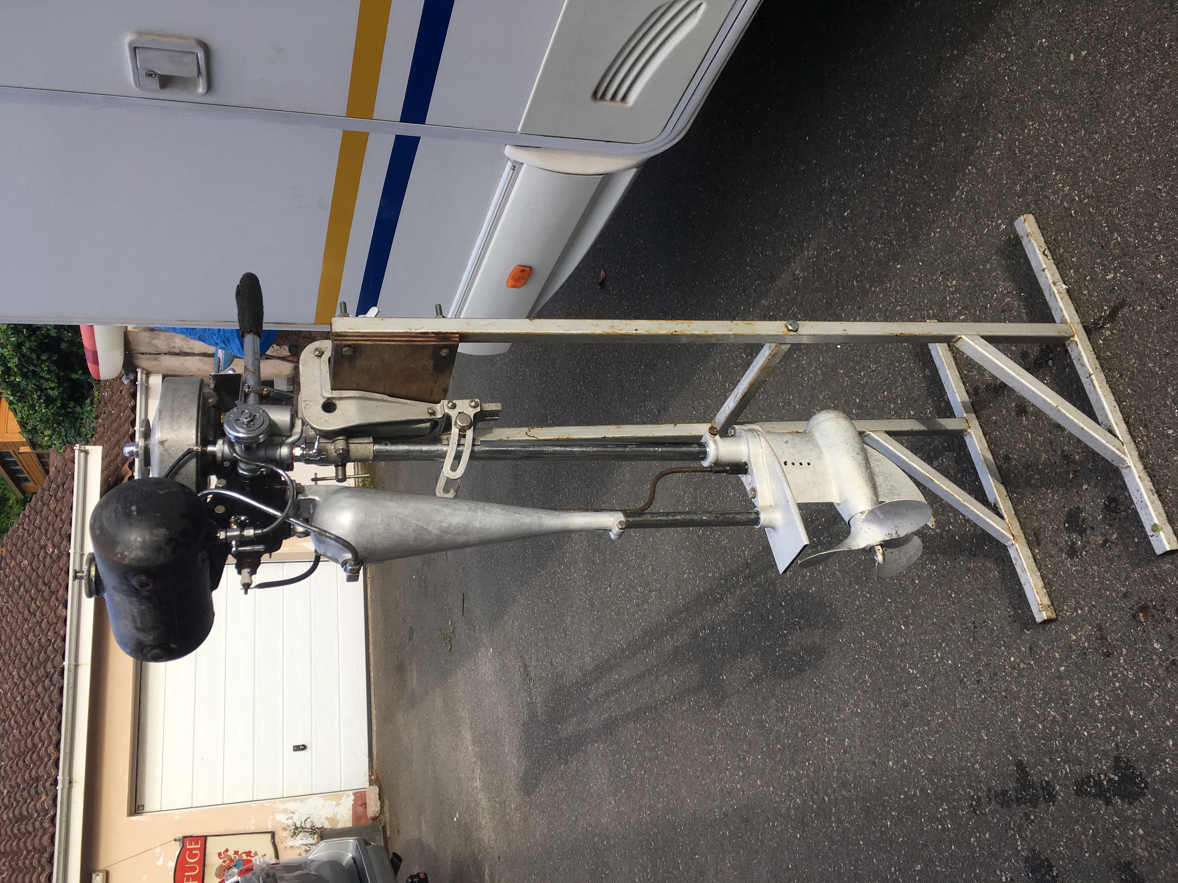

Hi All,
Well I got an email a couple of weeks ago, if I wanted it, a newly found Marston OE was up for grabs so as I was in the UK this weekend I went round and picked it up. Beautiful, totally original, grubby and untouched. A couple of bits missing which I had spare so it’s now complete, from what I can tell every nut, bolt and component is correct apart of the driveshaft pinch bolt it even appears to have the original tiller grip albeit perished. Judging by the JM number it’s a long shaft 1934-ish model. Once home it cleaned up really well.
The Marston OE is quite a rare beast, it’s a hybrid using an OA top end matched to an OF FNR gearbox with a three bladed prop but without the neutral or reverse gears fitted making it fixed. The motor was classed “High Duty” not many were made hence not many have survived

Nice, a general clean up has done it proud 8) Does it run?
JERSEYMAN
Posts: 665
Joined: Sun Jul 31, 2011 2:47 pm
Location: Jersey, Channel Islands
Re: New Baby
Post by JERSEYMAN »
Not running at the moment, it was missing a barrel the only one I had spare has damage to the skirt, a fairly easy repair, I just need to put some time aside, probably needs a coil but the rest feels good, it seems to have had an easy life, gearbox is smooth and no play in the top crankcase bearing, it doesn’t appear to have been apart, no marks on nuts, no prise or hammer marks anywhere so I’m just going to get it running and keep it in it’s original clothes, maybe re-chrome a couple of bits, another one for the hallway....
