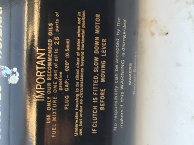

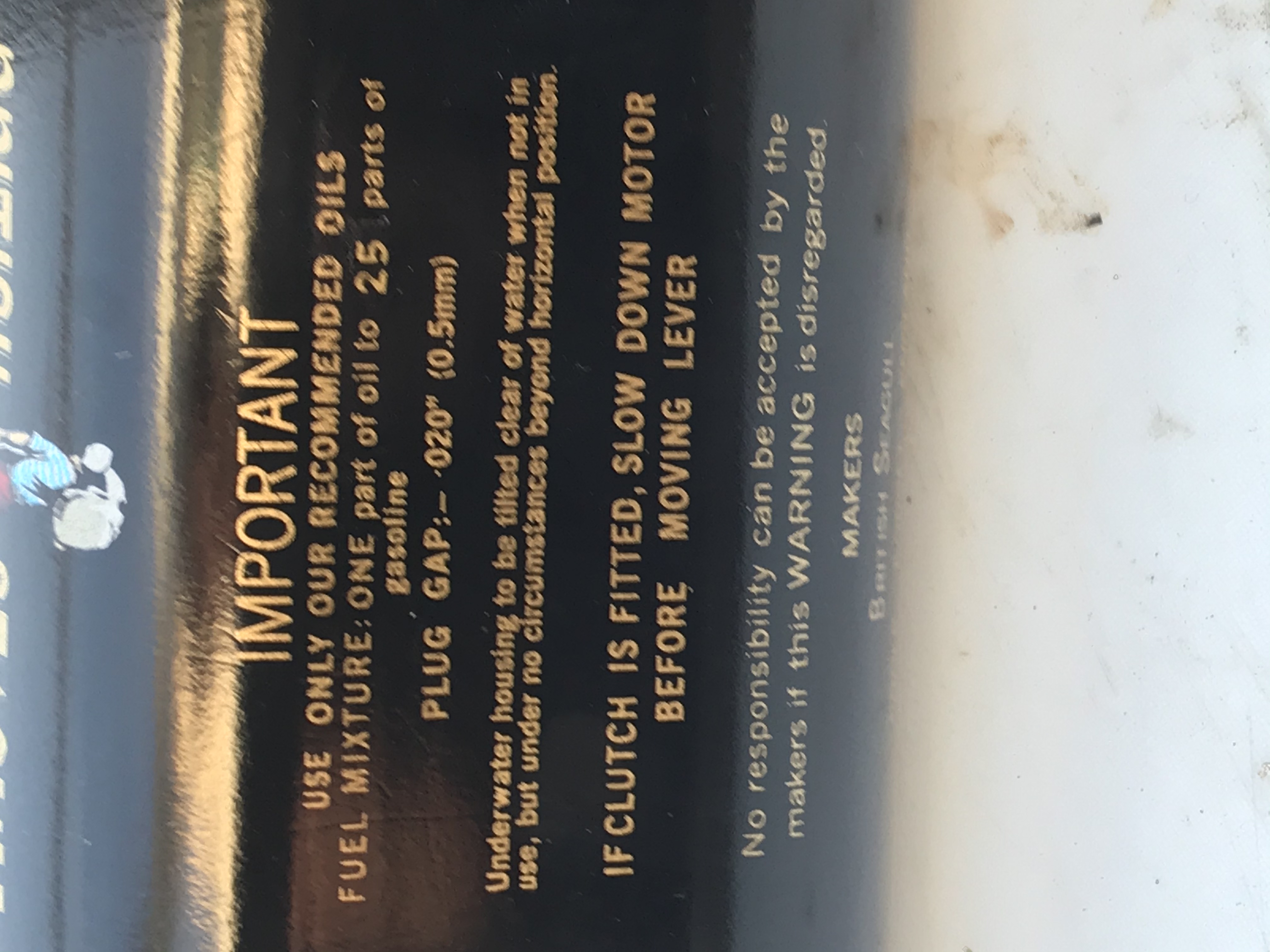

Thought I would post what I did for anyone who’s interested....
I cheated - it became obvious fairly early on that it would require a huge amount of time and effort to find out about the sort of printing that would match the rest of the decal - not worth it
So I bought a pack of black cartridge paper I think it’s called - a little thinner than a corn flakes packet- from w h smiths (a high street stationers in the U.K.) and also a gold fine tipped felt pen in glitter effect gold. Then cut a minute little square and (after some practice on a spare sheet) eventually got it good enough, free hand.
Am trying to post a photo
Donald

Post by Donald A »
Should have added - pasted it onto the existing decal with a pritt stick then sprayed it with an aerosol transparent cellulose from an auto shop ( as I had previously done to the tank plus decal to increase the gloss )

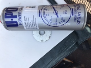

Re: Water decals on fuel tank
Can't remember when you could actually last buy Cellulose freely, has been banned possibly from 2012 I think, unless for pro use.
The rattle can clear coat that you can buy now from "Auto Shops" today will not be cellulose, do a test with modern petrol it can be better at removing paint than the latest safe Nitromors that does not work.
I would go for 2K clearcoat.
I have had good success retouching tank decals but have had major problems with modern paint.

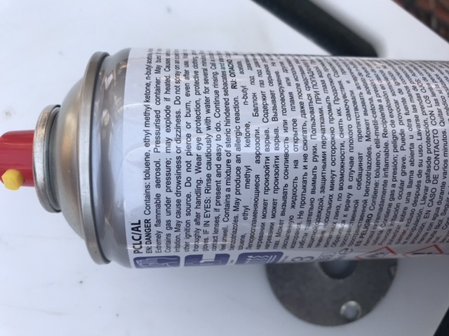

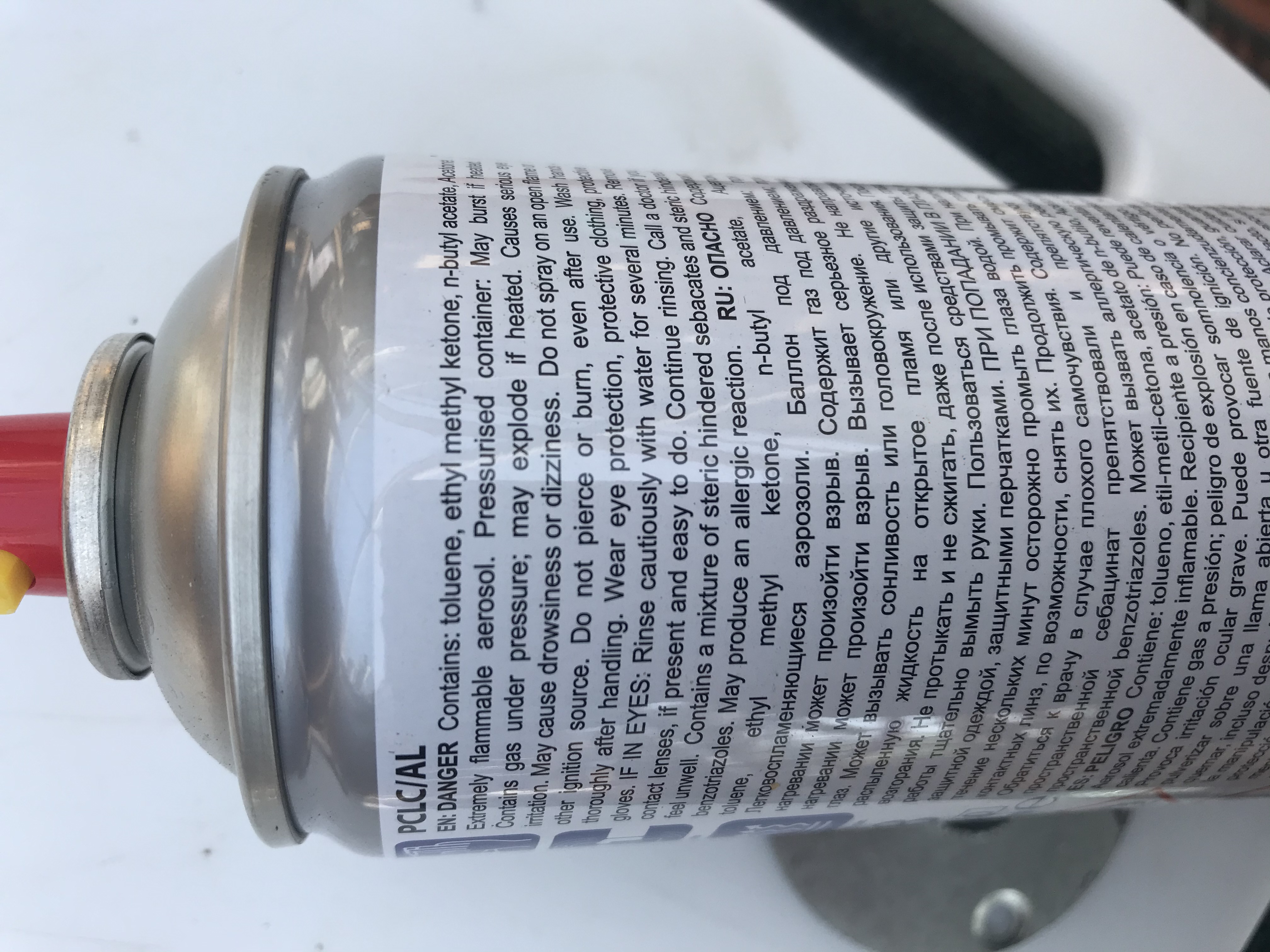

Thank you for that
I attach a photo of what I bought - time will tell whether it works!
Keep safe - why can’t we be more like Germany - rhetorical question......
