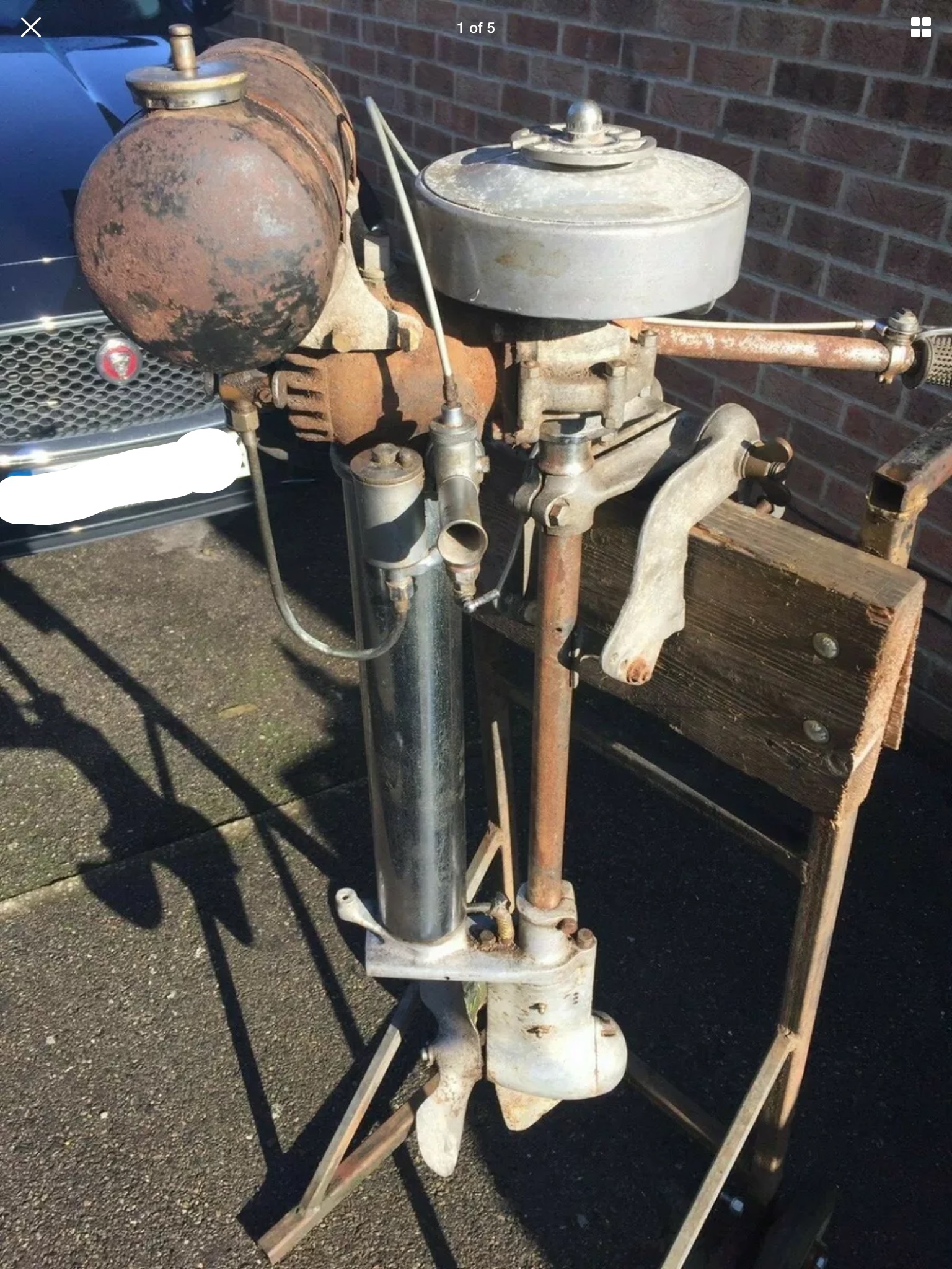

Just spotted this, tidy engine but a incorrect in places..be Interested to see what it fetches.

The one that sold a couple of weeks ago was 90% of an OP, whereas this one is only about 60% without knowing the ignition number.

Missed that one, but this one has a a lot of incorrect bits, hope somebody does not go mad on it..

That’s the one from a couple of weeks ago, looks like a real dusty barn find and pretty complete apart from the tank and tap, it’s amazing how they still pop up.

Its got the wrong cylinder also, and I think its got a SD tiller, looking at the grip. Also lacking the chrome trumpet. Tidy though.

Brass tank, I suspect. And a modern decal. What's going on with those straps? One of them appears to have a cutout?

A fair bit of 102 on this motor methinks - propellor, petrol tank, petrol cap, intake shroud (my SD's had the brass 'trumpet') etc? Crankcase to leg studs look a bit dodgy - too long with no shallow dome on ends (cut down bolts?)
Re: OP463 on ebay
Try fuel tank, fuel cap, petrol tap, fuel tank straps, fuel tank support bracket, fuel tank bracket bolts, carb, air intake, cylinder, throttle lever, tiller arm & propeller.
Without the JM number we can't be sure it's the original ignition & I'd also like to see the drive shaft.
The only parts we can be sure are prewar, are the crankcase, water pump housing & the transom bracket.
What have I missed?
Re: OP463 on ebay
Ht lead and spark plug cap :twisted:
Re: OP463 on ebay
OOOPS!
British Seagull on the plug cap rather gives the game away, can't see the baseplate fitting/connector as they were different.

Its in the public domain and at a high price. Why cant we discuss it? We are not ripping it to bits, just highlighting what is right and wrong.

Quite right Oyster - I prefer to think that the people on the selling side are acting in all innocence (?), but potential buyers (at high value) should be aware that all is not as it seems.

Yes, It’s known that this forum is used as a reference point sometimes, so in my view promoting “correctness” is the right thing to do. Particularly on these more rare engines.
