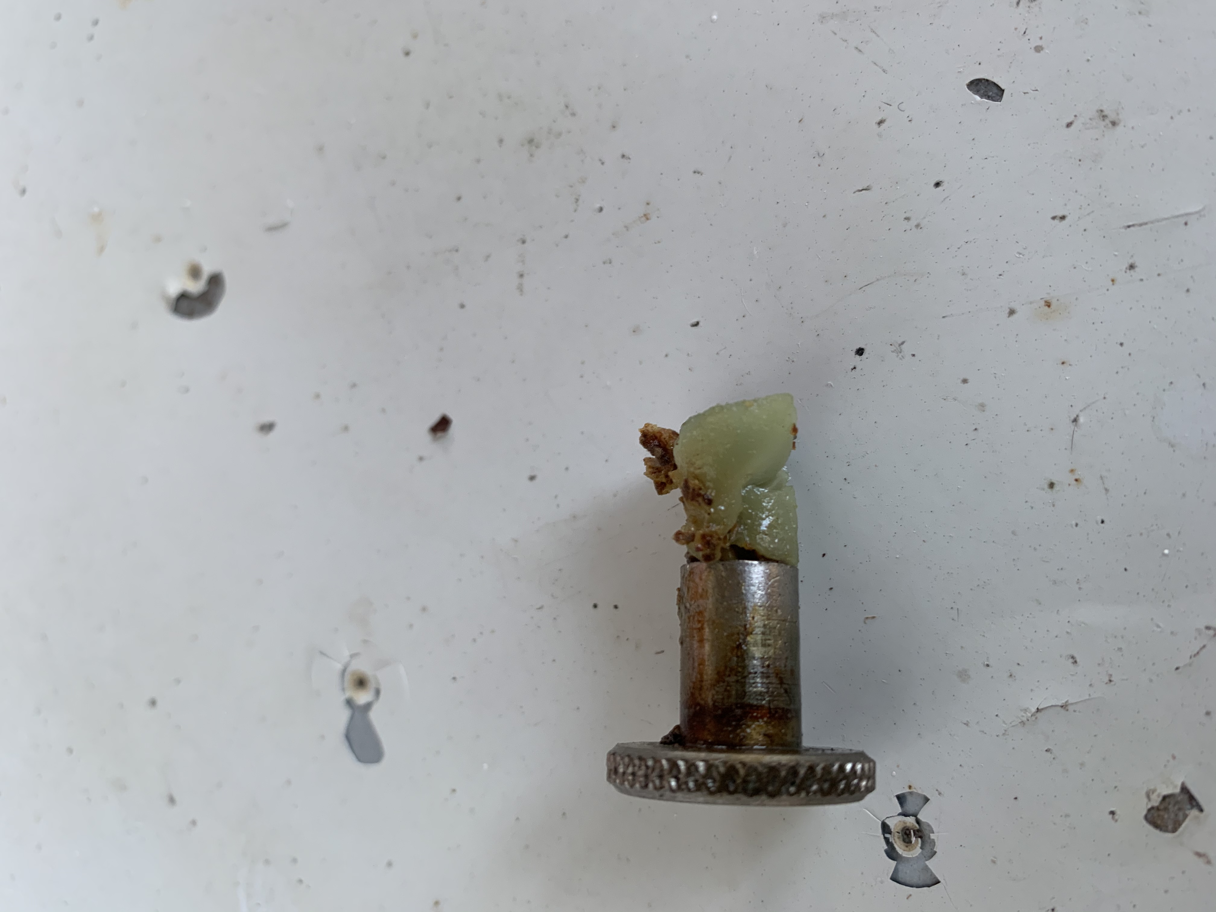

Back to the dock for a check and found two surprises. Firstly the fuel cork was not a cork at all, but perhaps some type of decomposed silicone. Like thick jelly, probably decomposed by fuel over the years, I always wonder who makes these sorts of repairs! I had fully stripped this motor last year and I always check the taps, so I must have simply put back on the wrong tap. Easy fix with a new cork but thought the forum may like to see another failed fix.

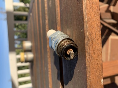

So onto my question. I’m sure this has been covered plenty, but the search feature is a bit tricky on the forum. Below is a pic of the spark plug, which was a new champion d16 properly gapped and run for about 90 minutes. Can anyone give feedback on the plug condition or point me to a thread that can?

Plug looks good to me! Nice colour

Re: Spark plug diagnostic / sea trials
With you saying the engine was 'running cool' that would explain the slight oil residue on the threads and barrel of the Plug. The actual combustion zone colour at the tip seems to be more or less perfect. I wouldn't stress about it.
