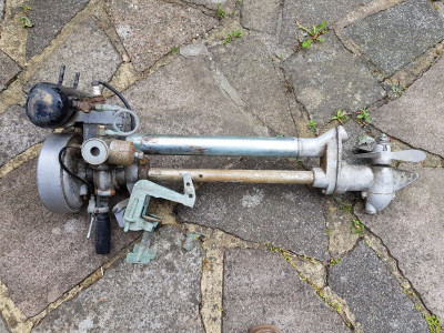

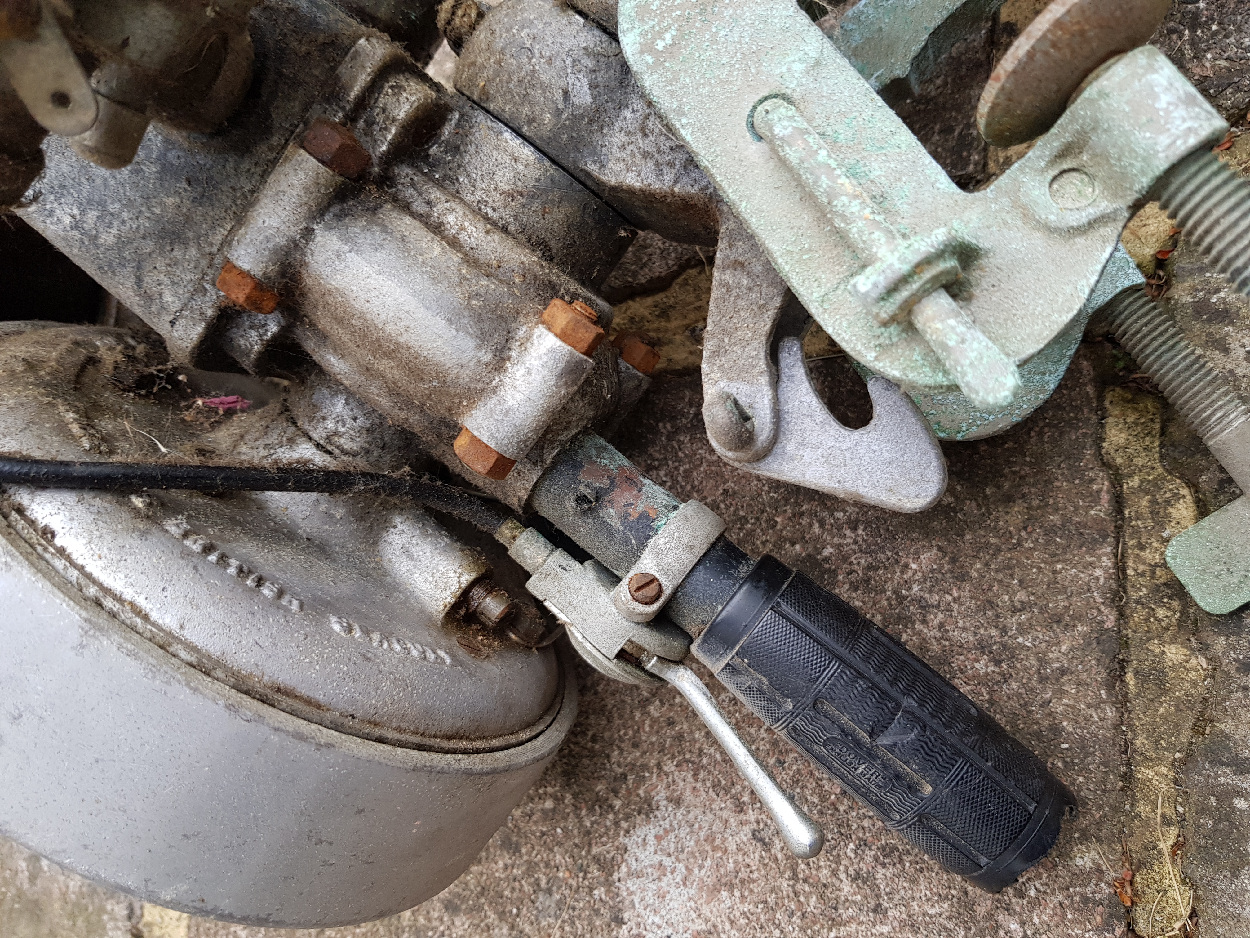

Hi Jeremy hope you are well. Sorry to say it is still in the corner of the shed, I have soaked it in WD 40 to try to loosen it up, have been dealing with clearing my late Father workshops and trying to sell his steamboat, so have had little time recently.Gannet wrote: Wed Jan 13, 2021 9:39 am
3. Allan - what progress with FV1146? I hope it is up and running. It would be lovely to have such an early FV running again. As you wrote FV1146 would appear to be the oldest known one stamped FV. However VF1065 is in existence and there is apparently no difference in the build of VF or FV. Indeed the Seagulls list indicates that VF or FV was the same. It might have been that the availability of Villiers or Amal carbs was the deciding issue as to when and how they were stamped.
Have still also got an OA and an ON in bits which need looking at, can not move in shed at the moment.

It's nice to see photographs of FV1146 (I do have the number correct - it's not 1148 is it?). Although it's a very small matter, it is lovely to see an original type transom bracket locking pin with the squashed end. Ones that I have seen have been nickel plated brass.

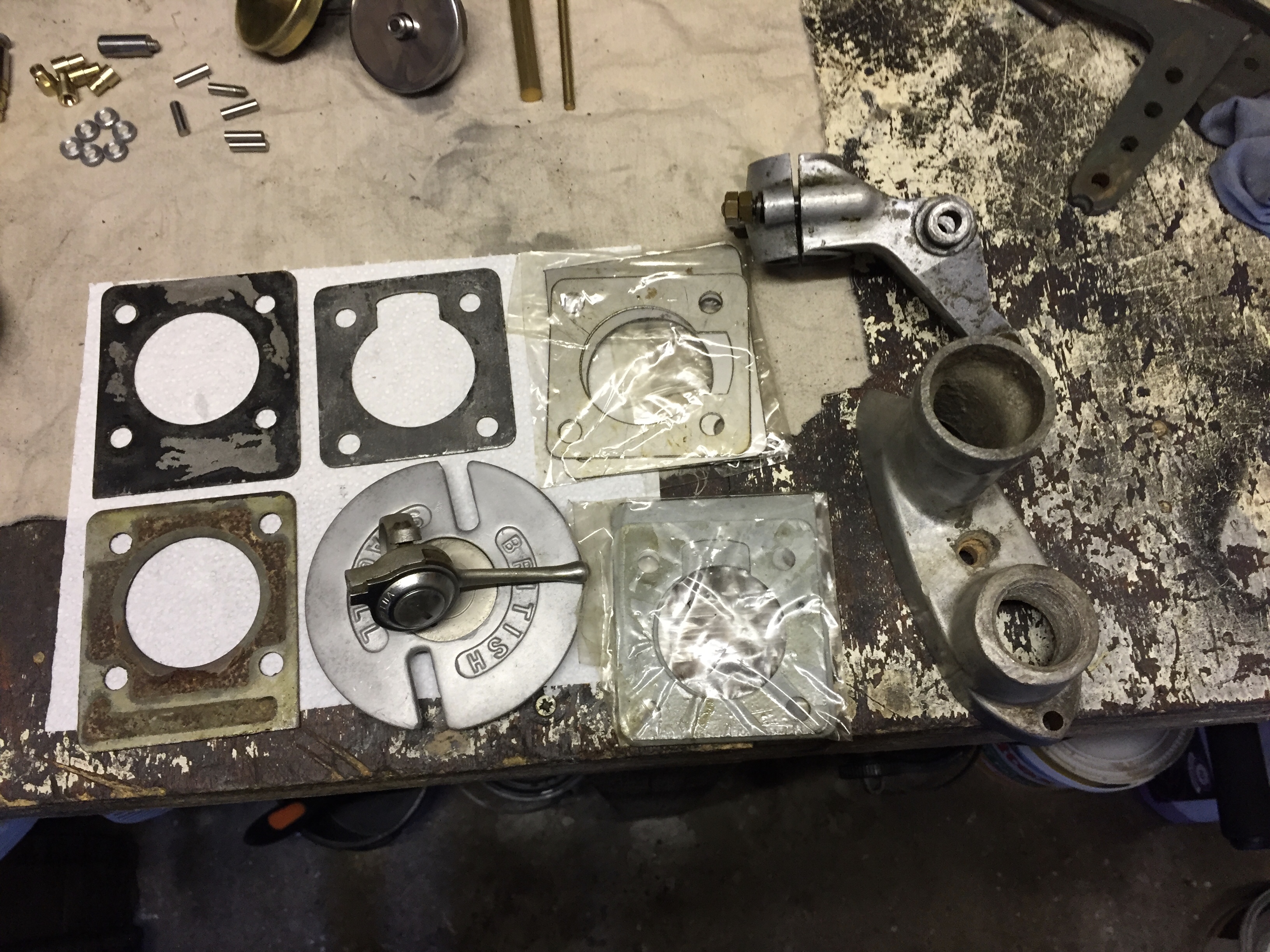

Adrian/Jeremy I had some new steel gaskets made for the FV's, do you want me to have a look to see if I have any left?
I also had some FV bobbin style thrust blocks made.

These are the FV/FVP parts I currently have, all are surplus to my needs currently. Happy to pass them on.

By the way, were your 'gasket' plates galvanised or zinc plated? I suspect from the evidence that I have seen, that the original plates had a surface of zinc. Technically, a very sound idea.
