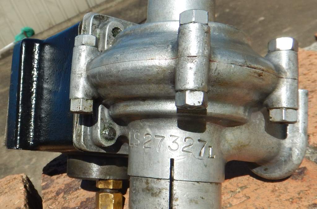

Thanks guys - yeah, sorry, my mistake. Its a bit like blindfolding you then asking you about my engine.
Here are some photos.
Someone has obviously been at it, because I don't think its a Long Shaft any more.

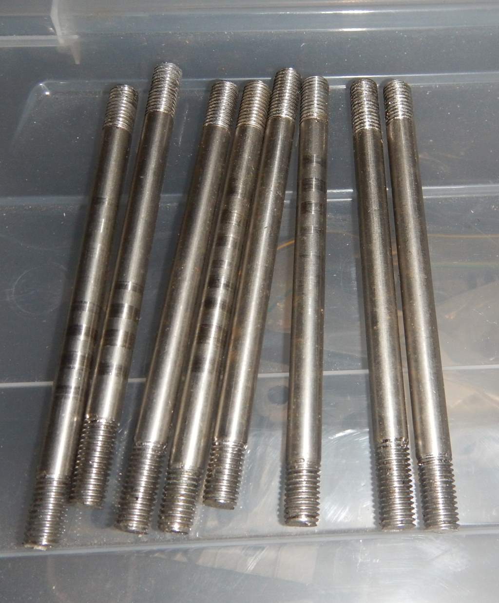

The steel studs were a mess, as you can imagine living in all that crap for decades. I like to reuse whatever I can, I like the thought of keeping things as they were from the factory, but the the steel studs were beyond salvation, they were so deeply corroded, I had no confidence they would hold up under the tension of being torqued down. And even if they did, they would have given out before too long.
So I went crazy on a lathe.....

Nice job 8)
