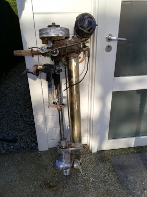

Hello, last week I bought these 2 British Seagulls here in Belgium. Their SN are: SD1389P3 and THCL479D4. They stood in a shed for years. Yesterday I started cleaning up the SD-model. Are there things to pay attention to ? Greeting, Alain.

Welcome aboard Alain.
Well done in getting these as both are very worthy indeed.
First thing is use the search function and importantly...DO NOT use power tools.
Gently gently by hand...
Especially very aged Gulls.
You will be fine.
Keep posting your endeavour aye.

Look like great motors, good find.
Do you want to get them running again? Or just cleaned up?

Hello, THNX for your reactions ! First I will clean them gently and then I hope to get them running again !

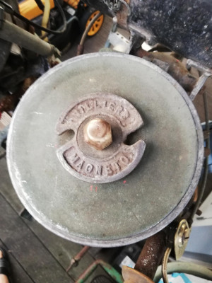

Hello, after removing the bronze flywheel nut, shouldn’t the flat cover simply come loose ? Here it remains very stuck to the flywheel as if sealed … Many thanks for tips. Gtz, Alain.

Yes the stator pulley plate (piece that a rope wraps around) and the flywheel cover plate should come off after removing the main nut. They’re often stuck on with crust on older motors like yours.
Stator pulley plate should come off easily enough and is a sturdy piece. But the flat cover plate below is thin and prone to damage; recommend removing gently.
Some penetrating oil and a few gentle taps around the rim might free it up.

THNX Andrew ! Asap I will give it a try !! Grz.
