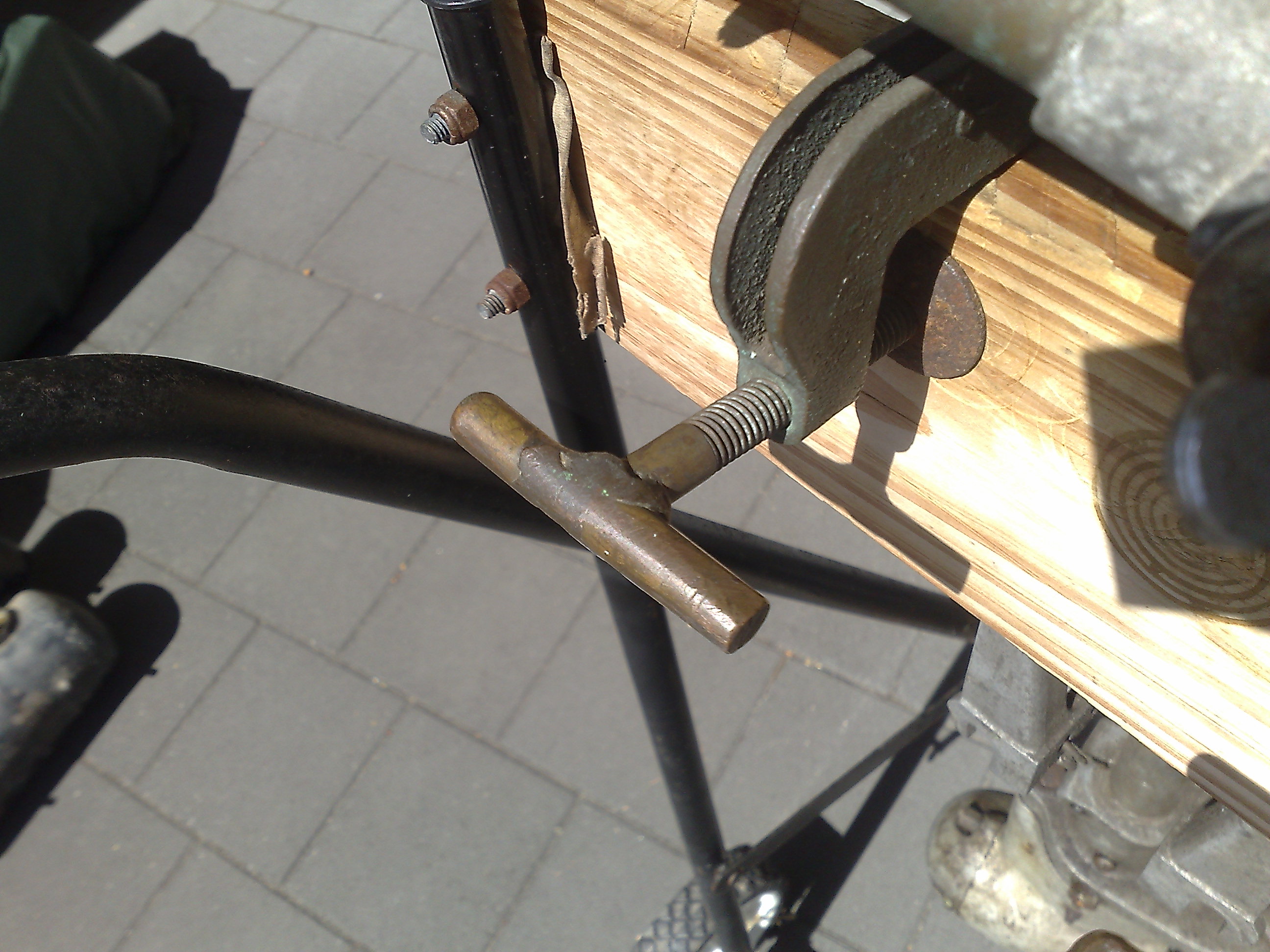

Hi Andrew
The two screws are not standard. The top screw should be lubrication nipple and the bottom screw should not be there at all.
There was excess cooling under most conditions so the hole is a water pump relief.
See below...
Yes there is a cover on the carb
I have other barrels. I will adapt one for the plugs and should be ok.
Notice the thumb screws?
