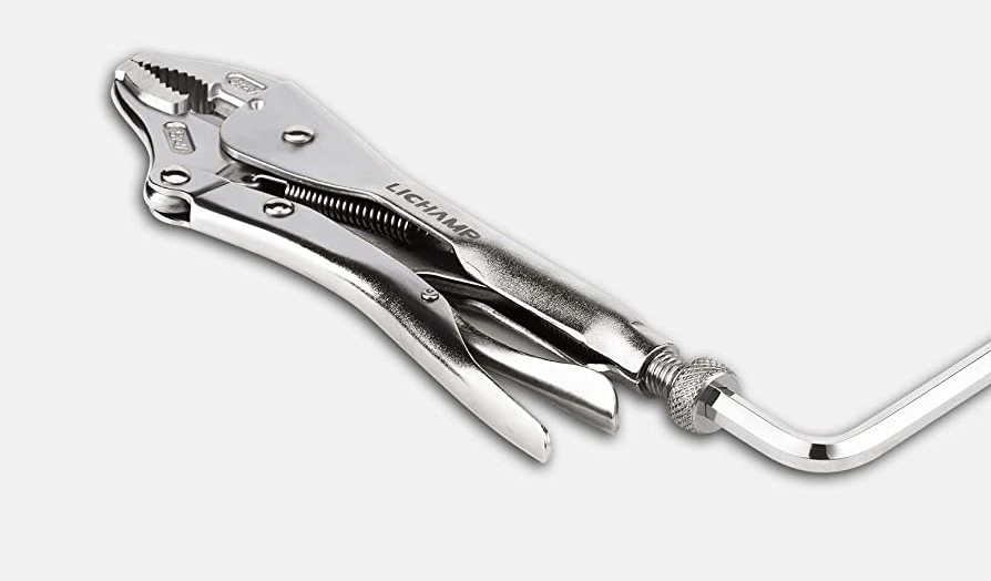

Hi, Heat is certainly a game changer lol, managed the spark plug with heat and Mole Grips, saw a video the other day about using an Allen key to tighten the adjusting screw, worked a treat, got the gearbox opened up an got rid of the creamy sludge, still strugling with the screw keeping the gearbox attached, even got the throttle cable working. Once again thanks for the help. Jim

Creamy sludge is probably correct. The oil is designed to emulsify with ingressed water. I describe it the colour as baileys irish cream. What is this allen key trick?
Re: Rusty spark plug removal
Some of the newer grips have Allan key fitting in the end of the tightening bolt. Definitely useful in loosening the grips when they are clamped tight.
Ahh. Just checked mine... no allen key fitting. Can't say l have ever had trouble opening my vice (as they are known down here ) grips. Interesting. You tighten your grip as well.
None of my grips have the Allan key socket either, but I’ve seen them in the stores and thought the extra feature wouldn’t hurt the next time I need a new pair.
I’ve had a couple experiences where the grips are clamped so tight I end up using a second pair of grips, pliers or even hammer to compress the release lever! Then they inevitably spring off in the wrong direction
