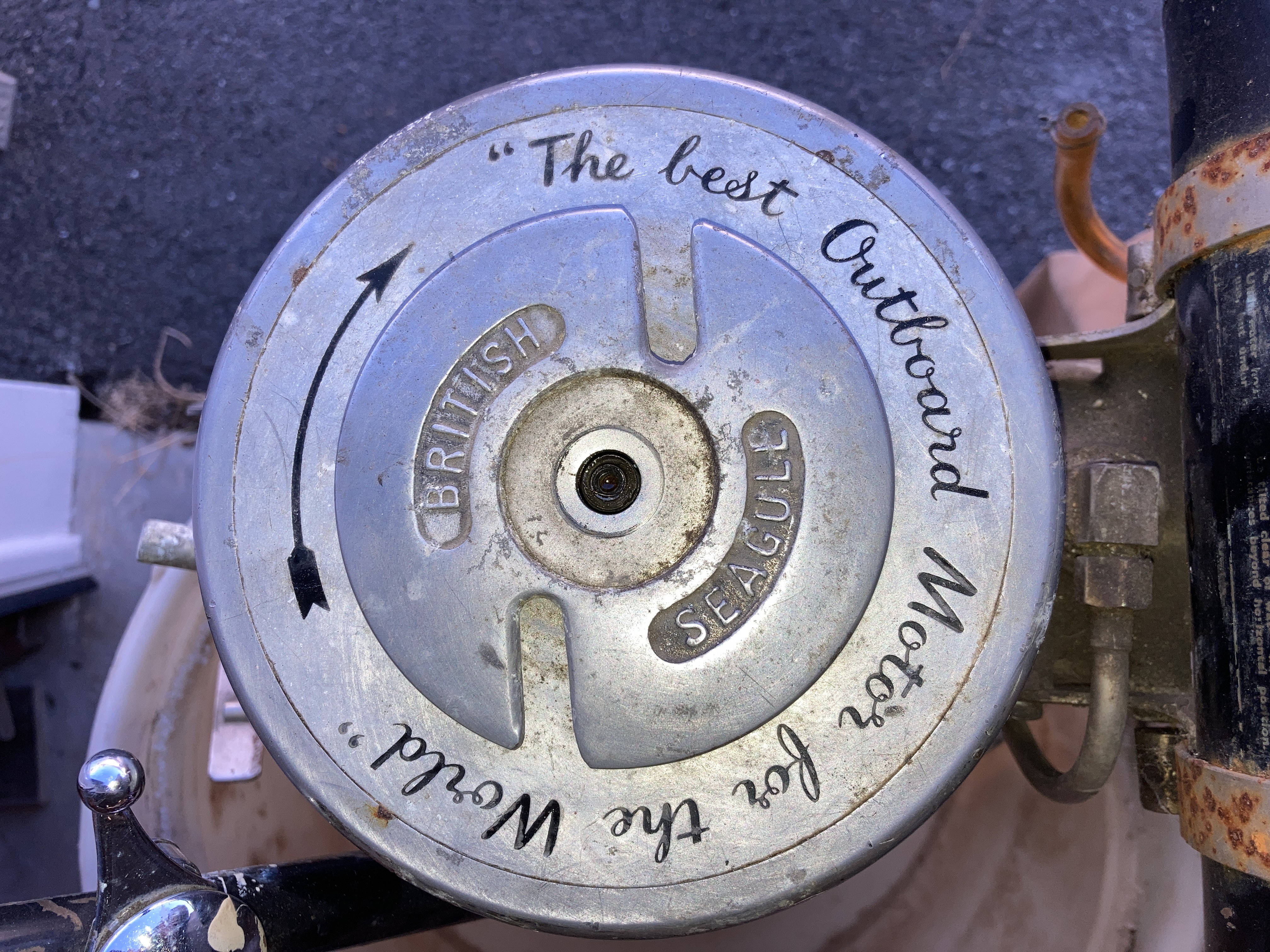

i have a Seagull 102 (manufactured ~ 1958-59, Silver flywheel, Serial number: TC62513) which came with the wrong carburetor. I don’t
have 102 parts manual and I need to get the right carb, cable & fittings, and washer that goes under the dome nut. My original Villiers coil is toast and I am trying to replace the whole ignition system with a newer style if possible.
1) Can any one tell me what the parts number and/ descriptions for the correct carb, cable, and washer? I am trying to source those parts now. I will be ordering a parts list from John shortly but I would like to get started now.
2) I have a copy of the BS 59 page service manual which consists of many service sheets, one of which depicts the SEAGULL-AMAL TWO-JET CARBURETOR. Might this be the correct carb?

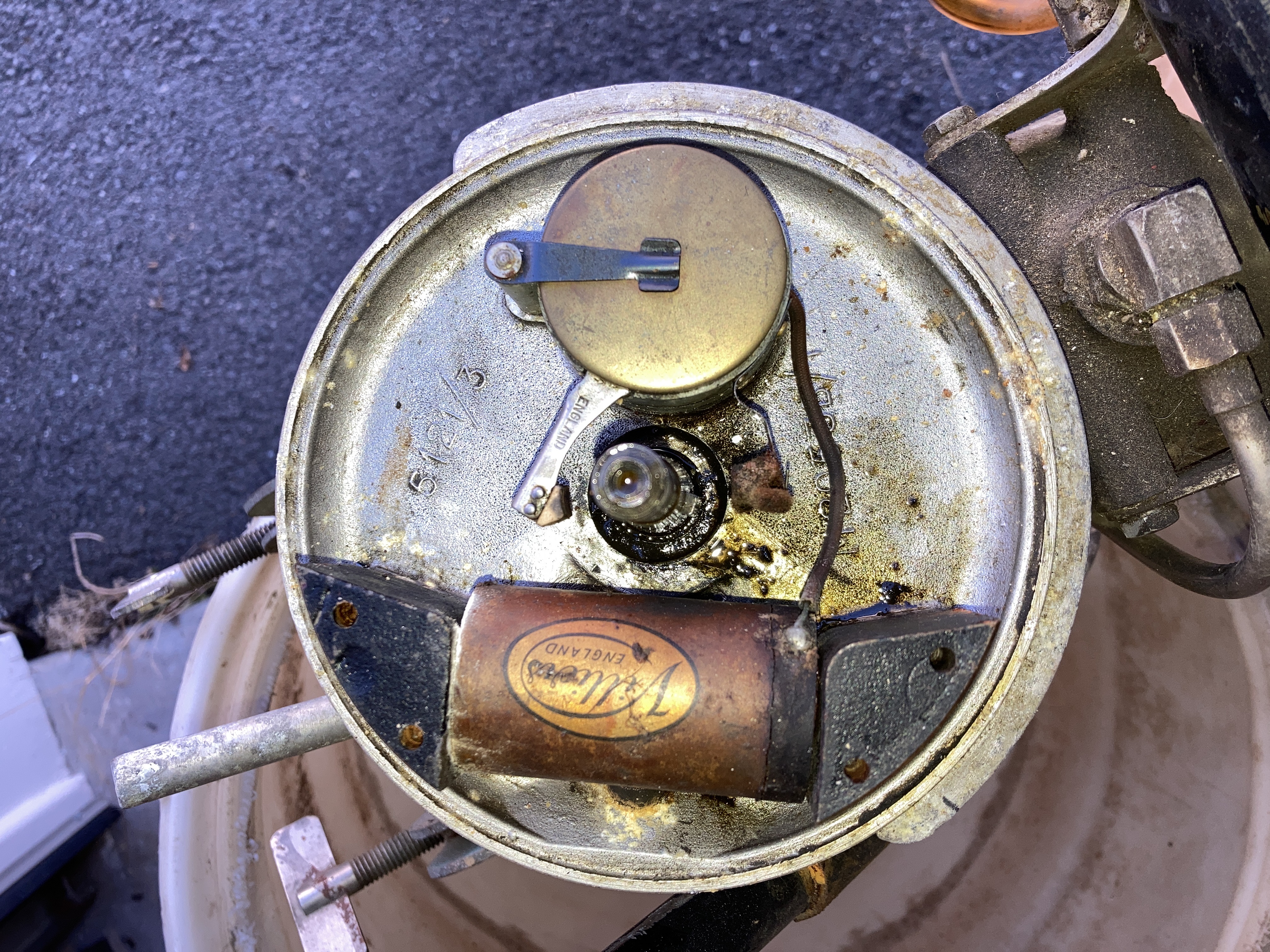

3) That same service manual has a description and parts diagram of the MARK I (VILLIERS) IGNITION ASSEMBLY which looks like mine. Would this be correct?
4) Was there a service manual specific to the 102?

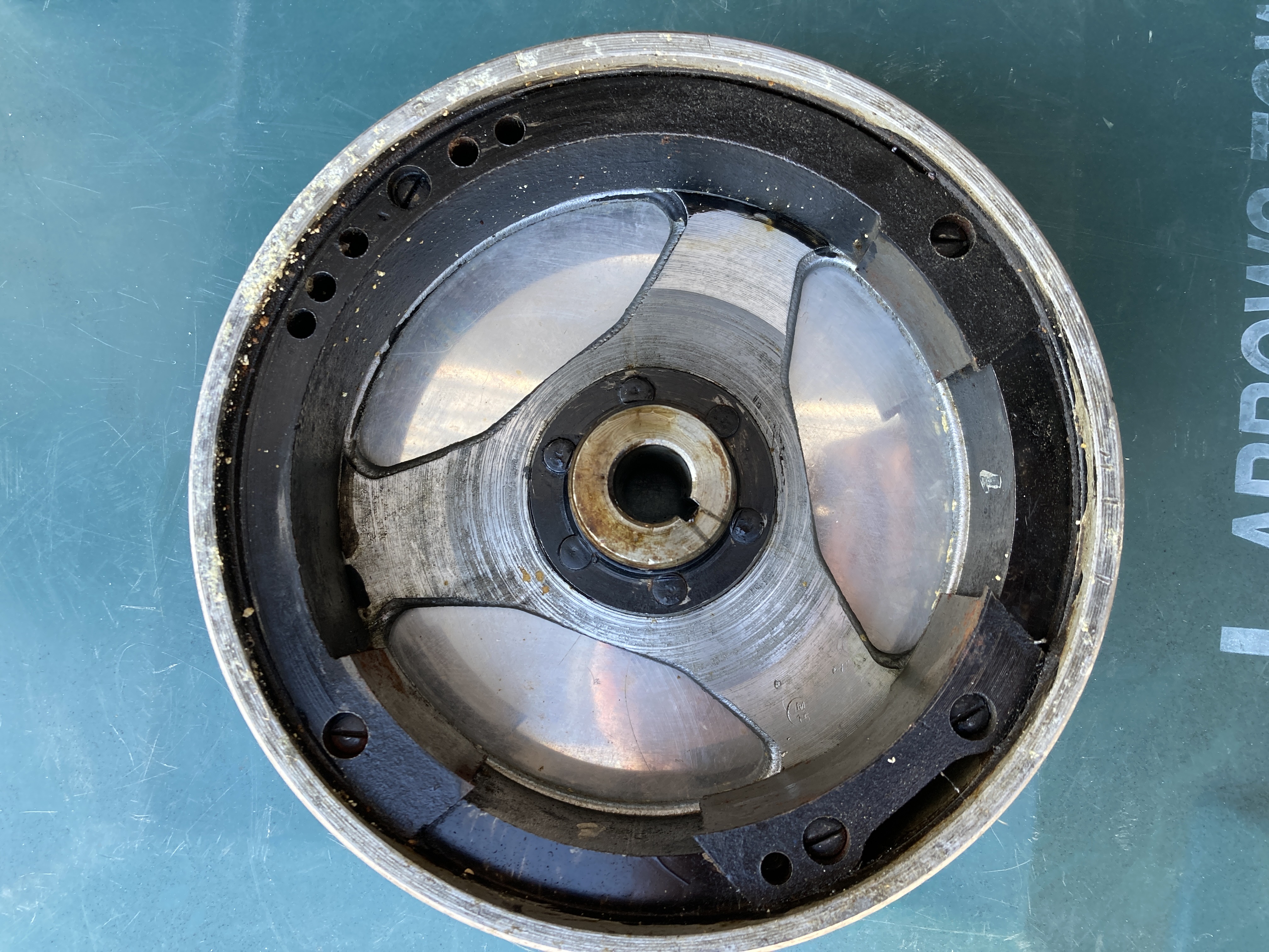

Here is what it looks like. What is the best way to safely remove some corrosion found on the magneto base plat and the flywheel?

Yes the ignition is a Villiers Mark 1 (MK1).
