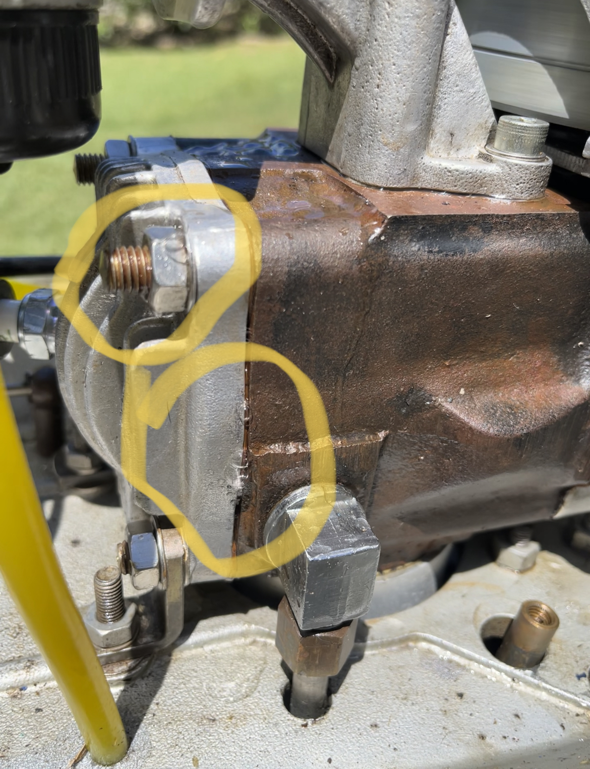

First time starting this one after a full rebuild a couple years ago. Replaced piston & rod (remembering the wire https://www.saving-old-seagulls.co.uk/p ... tem#p63459). New gaskets/hoses/etc top to bottom.
30 mins of pulling the starter, occasional misfire/backfire, tinkering with one thing or another before I realize the cylinder head nuts are only hand tight. Started easily on the first pull once tightened up. Idles perfectly, pumps plenty of water at idle. One of the quieter seagulls I’ve heard, even with cowling off.
But — it definitely needs some work sealing the head! You can see bubbles in several spots around the cylinder head and even coming out the studs.
This one had a fair amount of rust I had to remove in the cylinder waterways, so the mating area between cylinder and head is reduced. The cylinder is near the limit of what I think should be good enough to run reliably, and will need to be replaced at some point for sure. For now my goal is to get it running to use a few times this summer.
I’ve not seen a head leak water like this before. It doesn’t seem to impact how the motor runs, though given it is a 170 I didn’t rev it up in the bin. I’m hoping it’s just a poor seal on the outside edge of cylinder and head, which can be fixed by a slightly larger gasket or maybe some liquid gasket seal.
Any thoughts out there on what to look out for in this type of situation? I’ll grab a couple photos when head is off.

Bubbles would imply compression leakage, are you home or away, if in BM show it to Brian Lightbourne he certainly knows all about 170 powerheads & buy yourself a tube of RTV Silicon gue.

Where are you Andrew? BM?
If your in BM go down to Spanish Point boat club on the early afternoon of the 18th as it's the RISR, take the disassembled motor with you
Can you post a picture of the clean top face of the cylinder & head so we can access the surface condition.

Took the head off today, but forgot to take a photo while it was off.
Outer edge is down to 2mm in a couple places on the mating surface, but enough to get a bead of RTP on it all around.
Inner surface around the sleeve in better condition, and didn’t see any carbon markings etc leaking out from the piston so think that part is OK.
Will give it a run and see. I’ll get a compression reading as well.

That isn't the way you use RTV, a very thin wipe around the the surface of the inner ring of the head (the fold over portion) gasket, both faces, & the same on the outer 3mm strip to prevent any water loss.
If it's squeezing out you've used too much & the excess could come loose & block the tell tale or the cooling flow around the inner exhaust!
Re: 170 rebuild first start - wet!
Agree with your recommend application in almost all cases. Absolutely the right advice. However it's a live or die situation for this cylinder
Discovered some pitting on outer edge mating surface = extra RTV or the trash bin are my options in the near term. Until I find a new one this is what I have to work with, on a novelty motor that will realistically not get more than a couple hours' use.
RTV applied to the last ~1mm of the outer edge only, ensuring that excess would mostly squeeze out not in. Excess not wiped away as I think it's probably not hurting and I don't care to hide the quality of the cylinder/situation here. Inside I didn't need to apply any, the copper gasket is doing it's job fine there.
I doubt there is much if any RTV in the water passages given how it was applied to the very outer rim only. But, of course that's a possibility yet I'd rather have that issue while driving on the water, than to stay on land and not. A matter of priorities I guess! This motor will not be going far from shore in this condition.
Still looking for a 'new' cylinder as a proper long-term solution if anyone on the forum has one to sell.

How much piston @ TDC to cylinder head clearance do you have?
Not measured. Are you thinking that shaving it down a tad could improve the mating?

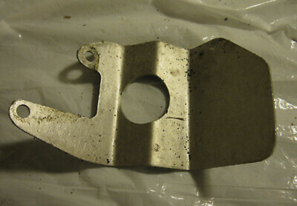

Also, any idea what this Carburettor Shield does? It it a heat shield?
- Posts: 4955
Re: 170 rebuild first start - wet! (Update: now dry)
It's there to prevent fuel drips from the carb landing on the hot head & sparkplug, catch on fire & not be seen as it's under the cover.
