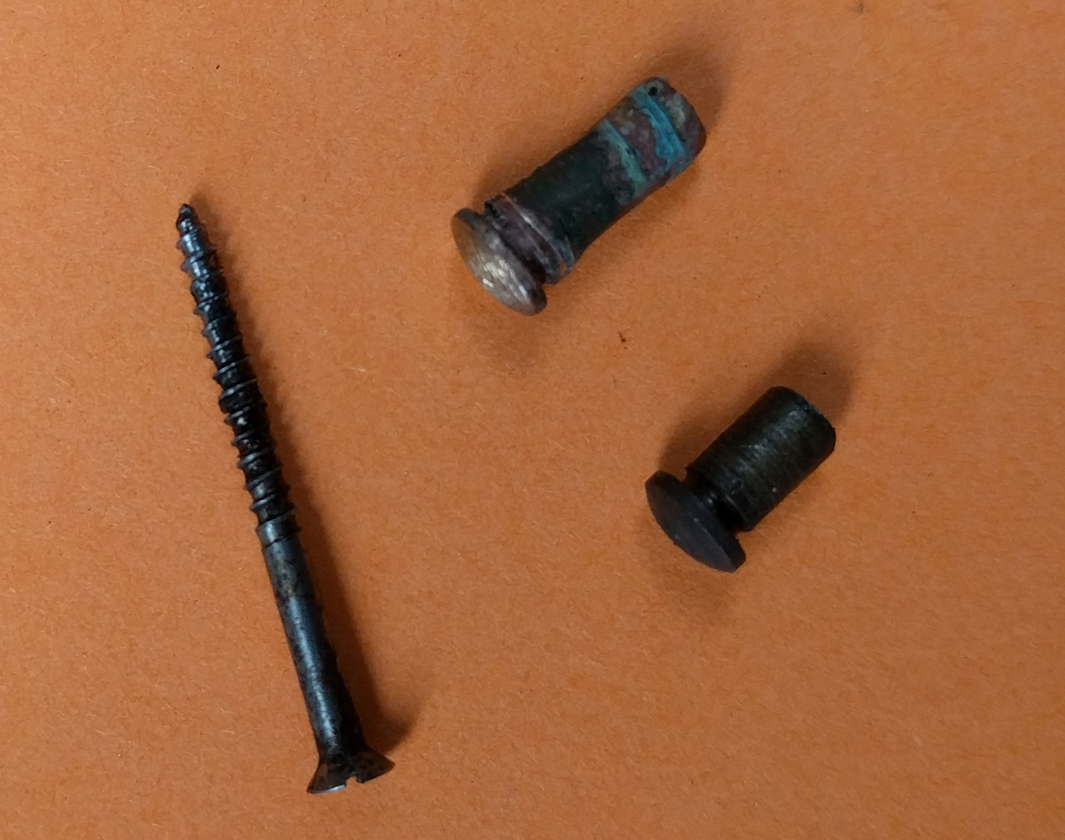

The inch screw in the HT lead that I dissembled was made of steel, not bronze, (I tested it with a magnet), so maybe BS changed the spec at some time. I Noticed a couple of other changes between the 1950 and 70ish leads. The groove in the back of the Magneto HT connector went from one groove to two and the brass contact changed in length.

Had one of my leads apart this morning the wood screw is #1 x 3/4" brass flat head.
#1 gauge is 5/64" diamante (2mm) (Sorry that should have read Diameter) had a look through my screws and I do have some but not as long as original. This time original screw was fine so I put it back in and straitened out the spring.

Yes - several I have taken out were steel - some brass ( or bronze ) You say thats a no 1 gauge x 3/4 - they are 5/64 shank. What does the 'diamante' bit mean - no 1 fine ? Not heard that term before re-screws ?
edit - after MUCH searching -
Brass csk slot head M2 x 20mm - Cromwell tools - Bristol. Cannot find an Imperial no 1 or 2 brass @ 3/4 anywhere.
( tech data M2 brass csk wood screw Din97 - is head - max 3.8mm - shank 1.9mm )
