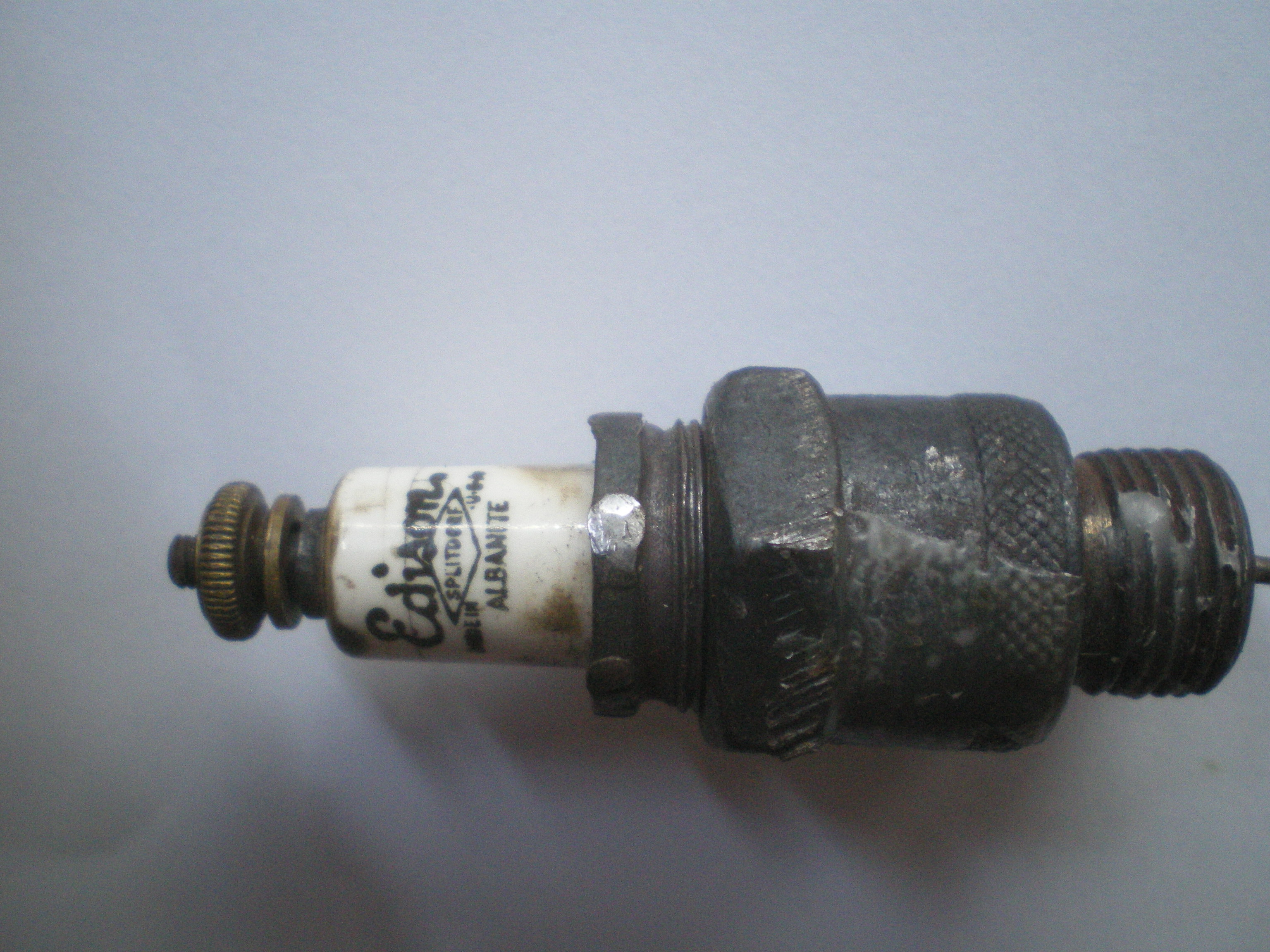

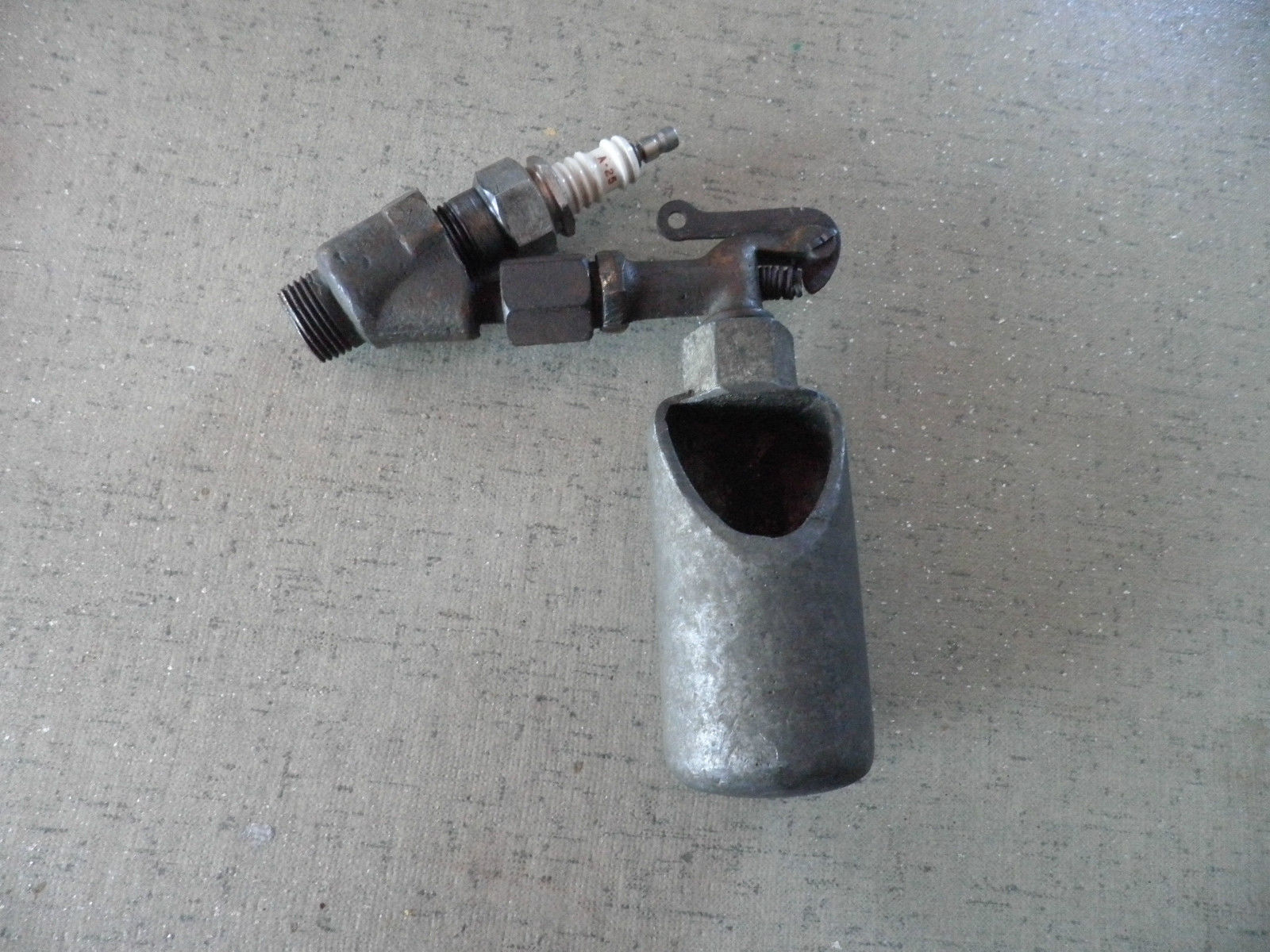

Re: Success rate in freeing seized motors
Ok, use this. http://www.ebay.co.uk/itm/Spark-Plug-Th ... xygLxSZoeS
Yes, we all have the odd old spark plug.
