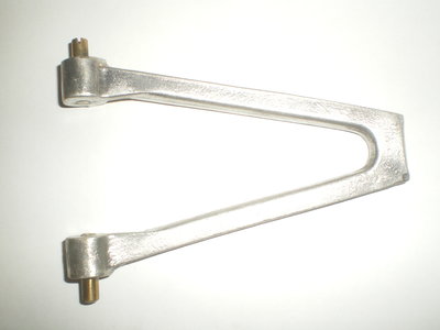

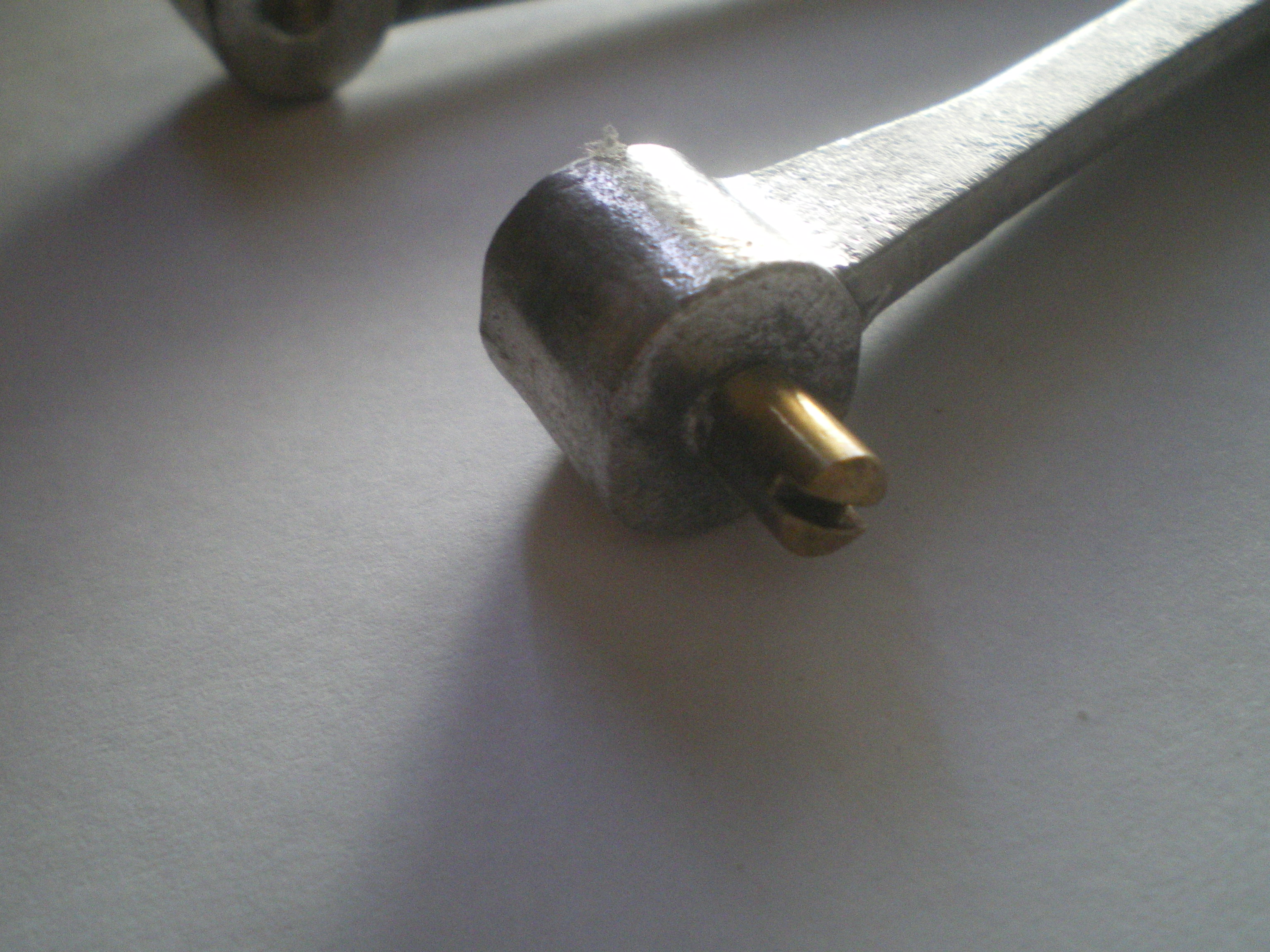

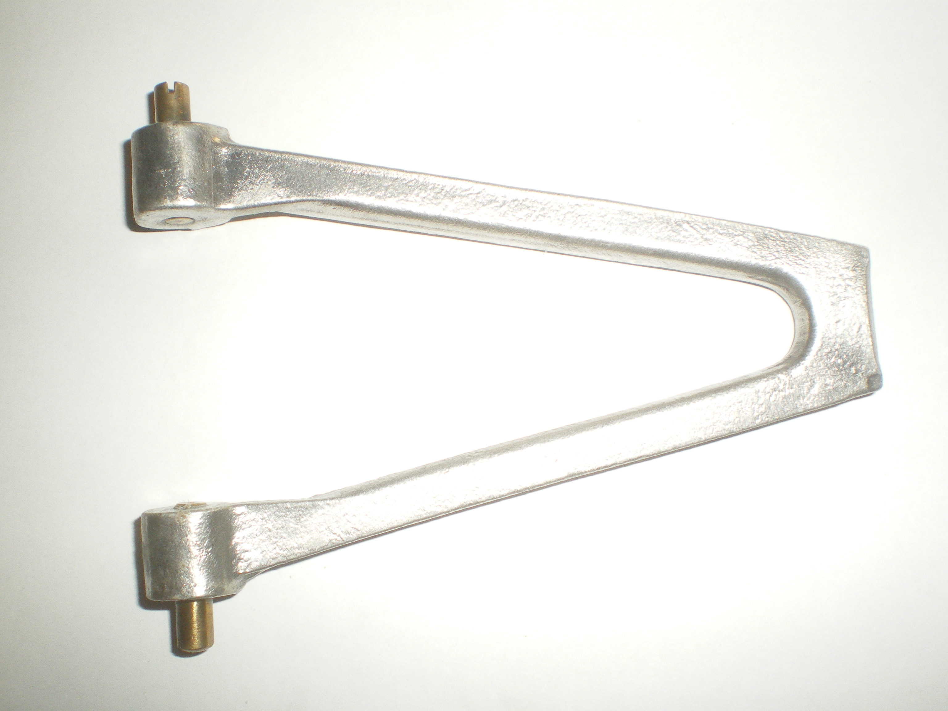

Managed to put together a decent transom bracket albeit that it still has a few non-original parts. From what I understand the tilt pin should be bronze, the drive shaft clamp should have studs (not bolts), and the tilt stay bolt I'm unsure about.
Not sure what I'm going to do about the drive and exhaust tubes just yet. In terms of plating, both are in poor condition. In the meantime, I've done a pre-assembly of the power head. Although the flywheel is dated correctly, I believe the ignition plate is not period correct. If I'm not mistaken it should be the rimmed version. The one currently fitted is rimless.
It seems to me that there aren't all that many Seagull outboards in Australia that are factory original with regards to components. This leads me to think many were assembled from parts shipped to Australia ie rather than complete outboards, and/or that changes were made by individuals during servicing or breakdown repair.

If your Seagull has a full engine number on the crankcase, it left the factory fully assembled, after it passed the test tank it was removed from the tank, cleaned, then given a serial number from the build book which was then stamped on the crankcase.
Though in Australia there is the Olympic which has some Seagull components as did the Montessa in Spain & there was talk of something similar in South America, giving support to the theory that quantities of components escaped into the free world.
It would be interesting to know what Olympic bits came from Seagull & whether they would still be useable on a Seagull.
Re: AD16381
I would have thought that the ignition would have been rimless, its a early 50's motor.
That seems to be a heavy duty bolt on the transom, like the bolts on the clamp that should be studs, its been played with.
Re: AD16381
Thanks Hugo and Keith, that would explain the dodgy holes at each end of the tilt stay. Whoever pulled the bronze inserts did a sh^tfull job.
Thanks B, approx. 5 hours work in that transom bracket believe it or not. Made up from 2 seized units. Lots and lots of MAP gas involved and still not right in terms of original components. Best I could do with my limited Seagull parts. Grrrrr.
So you reckon that ignition plate might be right? How can we tell for sure. My other AD (more recent with 46xxx or 48xxx serial number) has a rimmed type, but it's been butchered and is seized to the upper crank case.
Limited progress now until I resolve the drive and exhaust tube issues.
Re: AD16381
Sorry gentlemen the fellow who expressed an interest first, seems to have bought it.
Though why anyone would want a transom bracket that won't fit on their boat & weighs almost 11 kilos, beats me!
