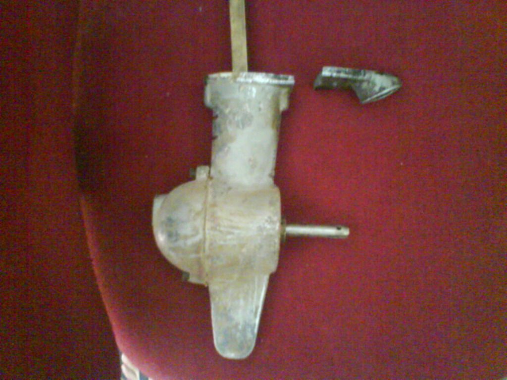

My name is Stelios and I am new here. I am from Greece and I bought two seagull outboards (both silver century) a week ago. I bought them as not working as the one has no block and the other one has a cracked one. So I started disasembling to be ready when one new block arrive. My major problem is the old screws. I spay them with WD40 but it is still hard to unscrew them as I am afraid not to break them. Any tip welcomed. The other problem is that one gearbox is broken. It's not that bad as you can see from the picture. My question is if anyone has ever used the following products to repair a part. I may order some rods and I would like to know if there is any good.

That's the broken part of the gearbox.

I would be giving John a call. Much easier to buy another. His number is on the logo top left

I know the easy way but I prefer try at first and if I fail buy another one. In adition I have the second gearbox which is OK. I like DIY.

Fair enough. The drive tube clamp on the water pump housing is the only thing that stops the box dropping off so needs to be a strong repair

All of these 'easy' aluminium repair rods are alloys with in excess of 95% Zinc. If the repair is immersed in water expect corrosion problems. If the repair is immersed in salt water and is attached to other metals it will rot away in a matter of months or even weeks due to electrolytic action.
The *ONLY* way to repair aluminium for marine use is find someone who can TIG weld it. Not all castings are even weldable.

Thanks for the info! Luckily today I found out that one guy in a workshop near me can do it with argon. It must be TIG process. I will ask about corrosion before welding.

Stelios. Get it tig-Argon welded. It will be a lot stronger than patching it up. You must realise there is a lot of vibration in that area. Thats what has caused it to break. It would of been a mix of vibrations and overtightening of the drive shaft clamp bolt. Get it properly welded. and use a new stainless bolt and washers. And dont overtighten it.Stelios_Rjk wrote:Thanks for the info! Luckily today I found out that one guy in a workshop near me can do it with argon. It must be TIG process. I will ask about corrosion before welding.

Yes I 'll do it this way.
