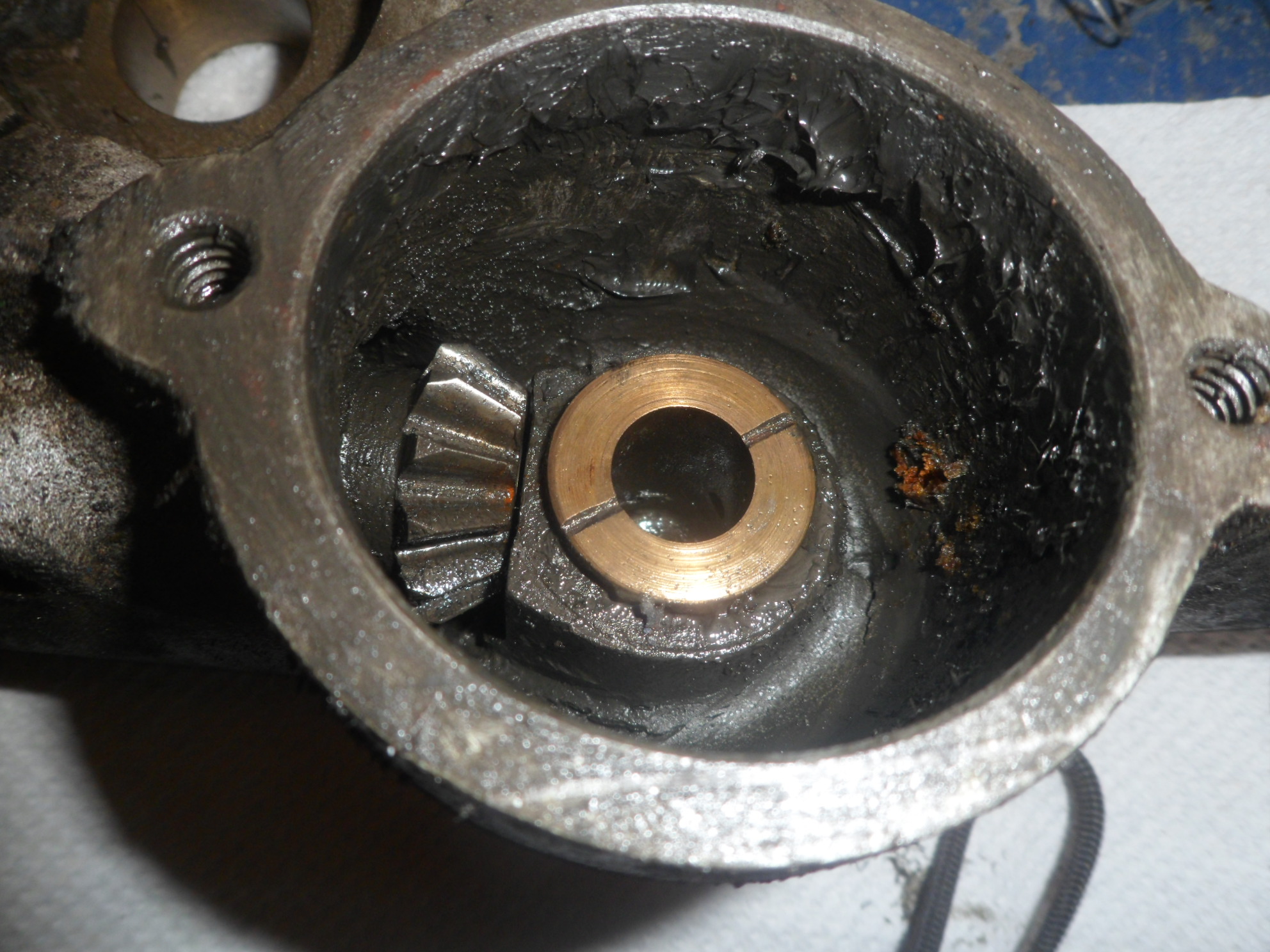

Can anybody give me any advise on removing a gearbox bush from an Anzani Pilot gearbox
it has a 1/2" bore and is rather worn to say the least
I am hoping to replace the bearing with an off the shelf item
as I have only limited workshop facilities,
Or maybe somebody out there may have a spare gearbox that I can purchase

Is that a blind hole? If so the bush will have been tapped in without thinking about having to change it at some point :cry:
You could try heating the area around the bush to see if it will shift? I'd perhaps be thinking about carefully cutting the bush and then breaking it uo in-situ carefully. Fiddly and takes time but can be done. A new bush can then be made. I know somebody who could do that for you at a nominal charge.

I have managed to remove the same using a 14mm tap which was screwed into
the end of the bush (Just about one thread) I then heated the casing popped the
tap end into the vice and gently tapped the casing off the bearing
