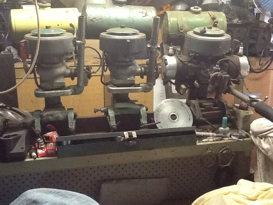

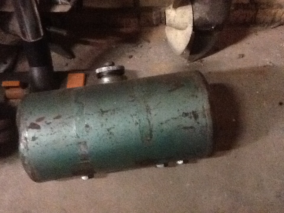

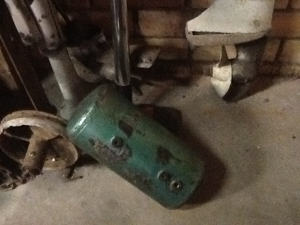

I also have a couple of Riptides. One day soon I hope to get them going. One of them has a fuel tank that seems to be correct, but is not. I don't know if there is a bracket missing or what.
I'm sure somebody will be able to advise me,
Cheers.

Nice collection there!
See what you mean about the tank, looks like it has been replaced at some stage. The livery looks like Victa? The connection bolts underneath the tank are also different.

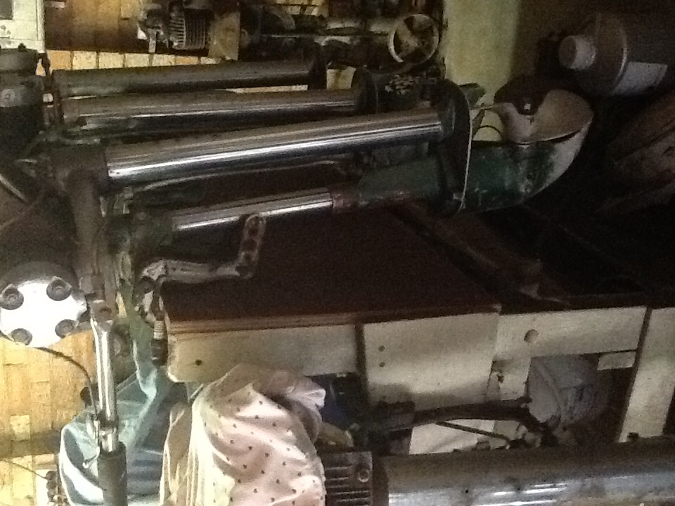

Different ignition advance levers on the two single too. Do you know how they are meant to be operated in actual practise?

I think the Tank may have been changed, but have also wondered if there was a Long Range Tank available, as the style is about right, and with a couple of small brackets made, it should fit.
The throttle advance levers are about the same, although one is slightly bent. I have yet to start any of them, so I don't really know how they will work.
I seem to have a problem with aquiring outboards, and not enough time to work on them. :oops:
