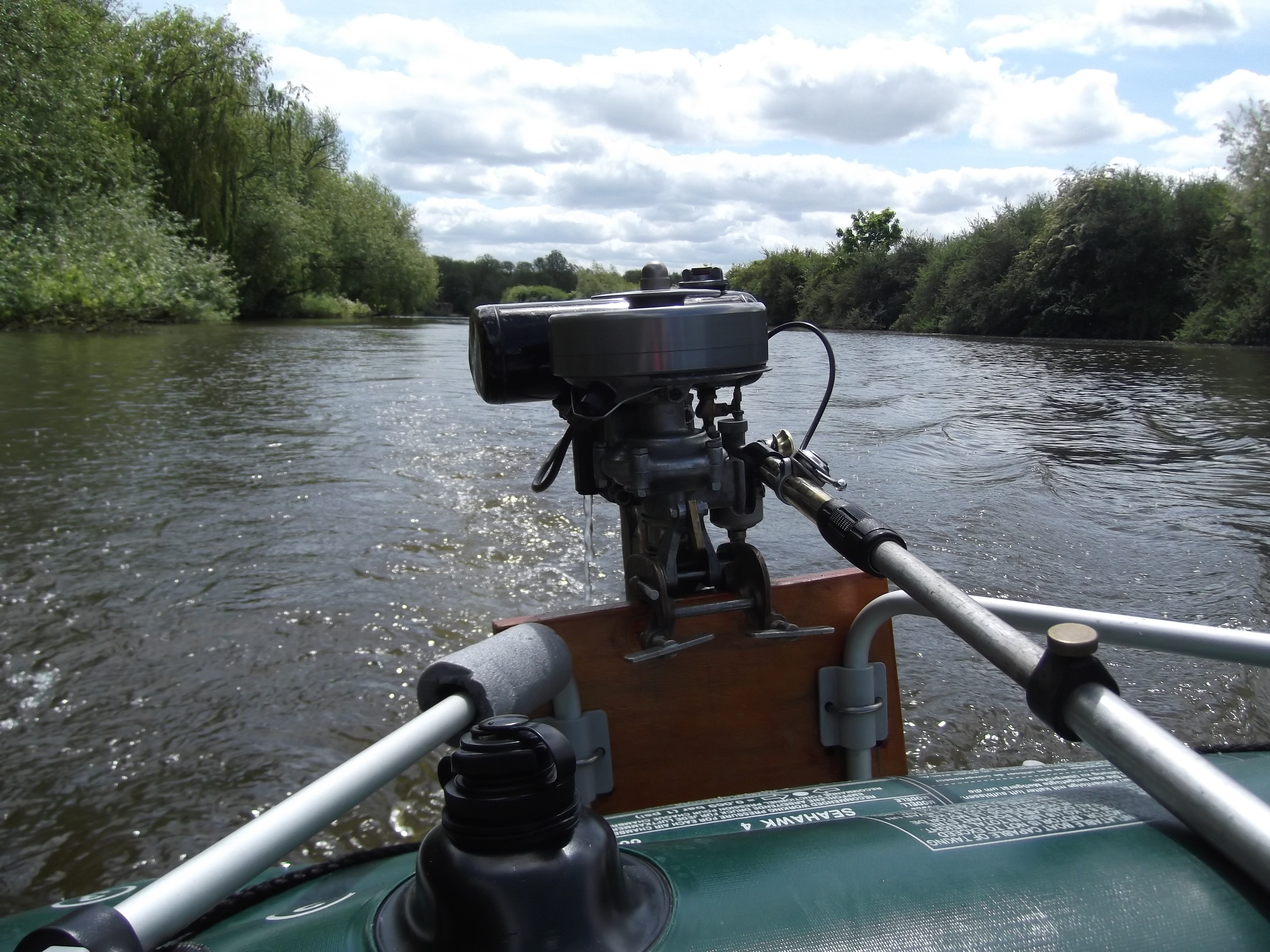

Heres a picture of the sjm on first run after being rebuilt
