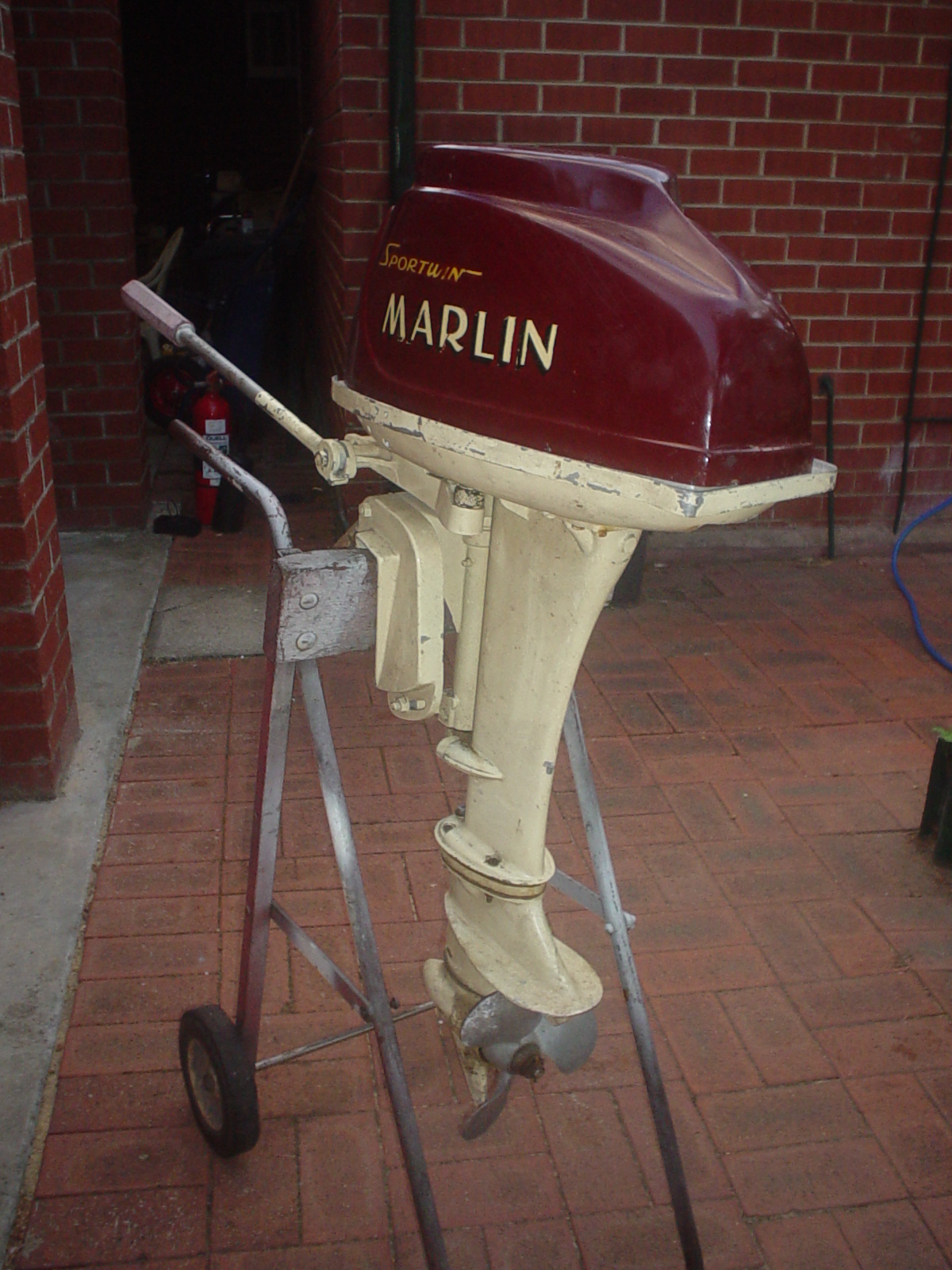

One day one of my Marlins will be on my larger boat................18HP and fixed drive as well.......pull and go.
It is a lump of a thing with another learning curve.
