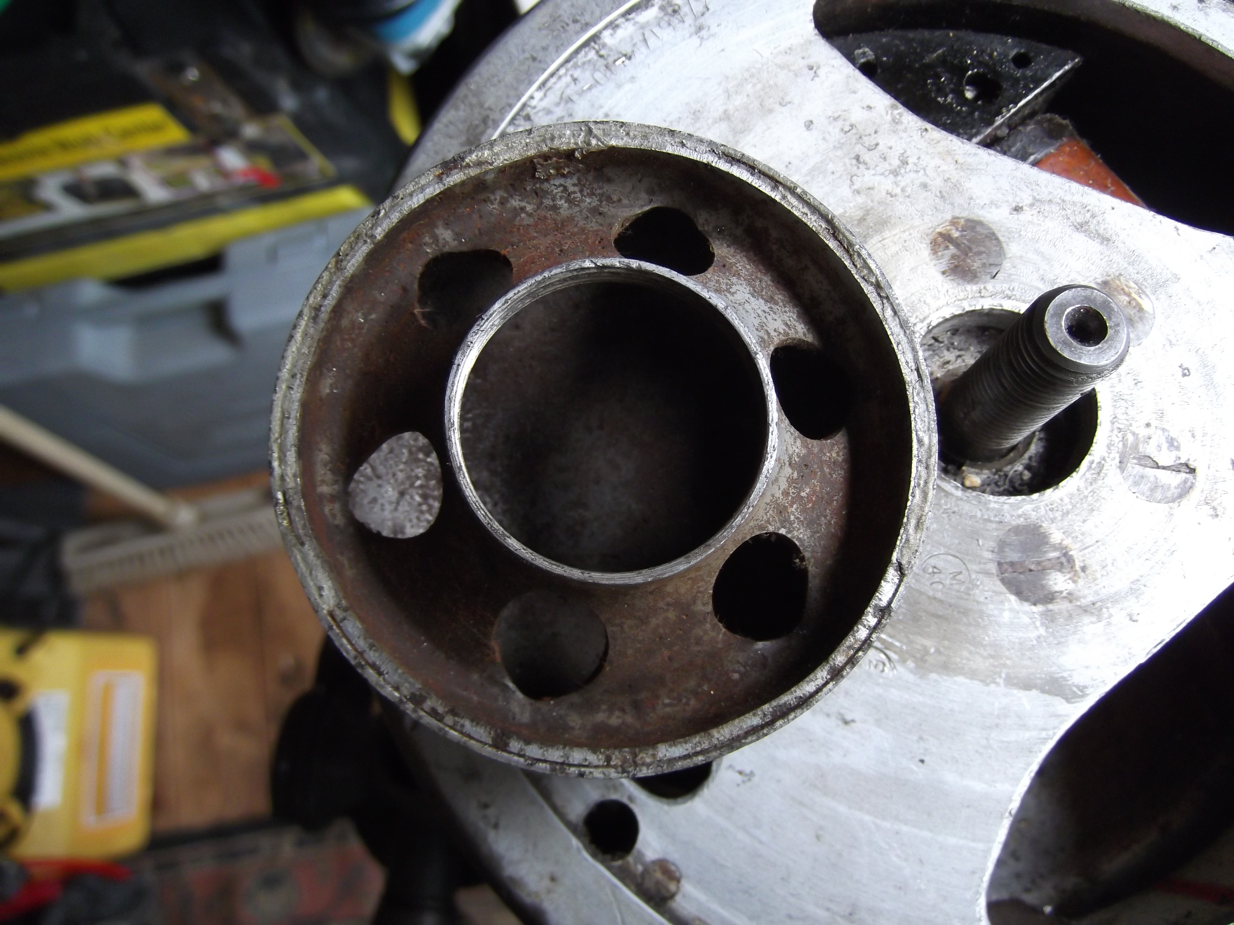

Have not started it yet as i tried reverse flushing but only a dribble came out so the head is coming off,
got the nuts off with heat but the head will not move, around each stud it is solid with concrete crud, i have been carefully chipping it out
and now i have a gap i am using vinegar to eat through it,
its very slow going but but seems to be working, the main thing is its very gentle , does any one else know a better way i would be interested.

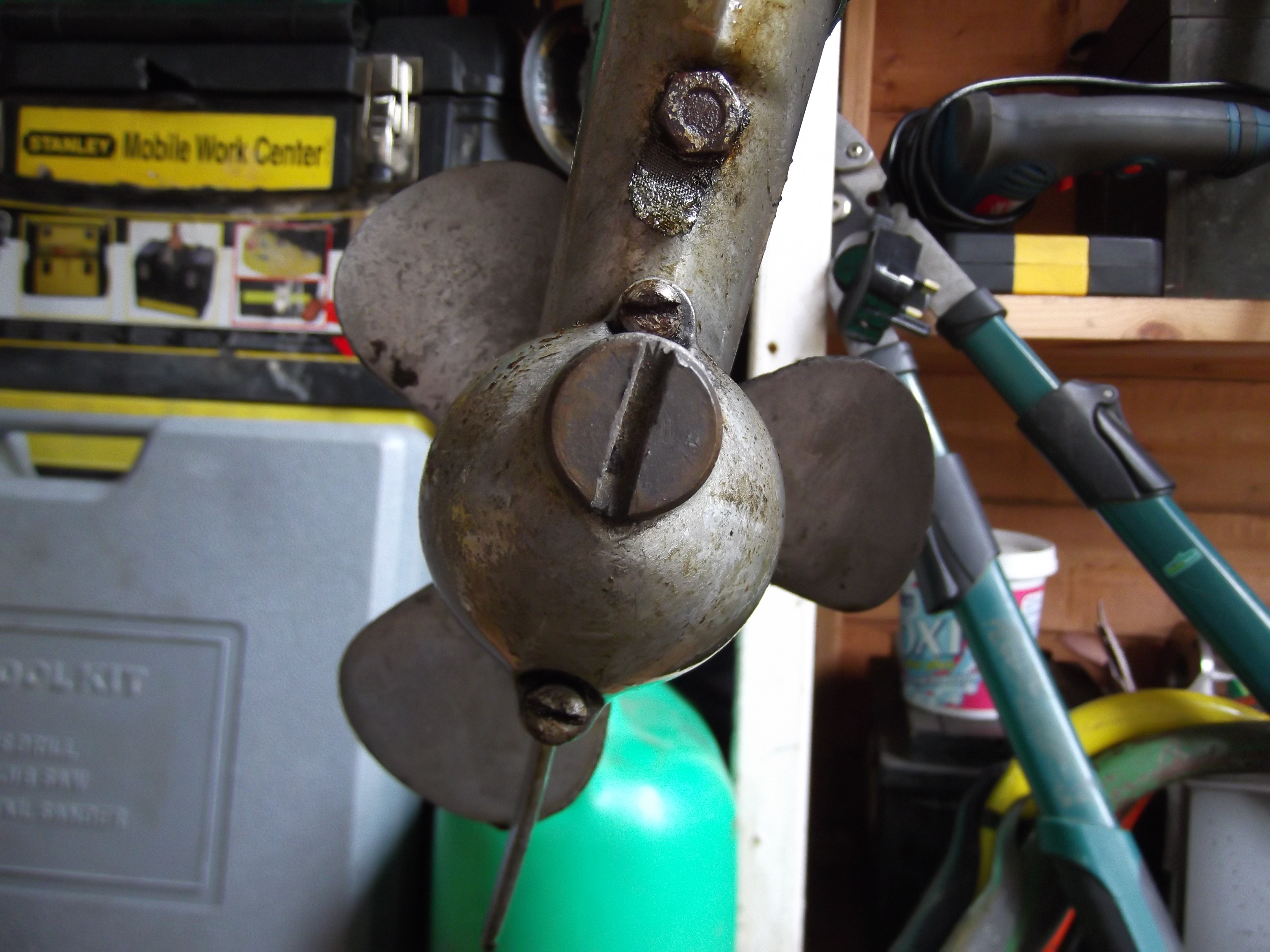

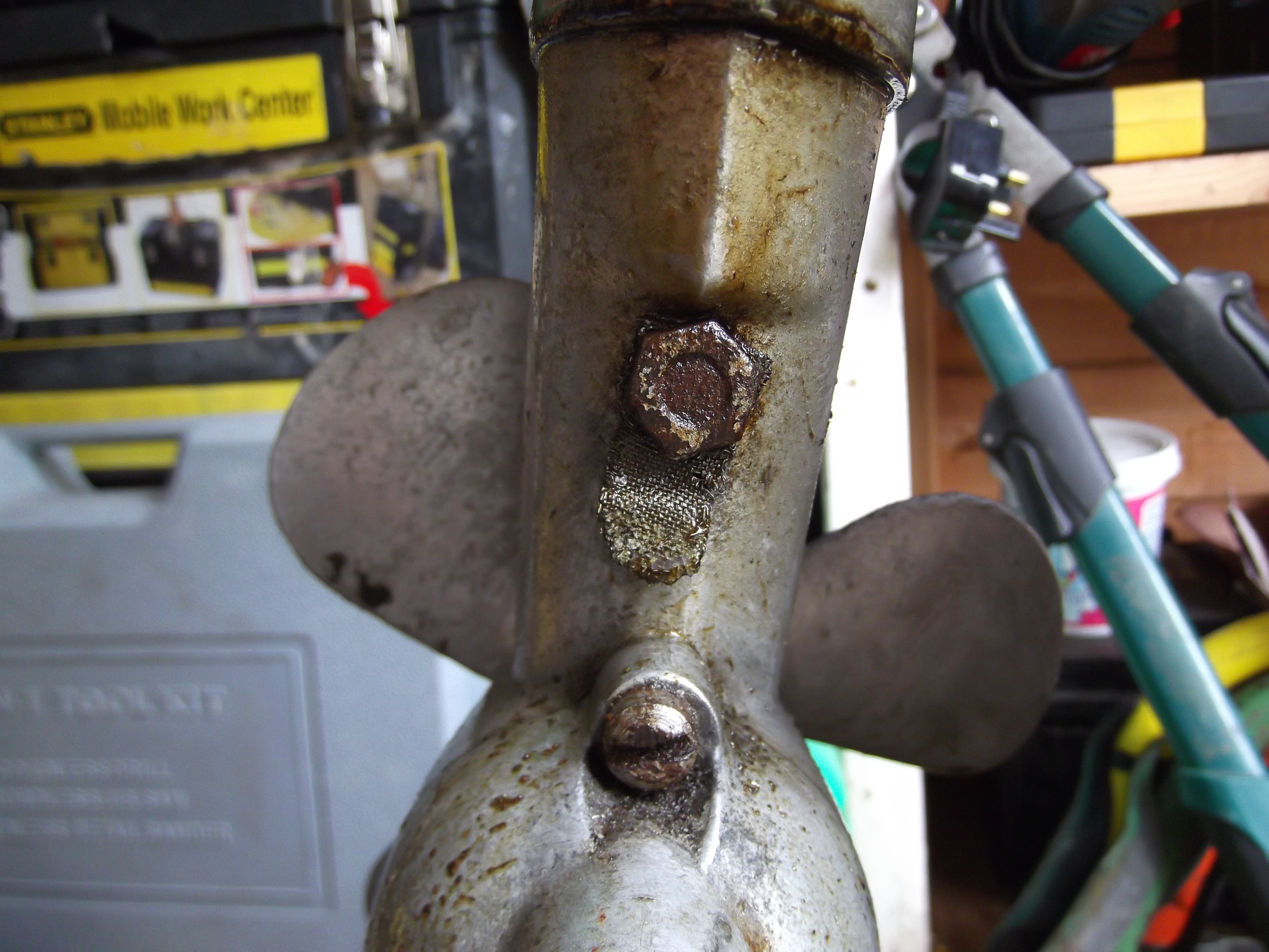

The gearbox would appear to be a later addition. Normally the water inlets on these are 2 round holes instead of slots?

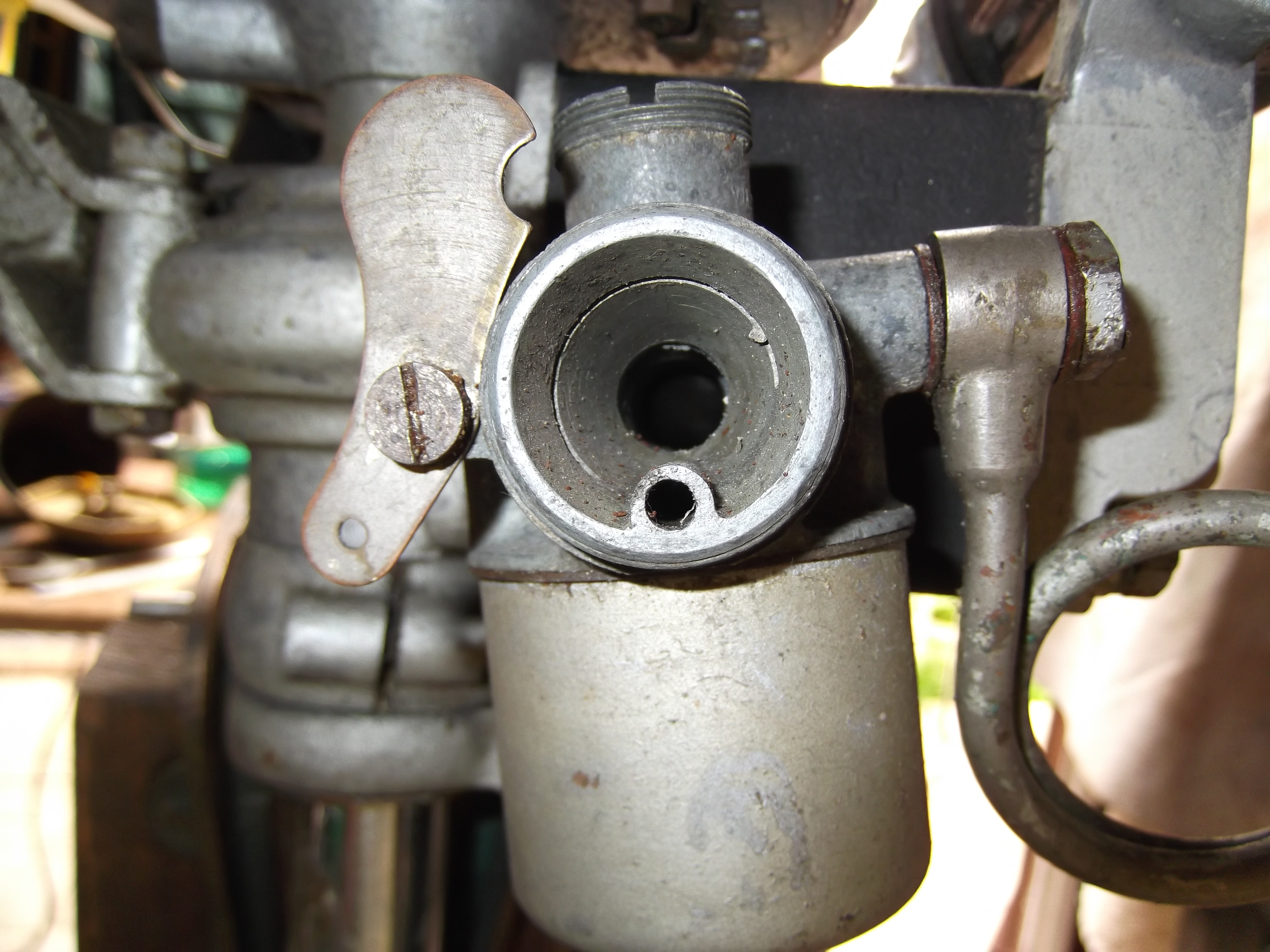

Carb looks suspicious too (weird inlet cover) Remove the carb from the stub and have a look at the internal bore size. These are normally 7/16", later 40 series motors had a 1/2" carb fitted.

Gently does it with removing the cylinder head on these. The less intrusive methods for removing corrosion the better. Vinegar will work well but takes a while...
I just hope the studs that hold everything together havn't rusted away to oblivion. I bet the waterjacket is full of crud and rusty sludge.

the carb is 7/16 no hole in choke or float bowl
the gear box has got the 2 holes but at some time in its past a piece of wire gauze has been bolted into the top hole and covering the bottom hole, it seems the bottom hole has been
enlarged to account for this

quite interesting the carb intake cover, seen them on lawn mowers from that time, i am sure another f or fv a few years ago had the same cover on it, if i remember right the poster was told to to change it because its wrong, maybe a choice of add ons was available back then

and some of the carb
