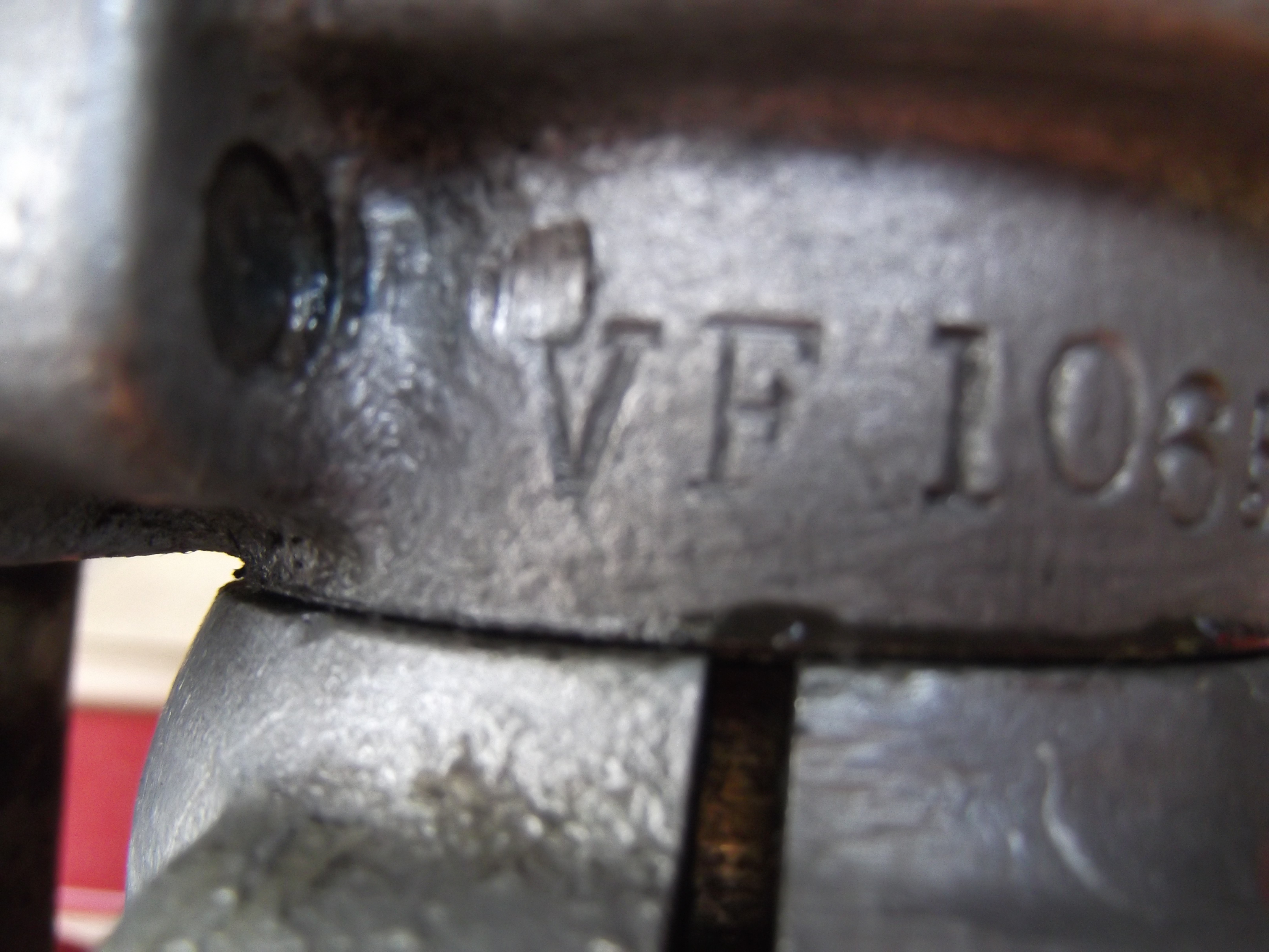

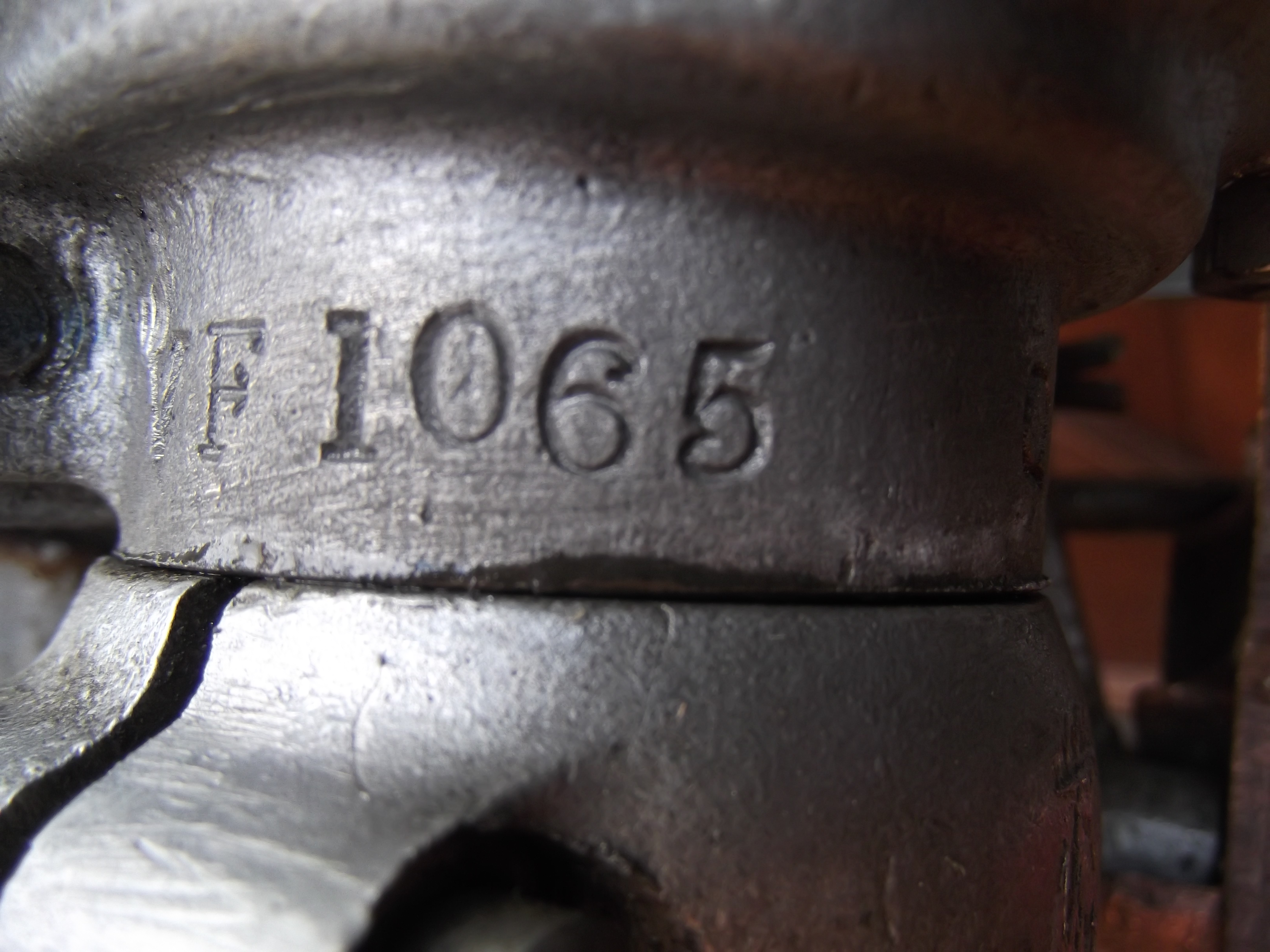

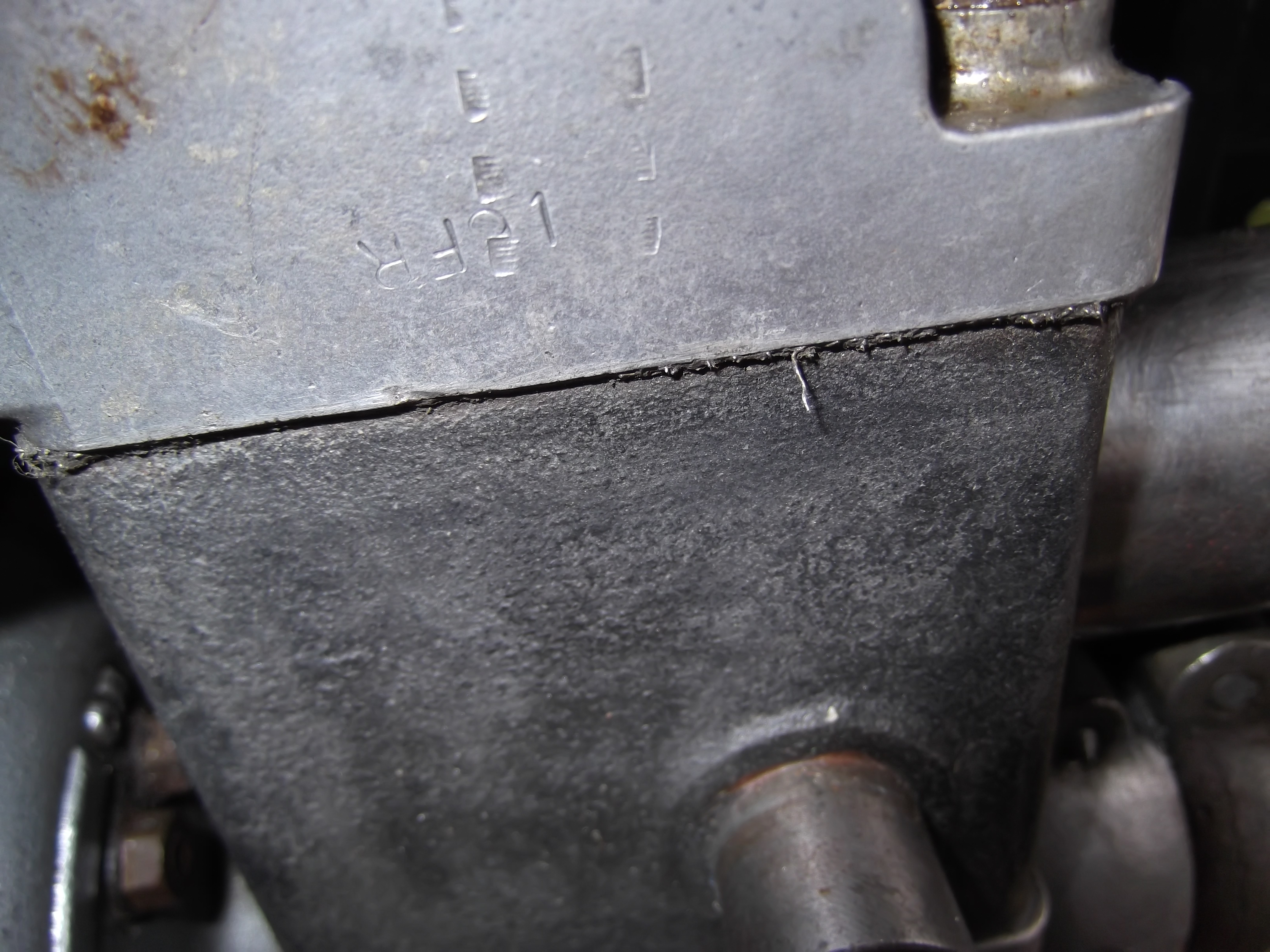

here are some pics of the number in close up
this ones interesting a 2 digit number followed by the letters fr
could this be, as charles uk said a signature of another worker or could it mean its a refurbished f
also notice the gasket its wire gauze and a black tarry substance
dave

Thanks for that, it would be interesting to know what the difference is, if any, between an VF and FV, unless its still a 40cc motor like the F, that would make a little more sense.
Re: vf1065
See what you mean Keith a little 40 (F) with a Villiers carb (VF), it's possible.

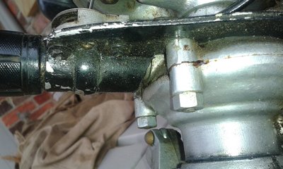

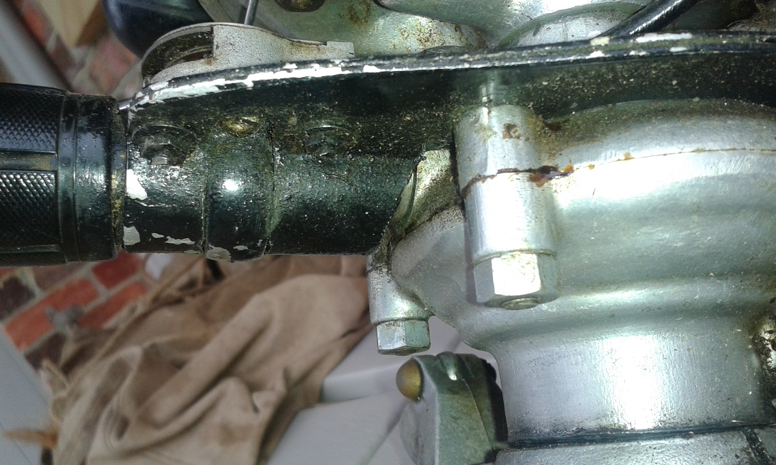

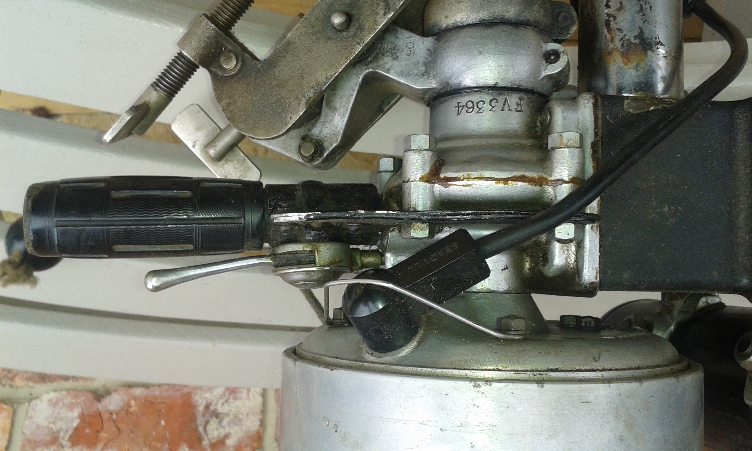

Now you have the tiller bracket off have you a photo of the crankcase stub? is it actually broken of is it machined as this?
My FV had a "special" stub bracket that looked to be a repair but then after removal the stub on the crankcase was found to be a factory machined one as fitted to the first tilt tiller engines. Photos are in a previous string.
It was pretty much decided by the collective forum that the crankcase half had been changed and that the repair was post delivery even though the original owner, like your vicar, had no recollection of it.
AJ Tassi. Ps My other FV also had a lawnmower carb. cowl. That has now been removed and the correct one fitted.

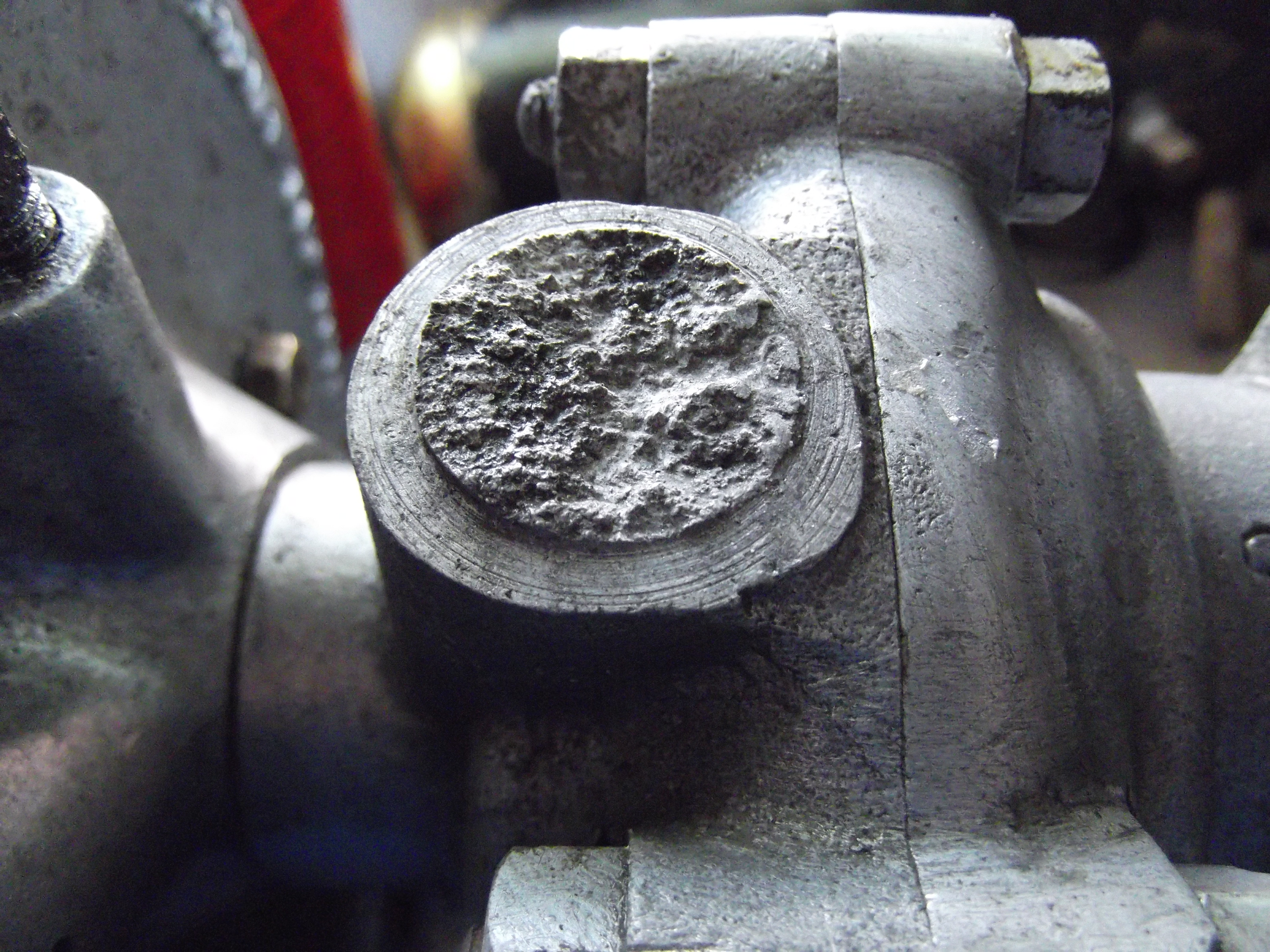

hi AJ
its definitely broke
the made up attachment is quiet crude looking

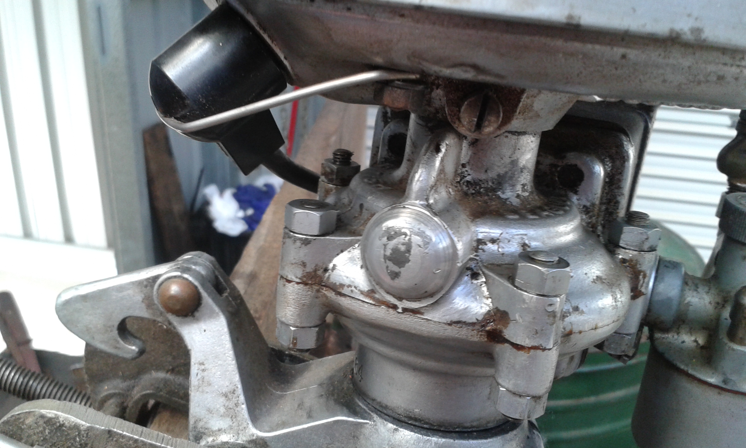

the carb cowl is very different to the normal one, i would like to think it might have been an option
after all seagull sell plastic ones that do the same job now,
so far two have turned up out of how many fs,
then again maybe they undid through vibration and lawn mower ones were cheaper.

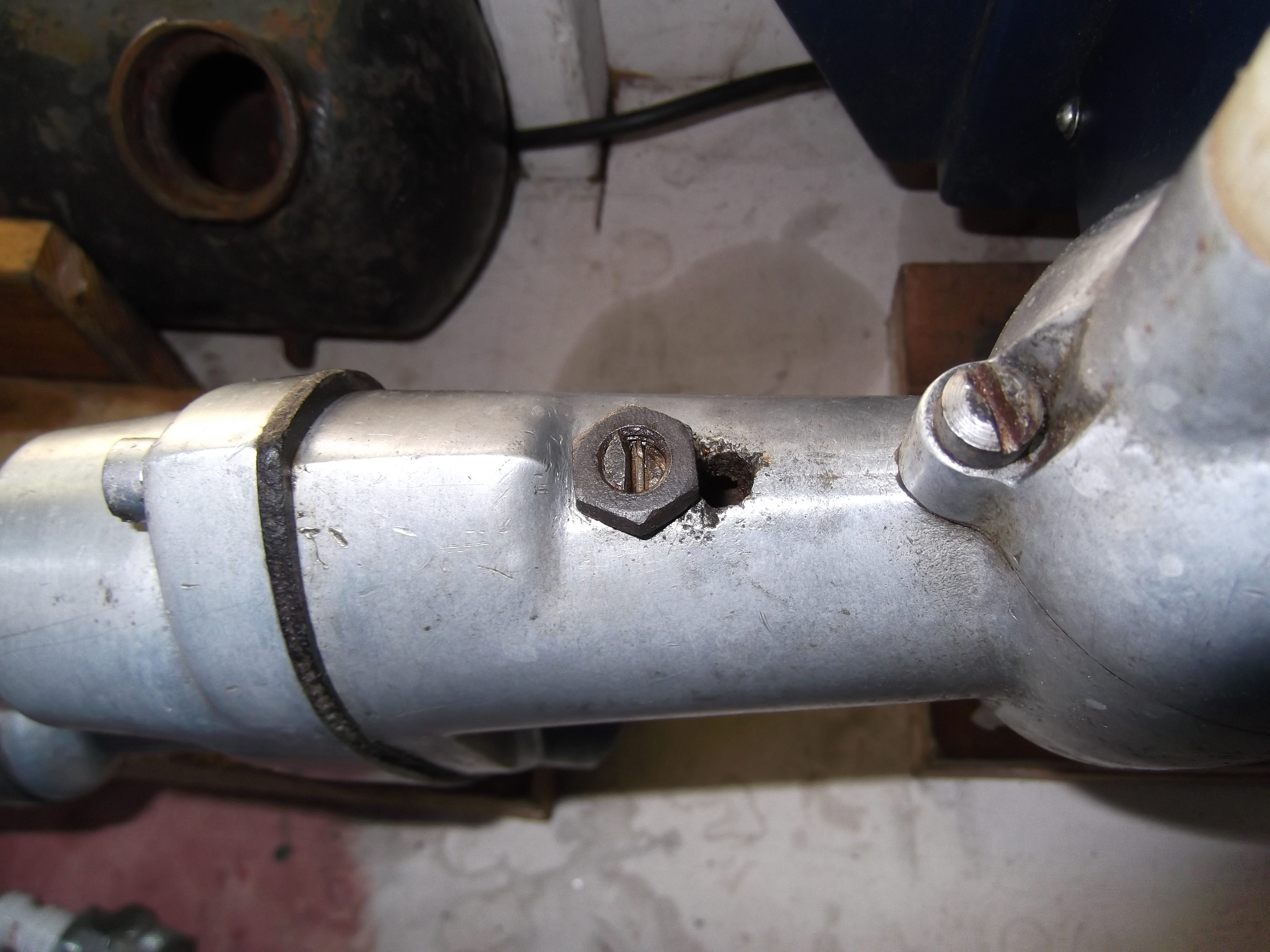

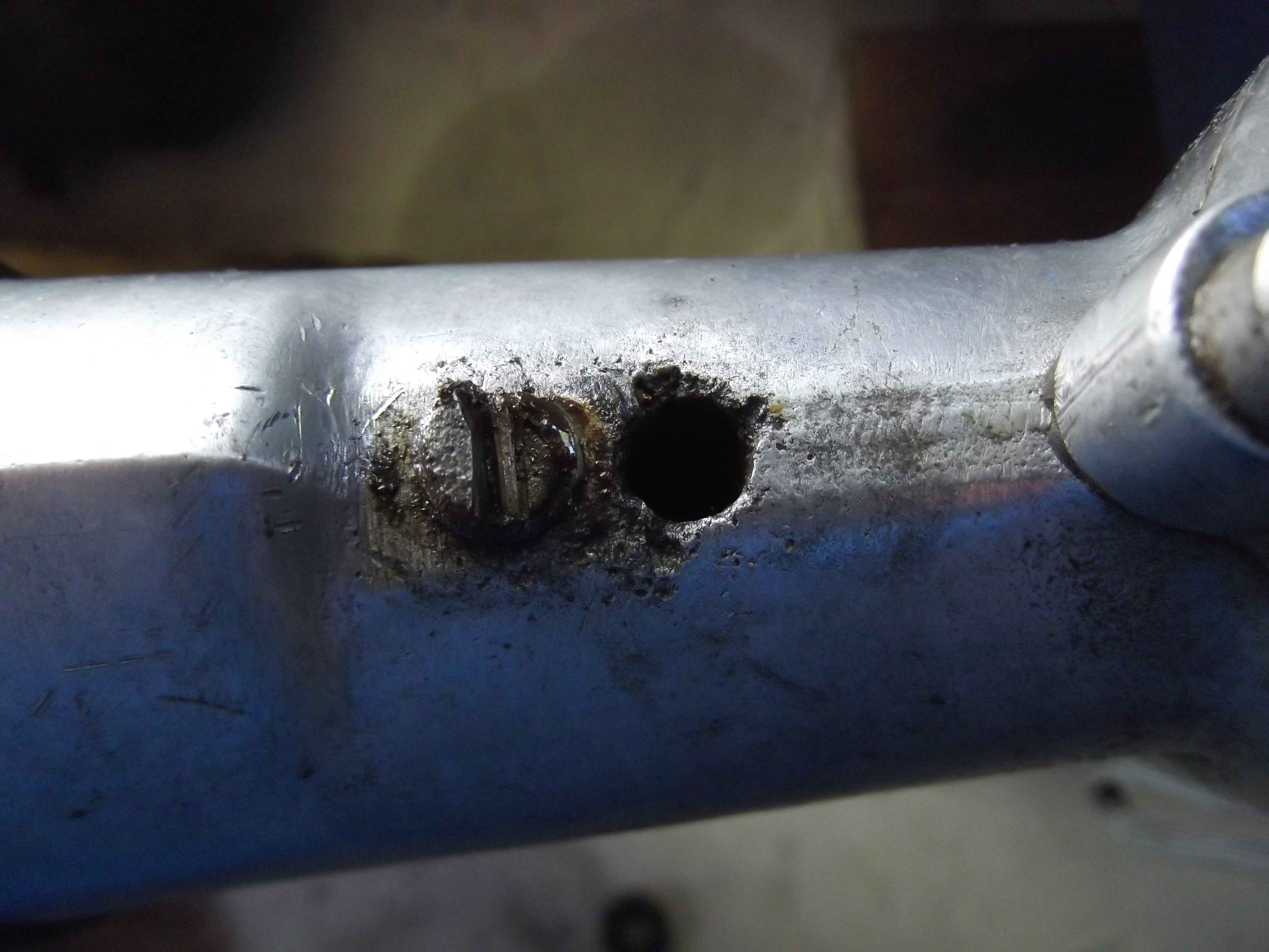

heres a couple of pics of the water intake holes,
will have to drill this out it wont budge.
dave

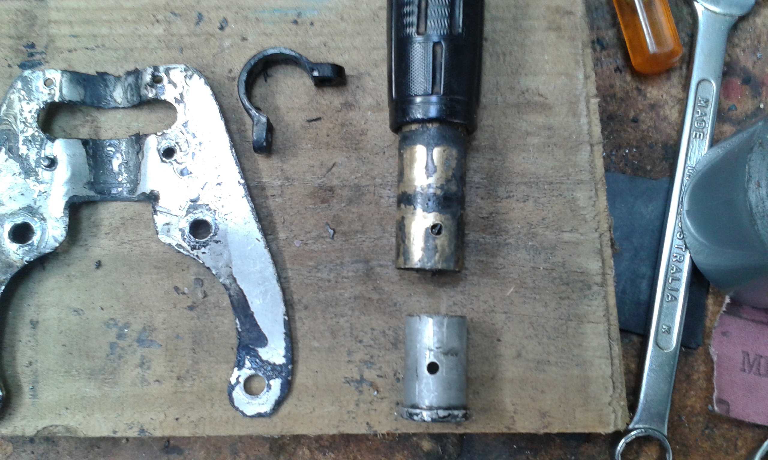

Re posted pics of stub tiller support.

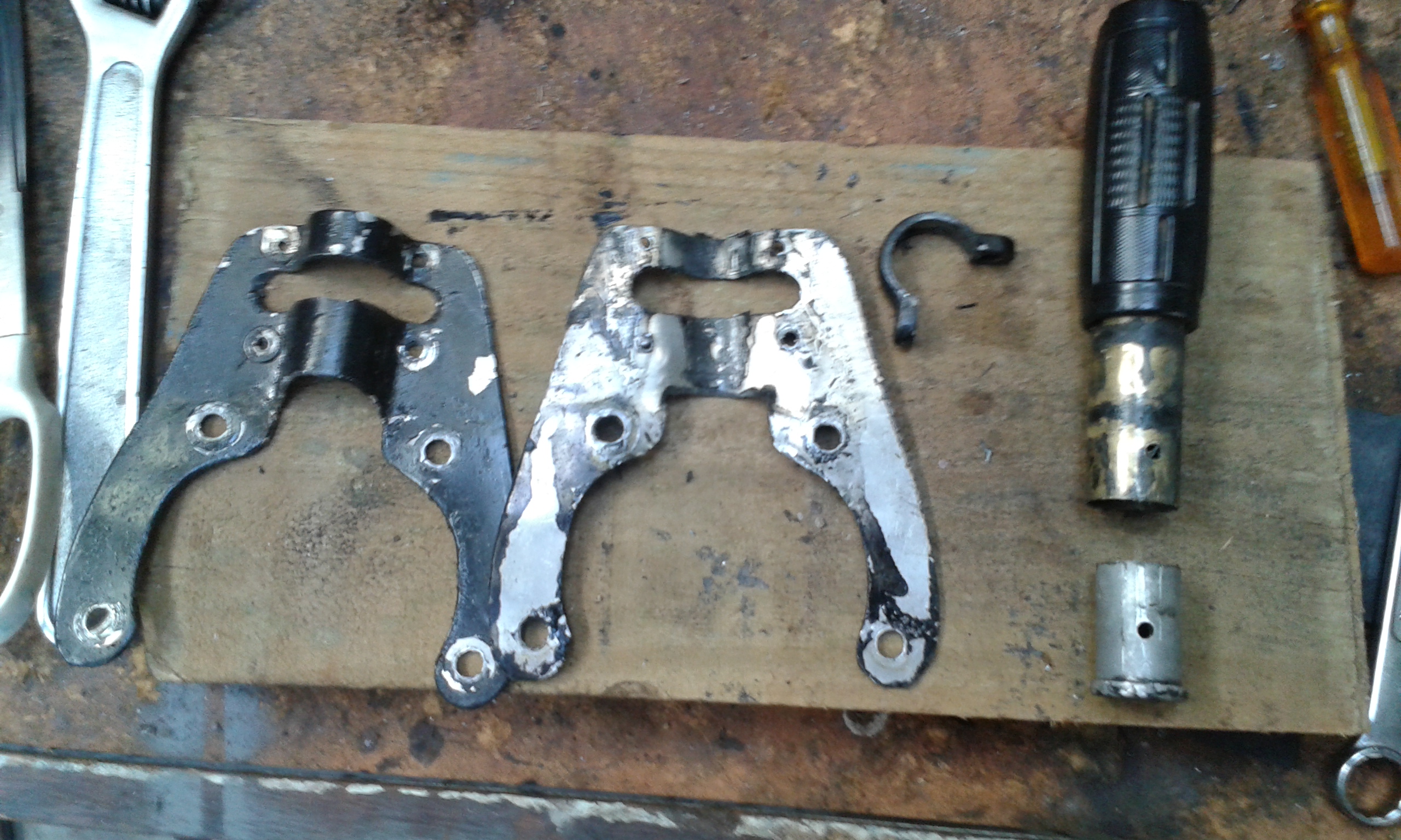

Couple more

Thanks AJ, totally different to my one and a lot lighter.

Several options for repairing that tiller stub if it was me.
1. Machine the existing stub flat and drill and weld a new one in place, carefully dress the weld and you may never know.
2. Machine the remains flat, machine a small counterbore to locate the new stub and drill and tap a short hole, screw a replacement in. Once fitted with a tiller it will be invisible. I know a guy who would be able to do that.
There should be enough metal there to do either.
Posts: 758
Location: Tasmania, Australia
Re: vf1065
Post by Adrian Dale »
The first option would be the way to go and was what I had been considering with mine until I found that the stub, or lack of it, was an original factory machining. Now I am replacing it with a tilting tiller.
But back to yours; may I suggest that when drilling out you use a much smaller steel pre-machined stub ( flanged out from the thread to the correct size stub) with a shoulder to screw tightly against the casing thus maintain as much strength as possible in the crankcase casting. With accurate machining a good face to face joint will be formed and the full depth of the crankcase casting can be taken advantage of.
Again there will be no visible repair as the tiller sits snugly against the casing.. don't forget the large bronze split pin through the tiller and stub for complete authenticity
