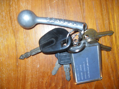

The gear lever was mounted in correctly through the large hole, I thought it looked wrong, I'm puzzled what the big hole is for ? Is this the correct 102 gear lever ?

Re the gear lever-- no it's the wrong lever fitted. The correct 102 clutch lever only has 1 hole for the stud to fit through. What you have there is a later century type lever (2 holes for mounting, the smaller hole is for the rod) but it will still work fine.

The lever

P.S. nice keyring.
P.S. nice keyring.

Keyring?
As for a replacement lever,have a look for century clutch lever for now, unless you spot an nice "original".
Most bits will swap over with little fuss.

Is this eBay item the correct 102 lever
321820162296
321820162296
Re: where to get 140 oil ?
No, that's the later type for later 102's and century's.
Bearing in mind that your motor has been factory re-furbished (hence the letter R in the serial number now) your motor probably would have been "updated" at some point.So this later type of clutch lever was put on because that's what was available at the time.

Depending on how accurate you want to be with your resto, either type of lever will fit quite happily.

The proper one is pictured below
