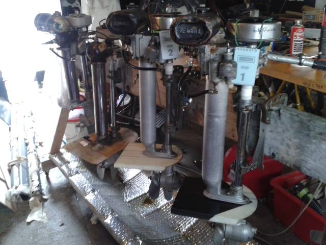

I made a anticav pan!

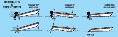

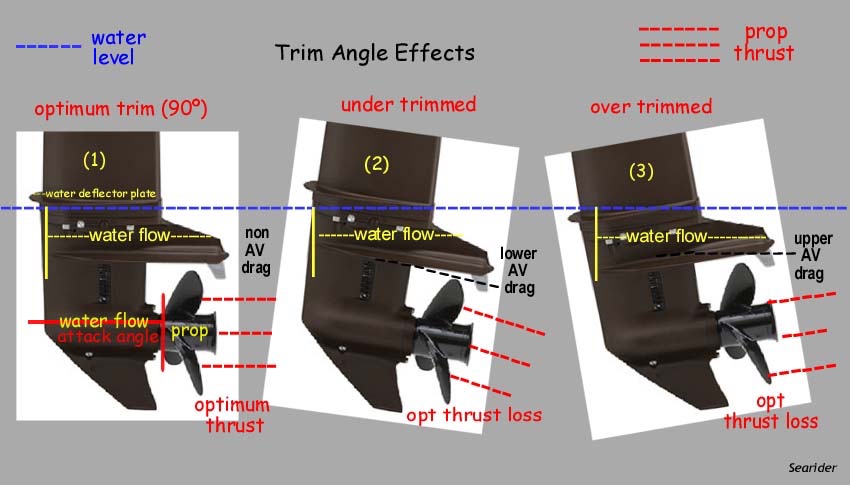

This is what seams to be most effective

Thanks Rene.
Middle set of pics is how my boat seems to be running at the moment!
Even though the thrust block is set as far out as possible, it still isn't enough.
I'm re-thinking with a block of hardwood cut into a wedge "sandwiched" between the bracket and the transom. This way i can set the motor to vertical (first set of holes on the trim setting) with plenty of option to go outwards more if i need to.

Your problem might not be the motor angle Jon, it's probably designed for the weight of a 15hp + motor & to run at more than 5 knots, some time after 5+ knots you will start to get bow lift.
The bow down attitude doesn't matter, when the only time your going that slow is when your driving in & out of the marina, when it's fitted with the correct size power unit.

So how is the Pan going?
I am going to copy what Olympics have.

I got another 2 1/2 knots out of my boat by adding one..... things may still change with a full tank of fuel in the bow.
