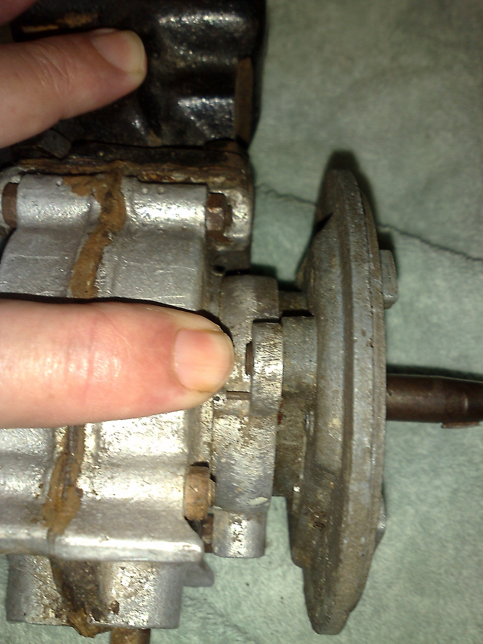

Yes Indeed there are marks Chris.
Fettle. No evidence of anything breaking off.
Wrong place for a stub for advance lever anyway.

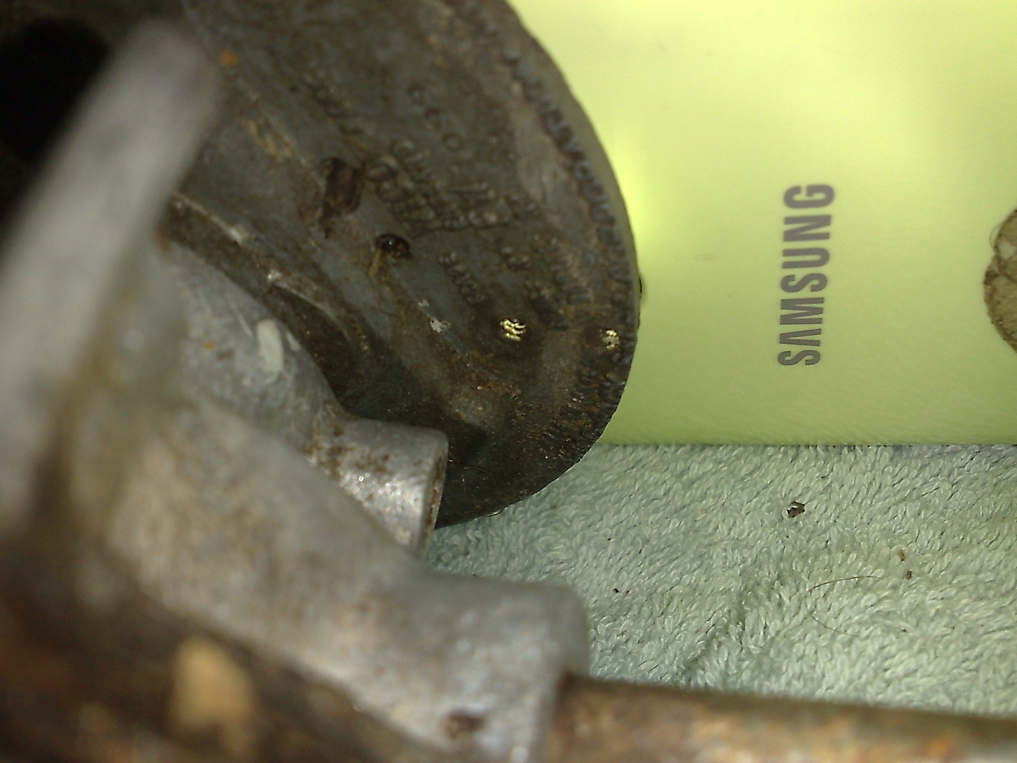

Yes the black plate has the magic words and lines on it. I poked about with a small screwdriver until.....
So bloody small a thread on these two fixing points I could never have picked them out unless the plate was cleaned on a full pull down. RRRR, this is where a lever should be fixed.
Perfect sense now aye.
6 - 32 BS

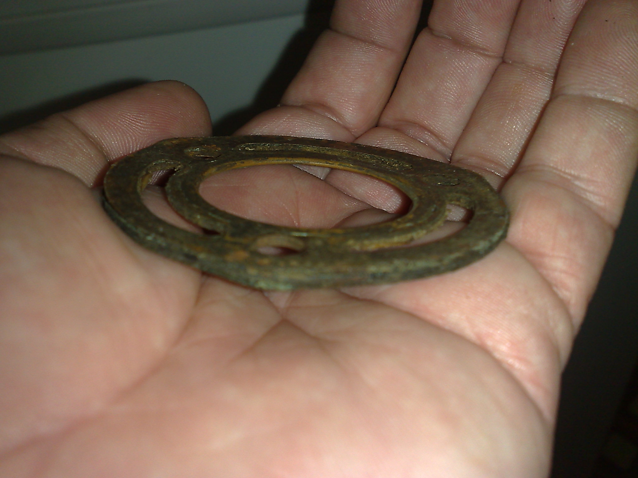

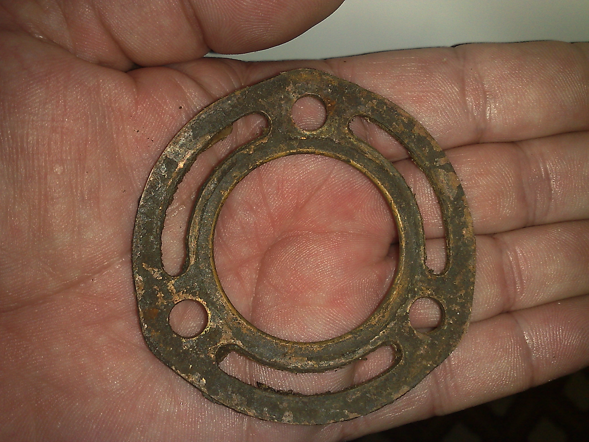

Interesting head gasket by the way. Asbestos between very thin copper. The copper is folded where the combustion chamber is. A very delicate thing actually.

Mine has the same 2 small holes, it had a scrappy bit of rusty thin steel bolted to it. Looks like it may have been a pointer of sorts (not the orignal)
The tiny bolts look far too small to hold any leaver.
I ended up making a head gasket out of copper, I could have a go at making one like the orignal but it is not easy cutting the asbestos gasket without breaking it through the water ways to the bolt holes.

A very small lever indeed.
Maybe a right angle piece of thin steel bent up and next to the flywheel. I have seen your photobucket pic of cutaway of motor. Seems to be something like that though a not good image. The fixings are two black dots.....in line. That is what made me get into looking.
There is no way that this lever could be capable of sticking out forward again away from the flywheel as the leverage would be two much if roughly, drunken sailor, pushed about.
Have a look at the diagram you have.....really closely.
I would appreciate any other pics of any other examples by the way....may well, between us, sort everything out aye.

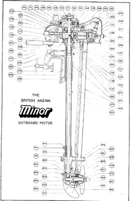

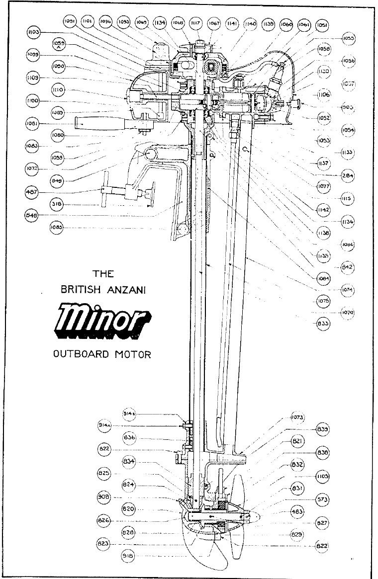

Yes I would like a scan of the MK2 pages.
I think the MK1 is part number 1101 as below.
B[/color]
							Buy It!
