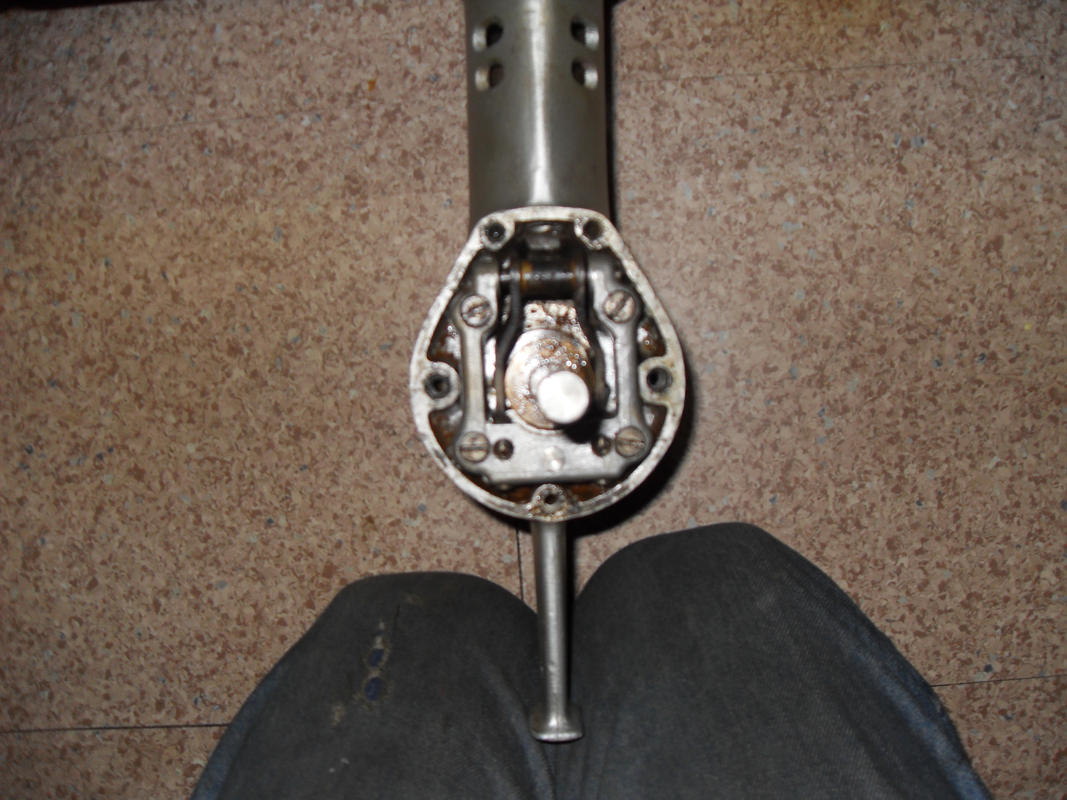

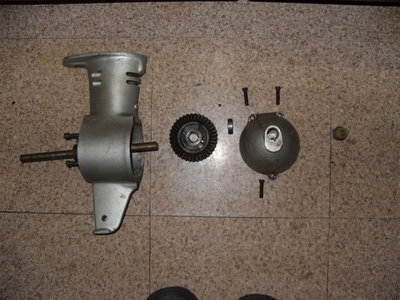

Do you mean this? As you see it in the pics is how it goes back together
There's also a bronze collar that sits between the pivot which pushes/pulls the prop shaft fore/aft giving the fnr gears. By removing this bronze collar will allow the removal of the rear most gear (reverse gear in this case)
rear cover removed showing the pivot and "plungers" and the bronze collar fitted onto the prop shaft.
difficult to see in the pics but between the gear and the front cover is a very thick washer,almost the same size as a collar.

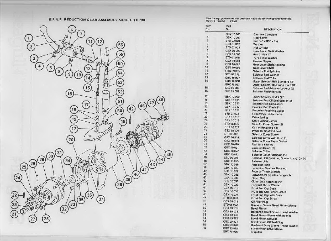

maybe this will help,
#43 Forward thrust washer

Thanks lads, I can see from the photos and diagram where it goes, and I think I have discovered what my problem is. There is no retaining pin in my forward gear. The hole is in the neck of the gear, but the pin is missing. I can't figure out how it worked at all with the pin missing, but it did for a short while after getting it back from Classic seagulls. Maybe it is a good job they are in a different country, or I might be tempted to stick it somewhere that would make it uncomfortable for them to sit down ! :lol:

No "pins" on the gears. There is however a drive dog that sits in between both gears. If the gears are too far apart there won't be any drive just a lot of grinding and odd noises! Both gears are supposed to spin freely on the prop shaft.
Check the positioning of the THICK thrust washer (looks the same size as a bronze collar).
Starting from the front (and assuming you have the reverse gear wheel fitted onto the shaft) the forward gear goes on, then the thick thrust washer, and then the rear cover and bolts.
Something not right here?
The prop shaft should be able to be pulled/pushed in and out (will be quite stiff) then turn the pinion to double check which rotation it's going in.
If the thrust washer is not in place correctly, the gear will just spin without engaging to the pinion.
Check and double check everything before you button it up for good.
Any more pics of the internals with the end cap removed?

Just looked at the diagram again. The pin I was talking about was for the clutch dog. The hole in the neck of the gear confused me. I assume now it is to allow oil pass though it on to the shaft. Good job this is all done by internet, cos I can't hear all the laughing ! :lol:

Decided to have another go at this gear box. looking at the diagram I see that I need a new bevel pinion. There is at least two teeth broken on my one.
