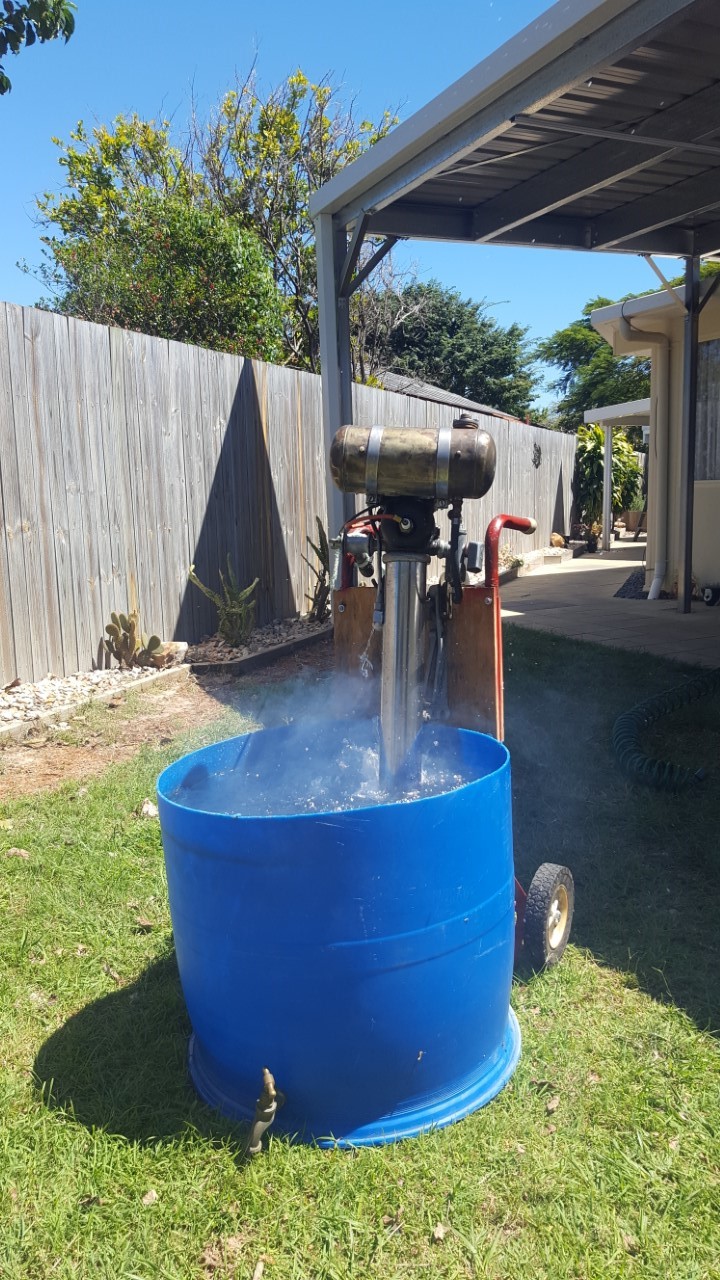

Anyhow this motor ran great in the tank pumps heaps of water etc.

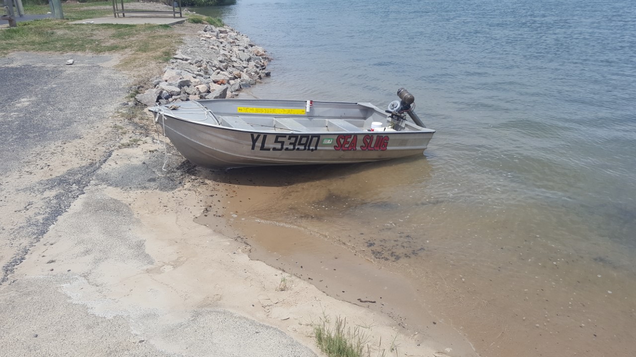

Put it on my tinny - Sea Slug-( by the way it was already named that when I bought it just a coincidence) for the motors maiden voyage

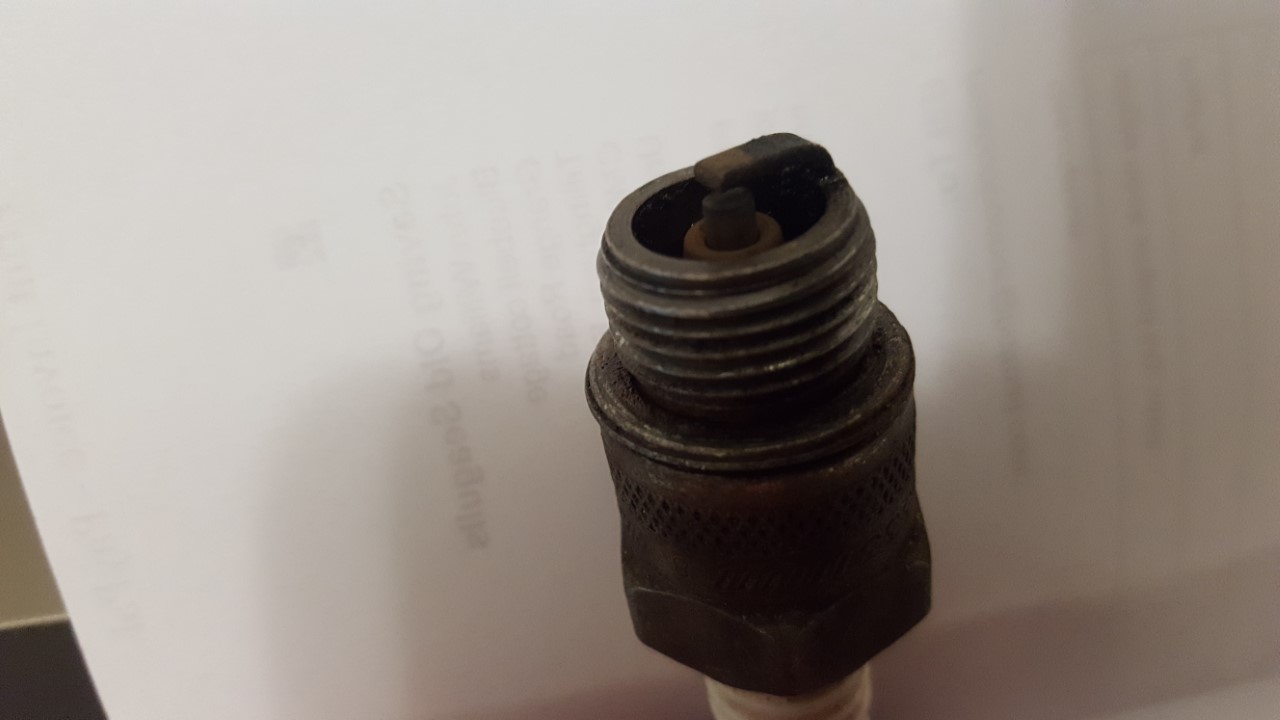

did the most important thing first and had a beer. After a severely needed drink the next thing I did was pull out the spark plug for a look and even though the fuel was the correct mix of 10:1 - 100ml per 1 litre of fuel - this is what I found the spark plug was not oily at all?

I'm no expert, but i'd say the colour of the plug was about right. (they're not always oily) Just a couple of weeks ago i ran my little EGF hard and fast on the canal for 10 minutes, and once it was back home i took the plug out for a look see. It was in pretty much the same condition as yours.

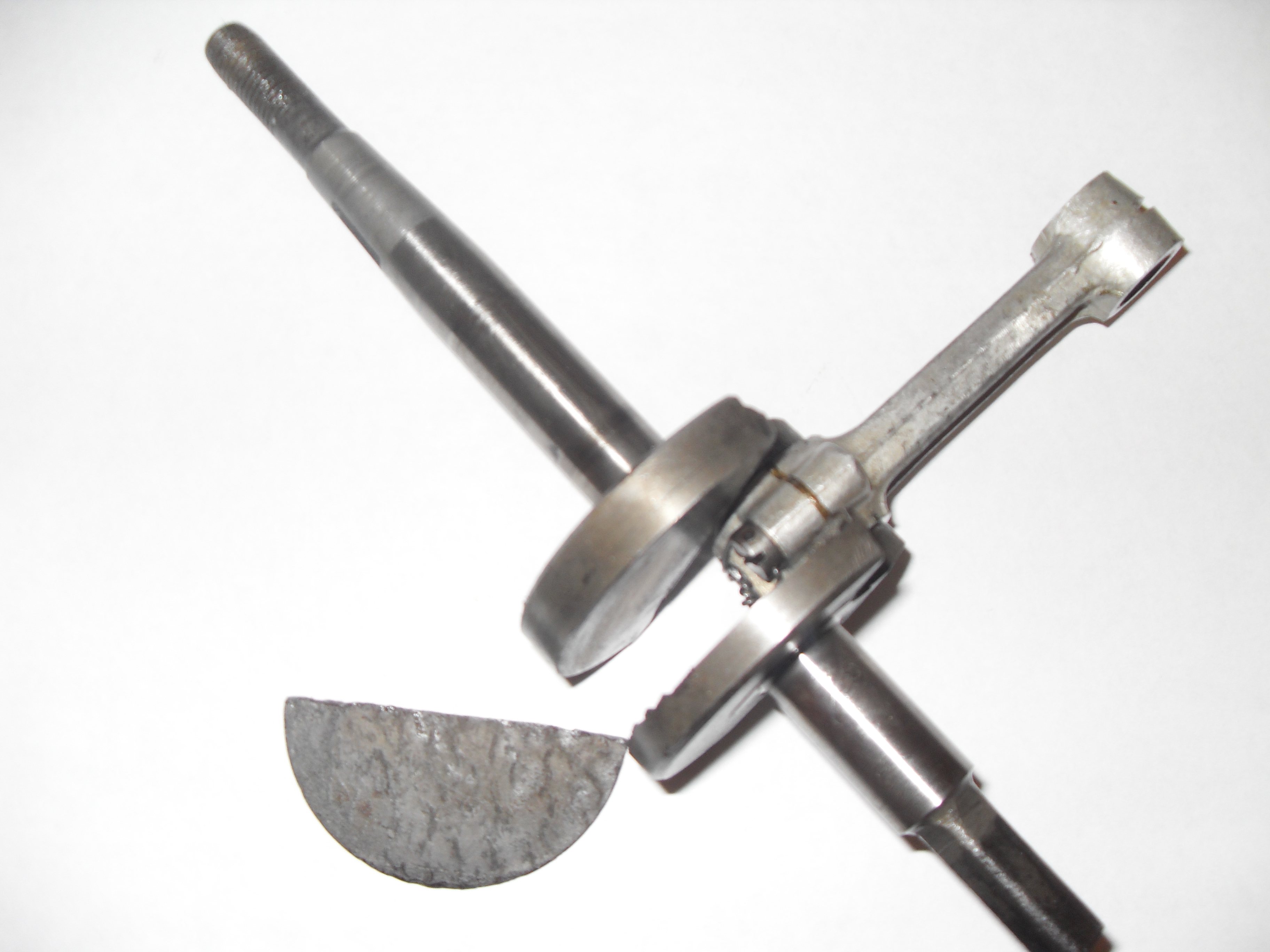

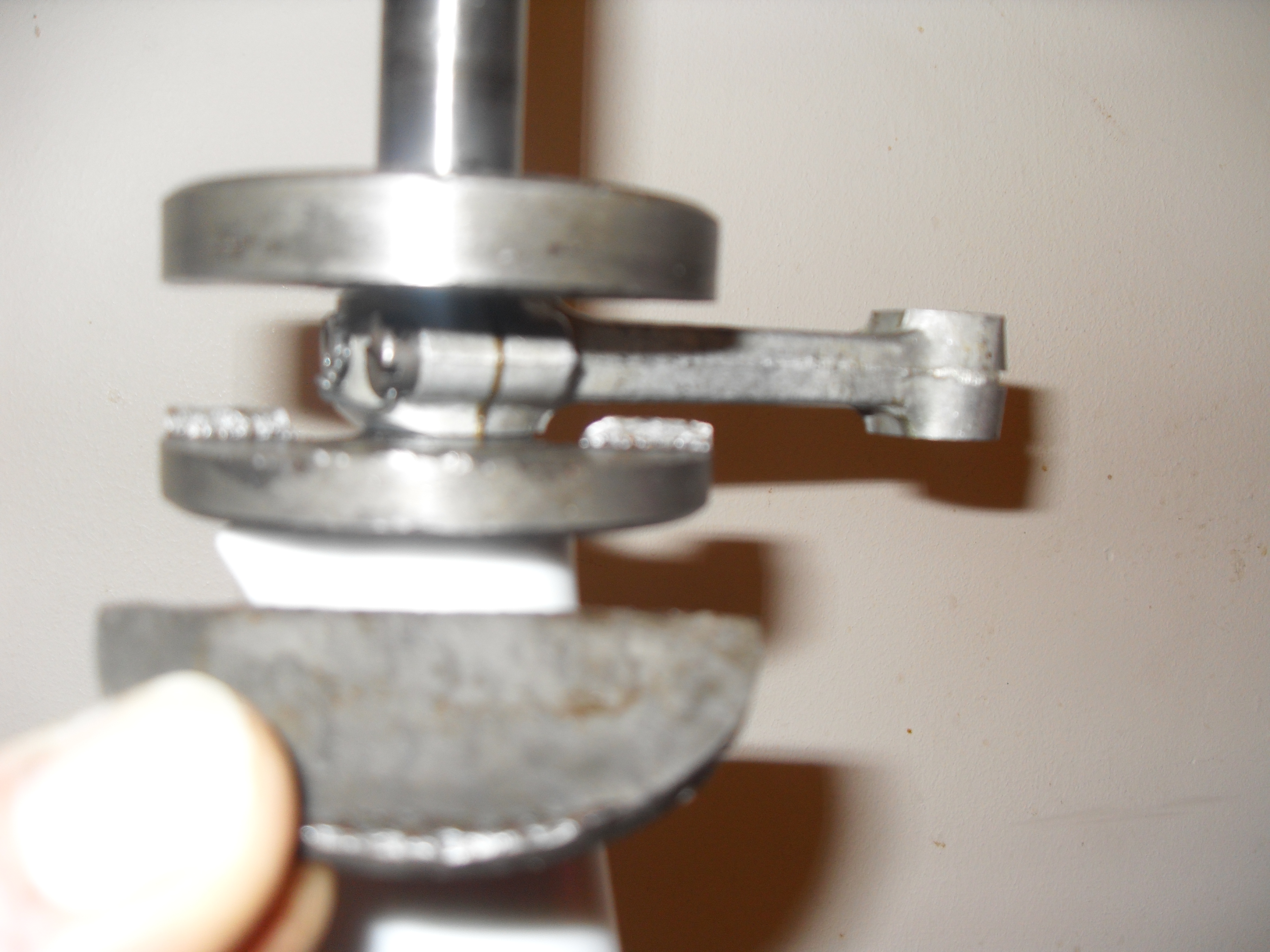

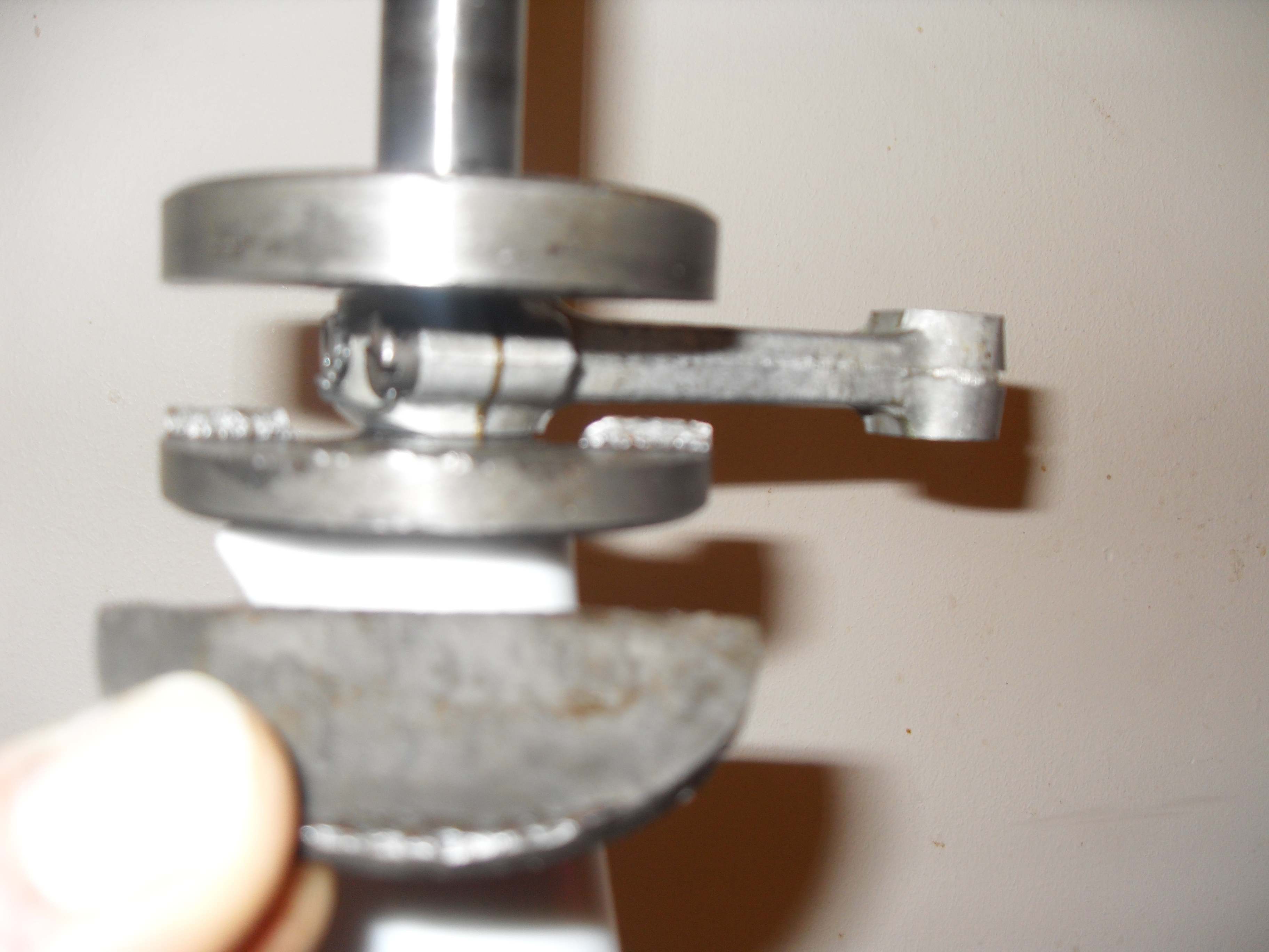

I've had a similar situation with an AC of mine where part of the counter weight on the crankshaft had separated and got stuck inside the hollow part of the piston. I try and get in the habit of turning the flywheels on my gulls by hand every once in a while, especially when they're in storage for months on end. I was doing exactly this when i came across a nasty CLUNK and the flywheel locked up. It was when i stripped the crankcases apart that i found this little bit of metal had got stuck inside the piston causing the lock up. It can happen i suppose with a lot of these 102's that havn't been kept in running order for months or even years on end. These balance weights are welded directly onto the crankshaft itself and over time corrosion sets in and weakens the weld.

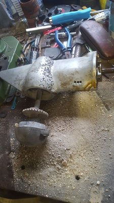

Hi pulled down the motor to see what is wrong and surprisingly enough everything came apart easily.
Then hang on a minute
everything is moving freely - in and out .

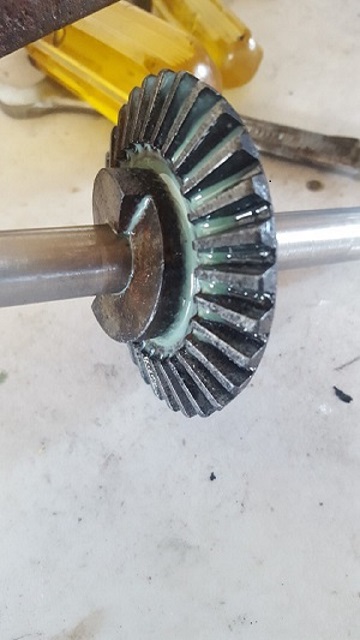

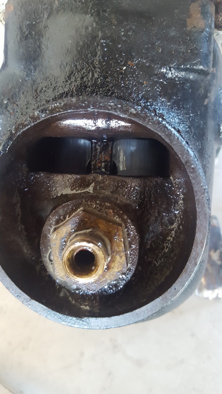

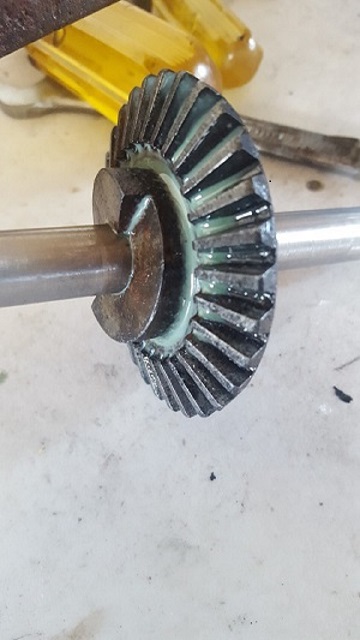

Whoops started at the wrong end. Anyhow, I then grab the gearbox and find it is the problem not the motor take it apart and there it is a stuffed pinion. I would have swore blind the noise was coming from the top of the outboard
something else I noticed is the crown gear looks like it is from a clutched gearbox and mine is direct drive. Is there a problem there? Are the pinion and crown gear the same ratio? Is that why it flogged out or was it already had it and me with my unlimited mechanical knowledge (not)
didn't see it when I cleaned the dry rubbish out of the gearbox and put oil in it etc. when I first got it. I have another question as well - the driveshaft appears to be bonded somehow to the vertical shaft at the gearbox near the water pump rotor probably rust. Would it be wise to use heat on the driveshaft to release it from the other or would that weaken the driveshaft material? Oh yeah

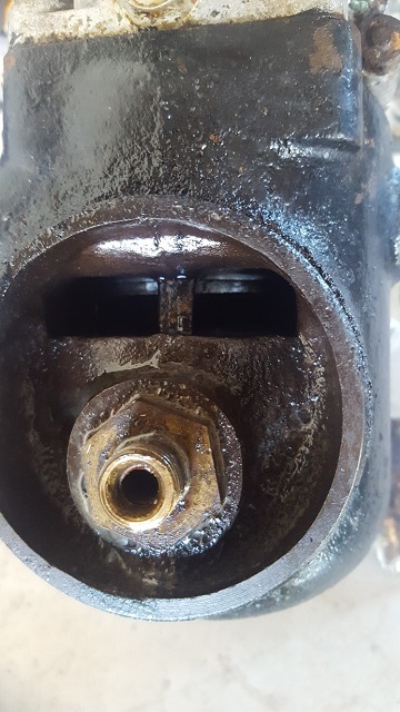

since I have it apart how do you clean the water jackets on a 102 I see a big screw on the side of the head has that got anything to do with it or do I separate the head from the crankcase? I really don't want to pay for a new head gasket if I can get away with it. Anyway I learnt a good lesson with this little escapade - start with things the motor is connected to first and work your way up to the motor.

Re: Sea Slug
AD use the the same crown gear for clutched and direct drives. I'm assuming there was a bit of end play ie in and out of the prop shaft which caused the gears not to mesh well. If this be the case the shim washer/s were worn (next to back plate).
Re: Sea Slug
Did you take the gearbox apart when you cleaned it out? Did you put the thrust washer/ shim back in? Has it got a thrust washer? if there is no washer, then that will more than likely be the cause of destruction!didn't see it when I cleaned the dry rubbish out of the gearbox and put oil in it etc.
- Posts: 4204
Re: Sea Slug
Oh Dear.
No lash adjustment/shim at all would do this.
Especially if the gearbox assy was a mixed up bag of others. That is why the choices of shims available.
Gear-set required I am afraid.................NUTS!
Soldier on regardless...........Ebay for another Box will be easier by far.

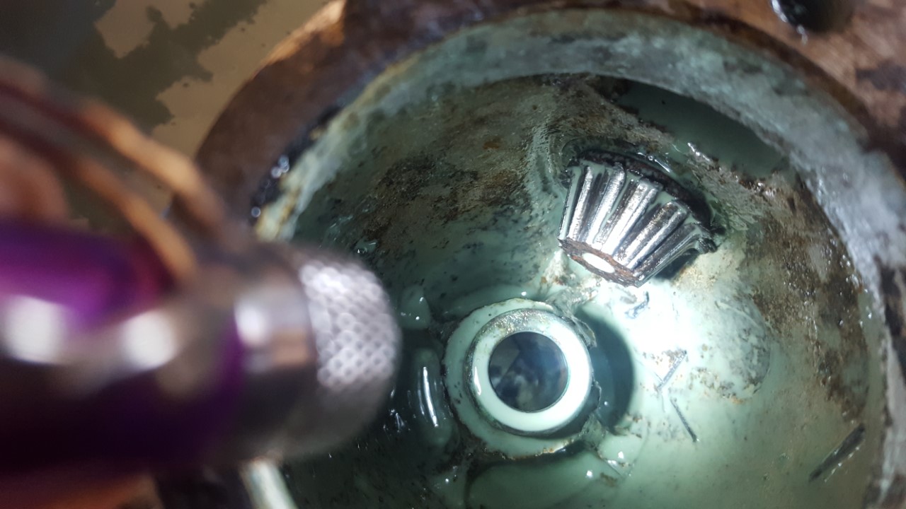

Re: Sea Slug
If your looking for an old 102 direct drive gearbox i might be able to help,
Post a picture of your box, and i will look in the seagull stuff.
I might cost you a hours drive south to Logan City, but it might get you fixed.

Re: Sea Slug

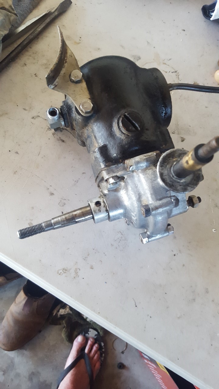

Hi THC thanks for the offer to help a different gearbox to suit will save a lot of work that's for sure. This is a photo of the gearbox when I first pulled if apart when I got the motor in September lots of rubbish inside it then. I'd appreciate it if you have a look at what you've got and maybe find something similar. A drive to Logan is far easier than getting one online that's for sure.
Re: Sea Slug
This is a perfect example of what can happen if the meshing of the crown wheel & pinion is not set correctly, by adjusting the thrust washer thickness.
It can also be caused by changing the propshaft for another used one with different wear patterns on the crown wheel gear teeth.
This box is now beyond economic repair, as it probably needs a pinion shaft, pinion bearing, gasket, prop shaft, crown wheel, two prop shaft bearings & 3 or 4 various thickness thrust washers, getting on for £200 in new parts, at a guess.
The moral of this story is, if you can hear any noise from the lower unit other than exhaust noise, it could be the funeral march!
