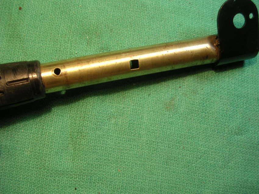

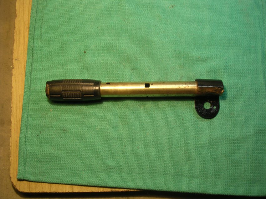

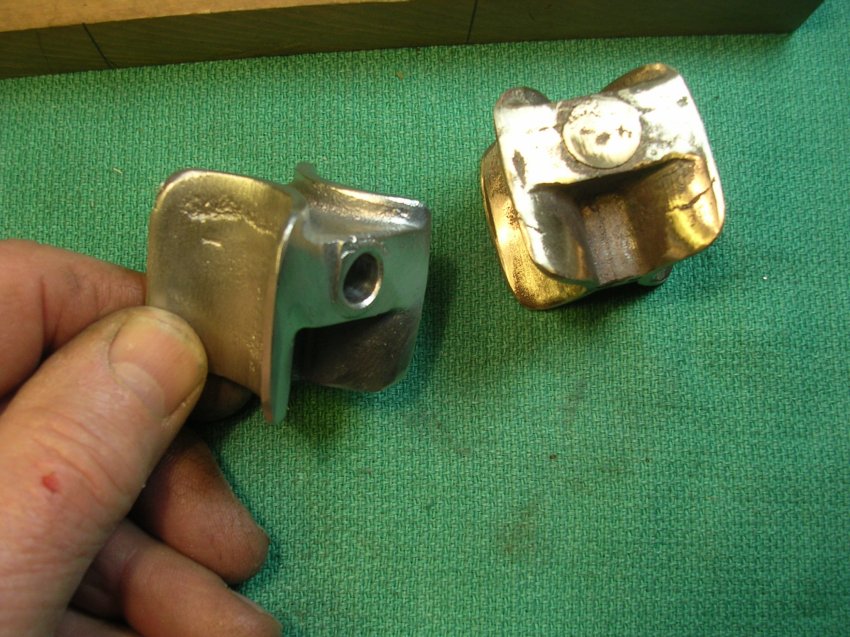

I have a tiller for an LS that has a couple square holes and small round ones at 90 degrees from the square. What were those holes for? Had they to do with the throttle lever bracket? Were thrust blocks for LS Aluminum or Bronze, or still the cotton spool black plastic? It is winter here.

Never seen those holes in a tiller before .....
L.s thrust block mine are black plastic same shape as in your picture..

Thrust blocks are plastic not aluminium and pretty common, not see square in a tiller before, a modification I suspect.
Old style are like this.

I've seen no end of various holes in 102 tillers before now. It seems the "spanner monkeys" get everywhere!
I had thought that some of these holes might have been drilled for a tiller extension of some description, or for a different type of throttle lever.
Either way i don't like to see any extra holes. (i like my seagulls to look as they have have done work in the past without any unnecessary modifications, slightly distressed and weathered looking,but tidy with it)
I'm sure if you ask Jeremy he will have his ideas on the matter.
BTW my early LS (18849) has cotton reel thrust blocks, and both my later LS's (35744,36688) have the plastic (reversible) type. All 3 are on Jeremy's list. Whether this is correct or not i have absolutely no idea.Sorry...
shh.. I think Jeremy might have some aluminium thrust blocks as well, both cotton reel and reversible type.

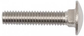

Is it a square hole on both sides or square on one and round on the other?
If it is suqare on one round on the other, I would say it has had a coach bolt in it for a tiller extension.

The are two same square holes opposite each other, and two 1/8 ( aprox 4.25 mm) holes at 90 deg. from the square ones and in line with the square ones. The grip is permanently fixed on and it is one of the ones with the name on "Dover" or ?? Cant remember. Interesting what Bodgers do. WB

God only knows what might have happened to your tiller through the mists of time. Tiller extension maybe? I must have seen around 20 different 102 tillers over the past 5 or so years with strange "extra" holes in them. It seems it happens on the smaller motors too. Spanner monkeys as i call 'em
The "DOVER" grip you mention is absolutely correct for an LS. DO NOT try to remove it or you could end up screwing it up.
I'd try and concentrate on filling the holes with something, then paint the tiller black. (remember the FV isn't painted, but the larger LS is painted)
Apart from that it's all looking good.

Wonder if you could TIG the hole up without getting the grip too hot.
Put the grip in a bucket of water while the job is being done?
