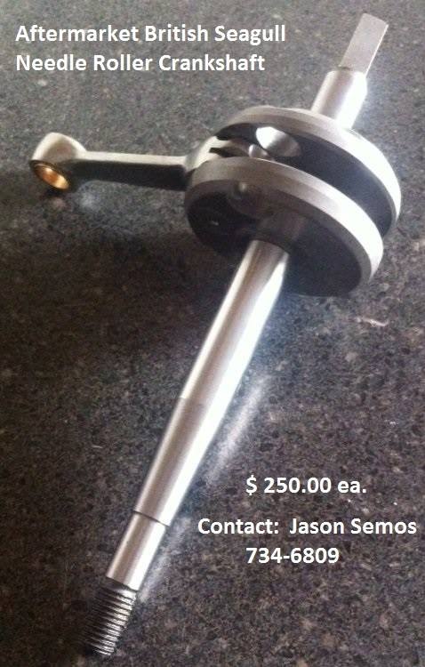

I see on the seagull facebook page that new roller bearing cranks are now available in Bermuda. The later seagulls with roller bearings have pressed in big end pins, and needle roller big end bearings, the replacements have a lot more meat around the hole the big end pin presses into. I understand the later cranks were prone to corrosion around the lower seal too.
Nice bit of re-manufacturing 8)

You will also note that the Bermudian racer marketplace gets the chance first.
NOW AVAILABLE:
Aftermarket British Seagull needle roller crankshaft - $250.00 ea.
These are replacements for the (no longer available) needle roller crankshafts that were factory fitted to Kingfisher, Osprey and Curlew models.
They are designed to be more robust than the originals, having more material around the big end pin and therefore a slightly larger overall diameter. As a result, some material will need to be removed from the crankcase halves to enable fitting. The amount needed to be removed varies from model to model and also depending on the year of casting.
As a specifically British Seagull aftermarket part, that is reasonably priced and commercially available to all, these crankshafts are recognized by the 'Round the Island Seagull Race as legitimate Seagull replacement parts under the rules, allowing them to be used in old/new motor and stock/modified classes.
There is a limited stock, so they are being offered to the Bermuda market first. Contact Jason Semos @ 734 6809

One thing I would like to ask as an interested observer on the the seagull racing scene. If I was to fit this part to a stock century (LLS or similar) Is there an advantage over the standard seagull crank? If so should this be classed as a modified engine rather than stock class?
Another thing to note is that standard century cranks are available from British Seagull (Or from SOS) A lot cheaper and no machining of the crankcases required either...
http://www.sheridanmarine.com/product/b ... rankshafts
Also if this crank was fitted to a stock kingfisher it would allow the engine be set up to rev higher, so would this give an unfair advantage in the stock class v a guy with a standard crank that won't rev so high without letting go?

Re your crank, its a nice bit of work, and I would suggest that the committee approves it as a new for old replacement for needle roller engines, as it will give longevity going forward which will help keep the scene going.
However I don't think it should be allowed as a stock replacement on a century, as it gives an advantage both in RPMs the engine can handle and the bigger crank will give more crankcase compression and thus a performance gain? Plus correct stock parts are available for century engines from Seagull. I'd suggest that fitting this new crank into a century should mean the engine moves into modified.
