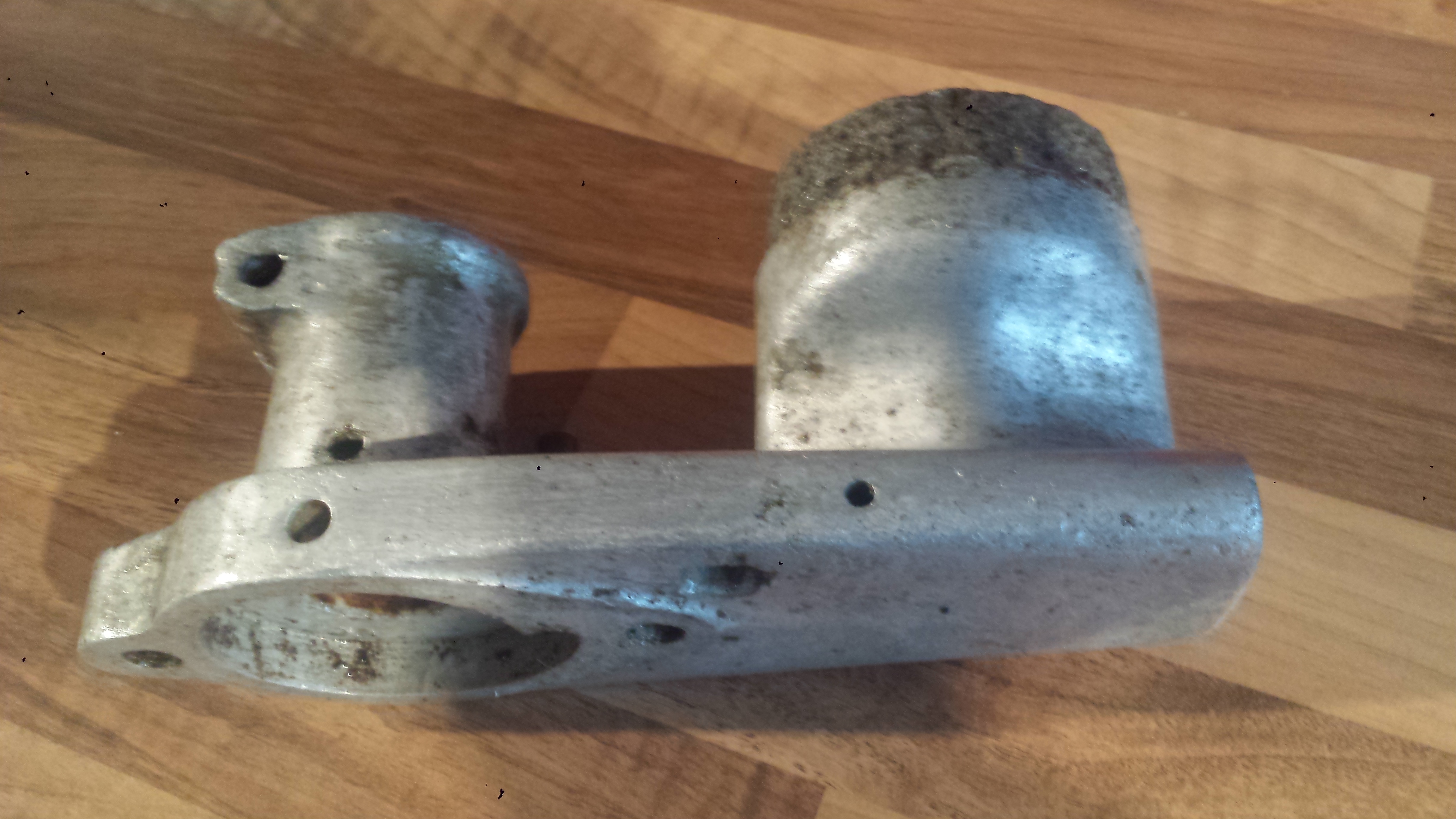

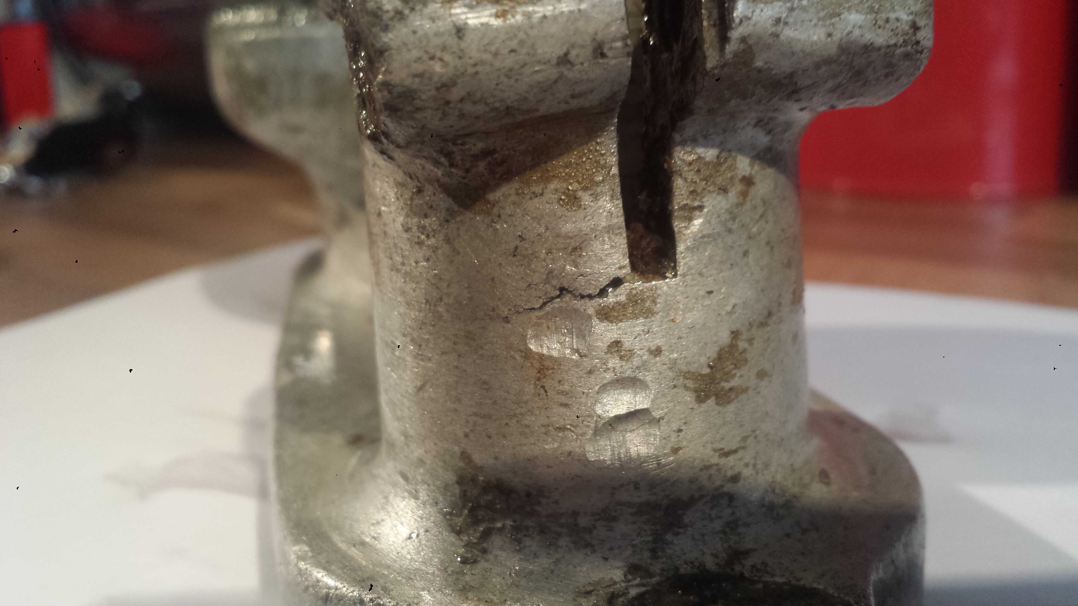

Looks like the last owner gave it a skelp can/or is it worth fixing...
Re: water pump housing
That could be repaired, by welding and then dressing back carefully. Finally it could be vapour blasted and the repair would not be visable. However it will cost a bit to get it welded.
