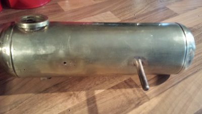

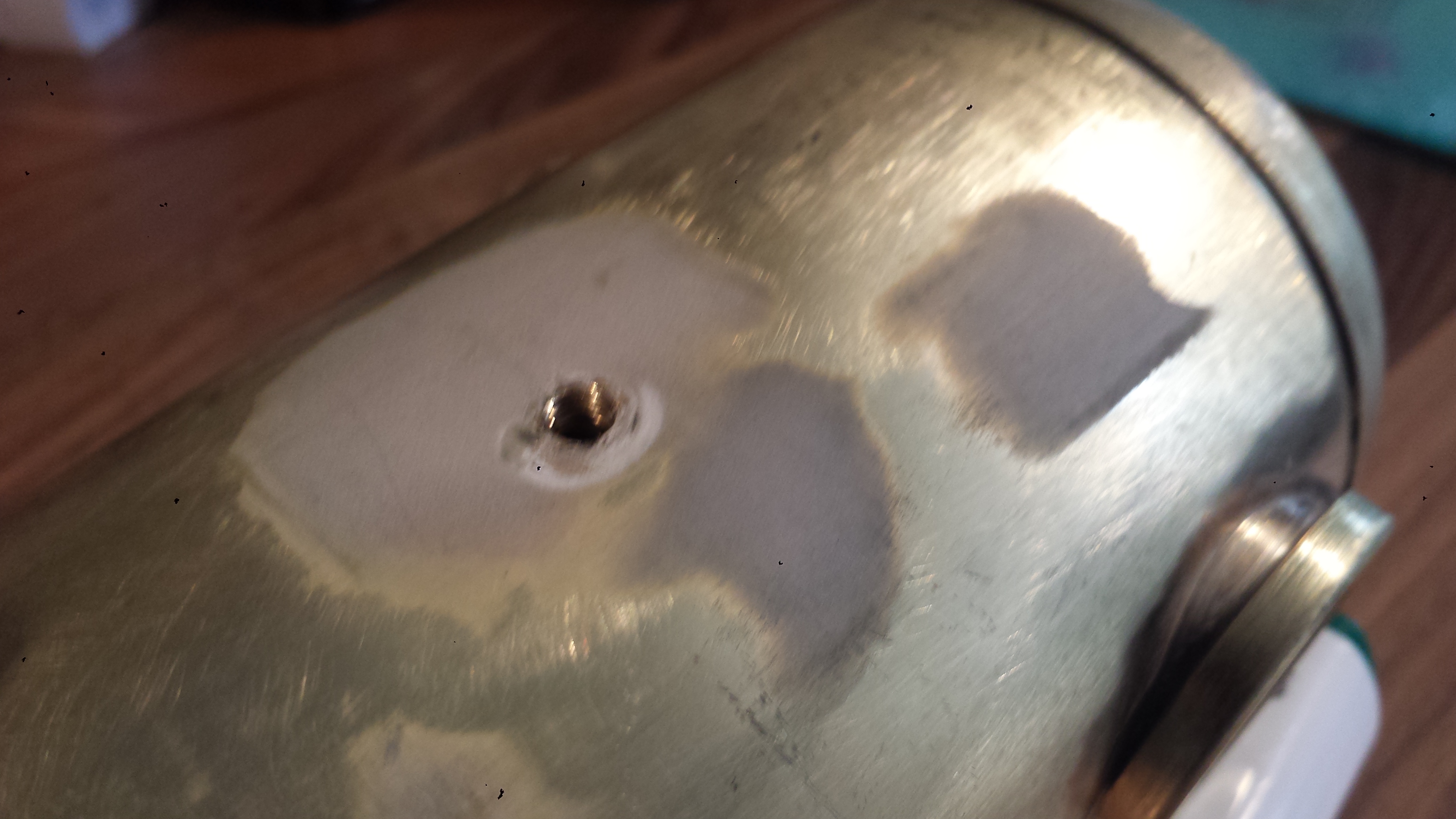

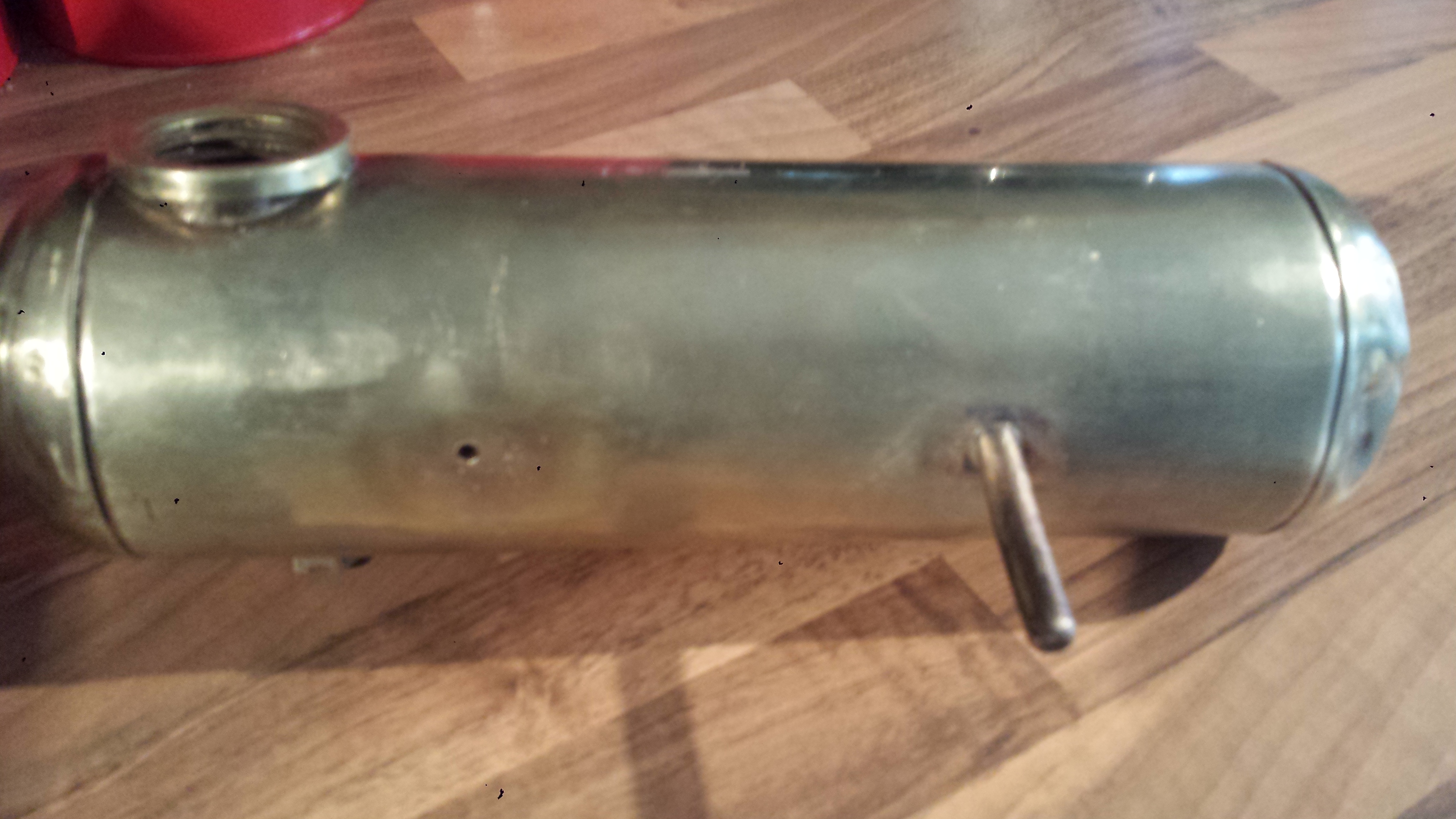

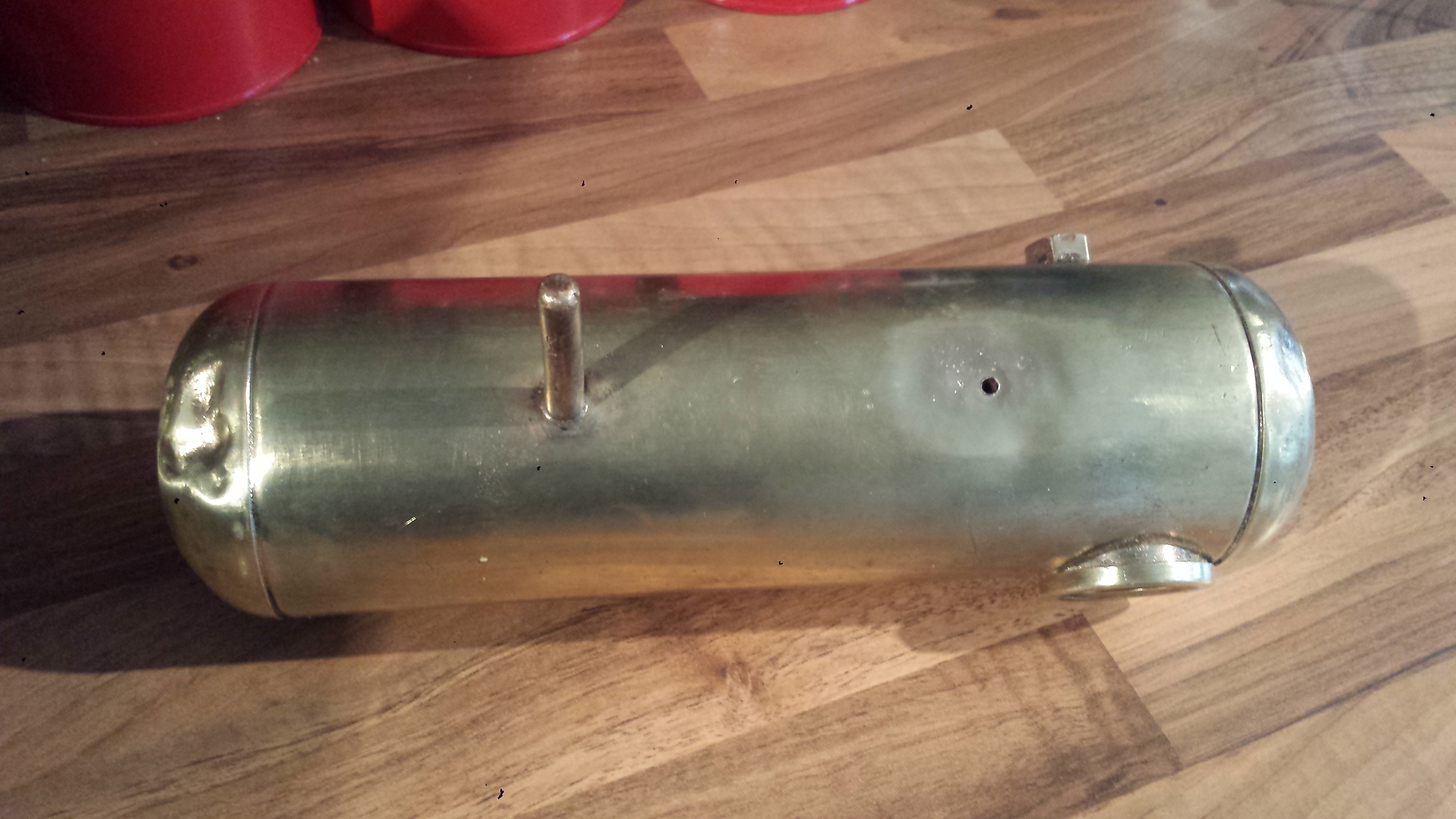

Nudge wrote:Are you going to drill and pin a part on it, Or take the tank apart and replace the part?
Looks like that could be a plan the stub fell away as soon as heat was applied (been repaired before) back to the drawing board drilled pinned then soldered :roll:

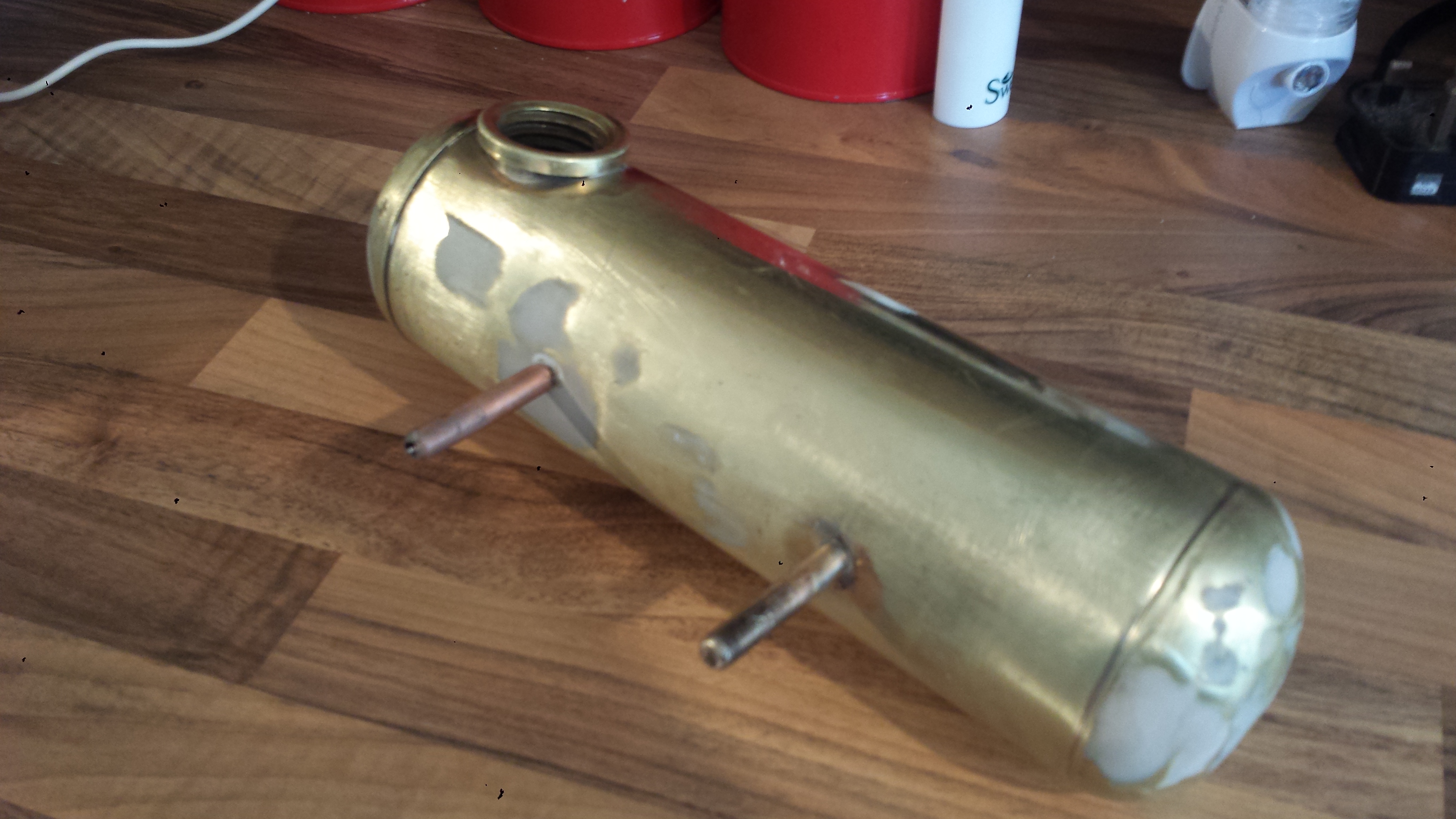

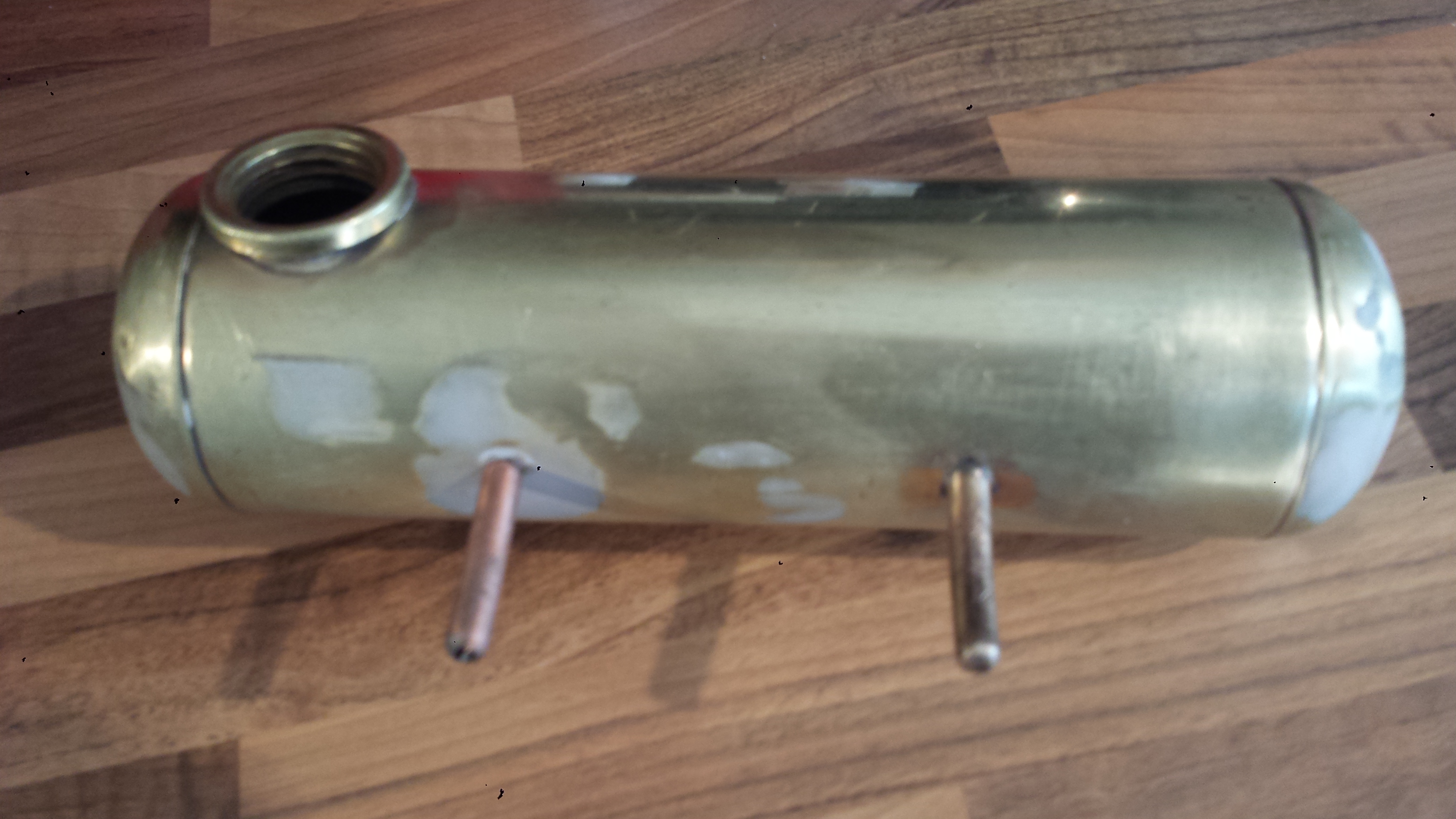

Re: fvp7089
Much better now. :lol:
Re: fvp7089

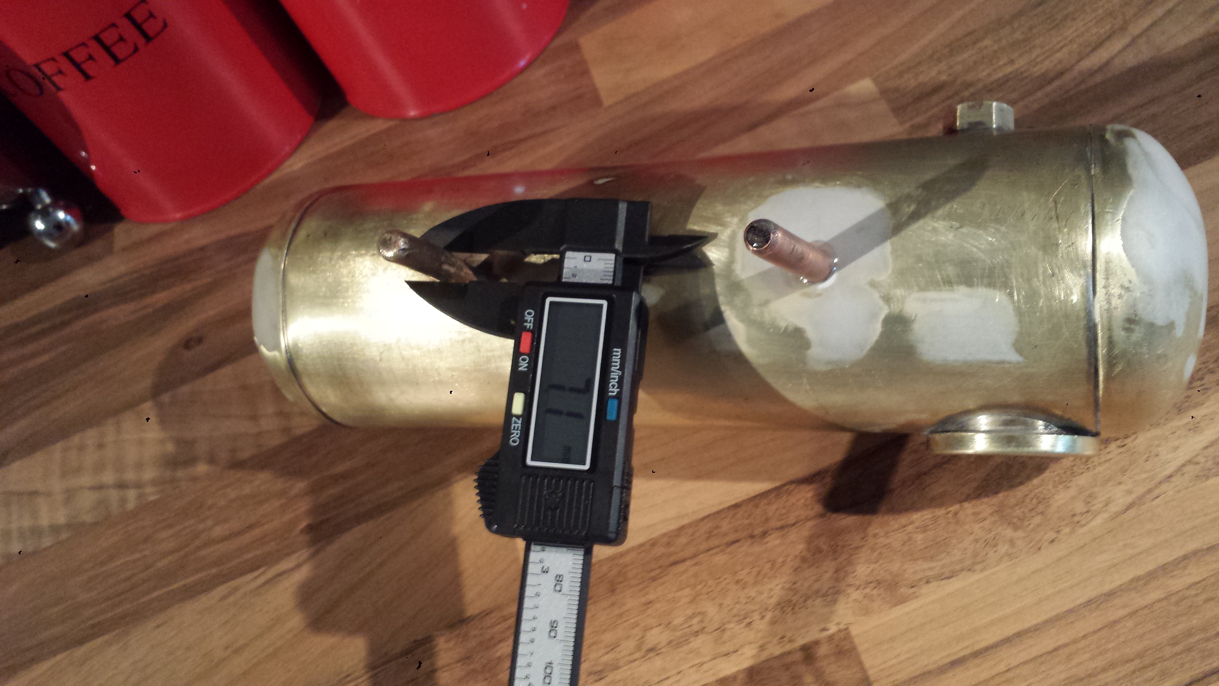

That looks a lot better! just a shame your you don't have a piece of brass to replace the pin. Is there anybody close that may have a piece of brass rod the correct diameter.
Re: fvp7089
I suspect once its primed and painted, who will know what its made of.
Ok I will, but I won't tell. :P
Re: fvp7089

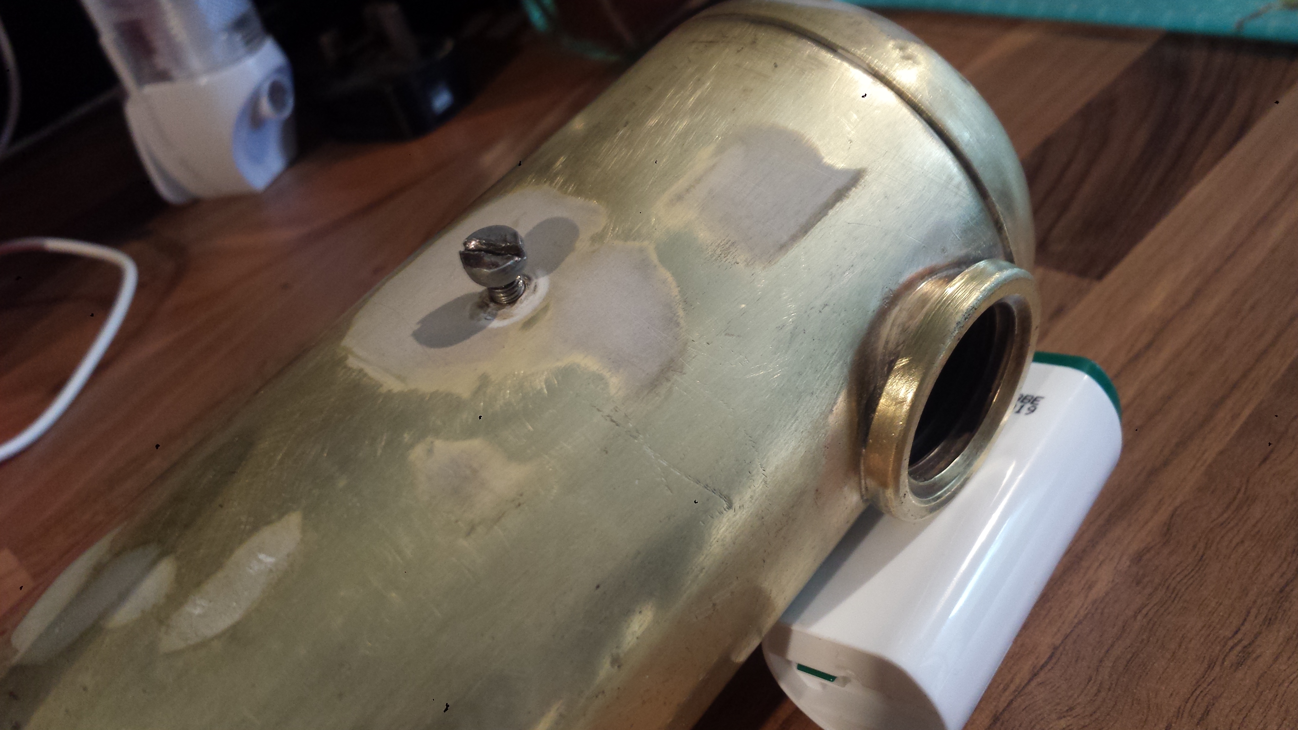

Drilled a hole through existing internal rod threaded to suit small screw that came from top end of 40+exhust soldered that to an old piece of 40+ water pipe then filled cooper pipe with solder and just screwed it on with some lock tight prim and paint. The jobs a good yin...aye learning. :lol:

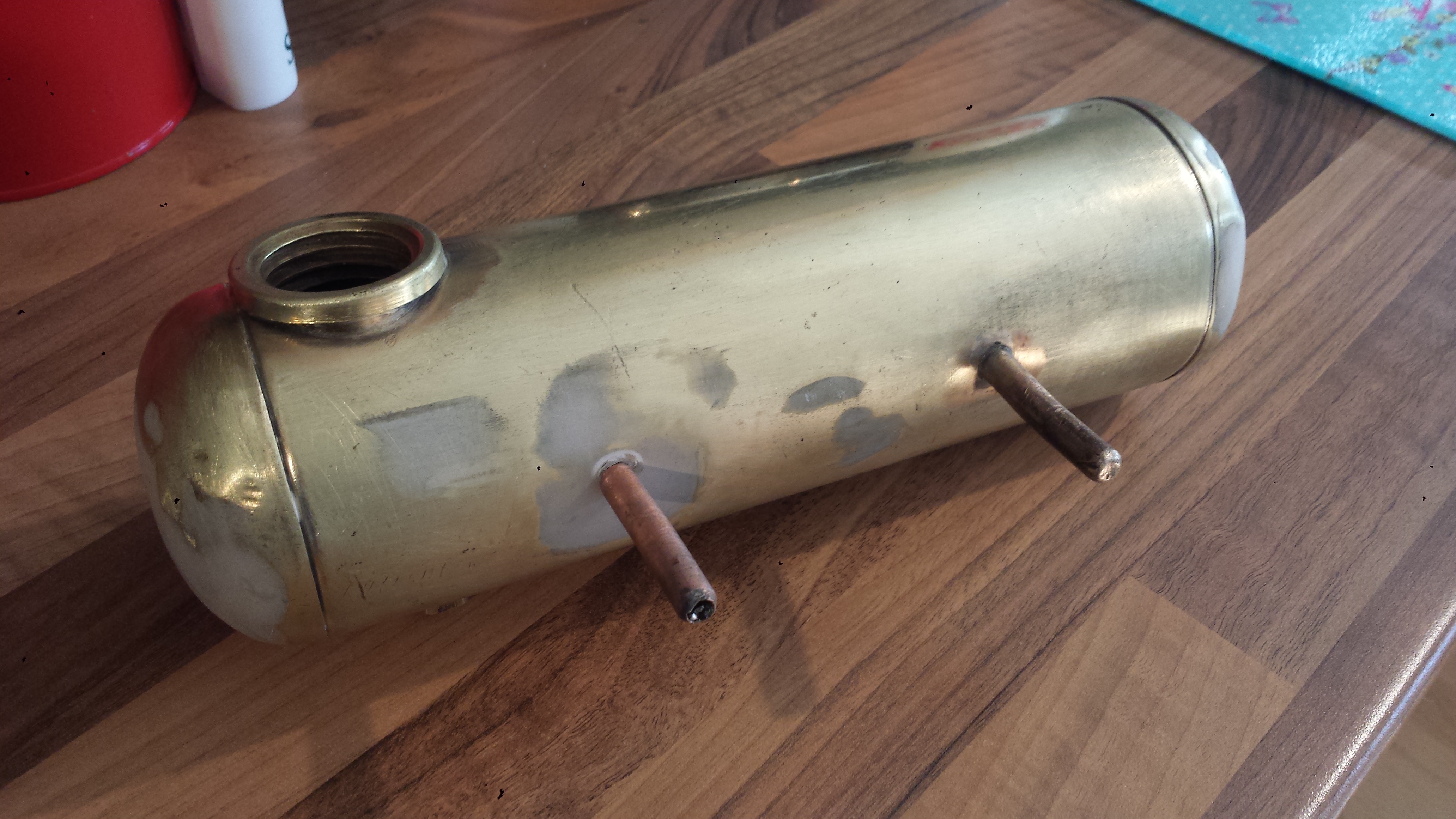

Very nice job you're doing there Tam! Looking beautiful. I've got my FV15425 to do at some point, so great reading. Liked your use of the bench grinder.. may give that a go! What did you use for tight corners on the crankcase? Brass wire end brush?
Re: fvp7089
Cheers china i use a wire wheel then a dremel or similar for
tight areas finished with cotton buds dipped in autosol then plenty of patients :lol:

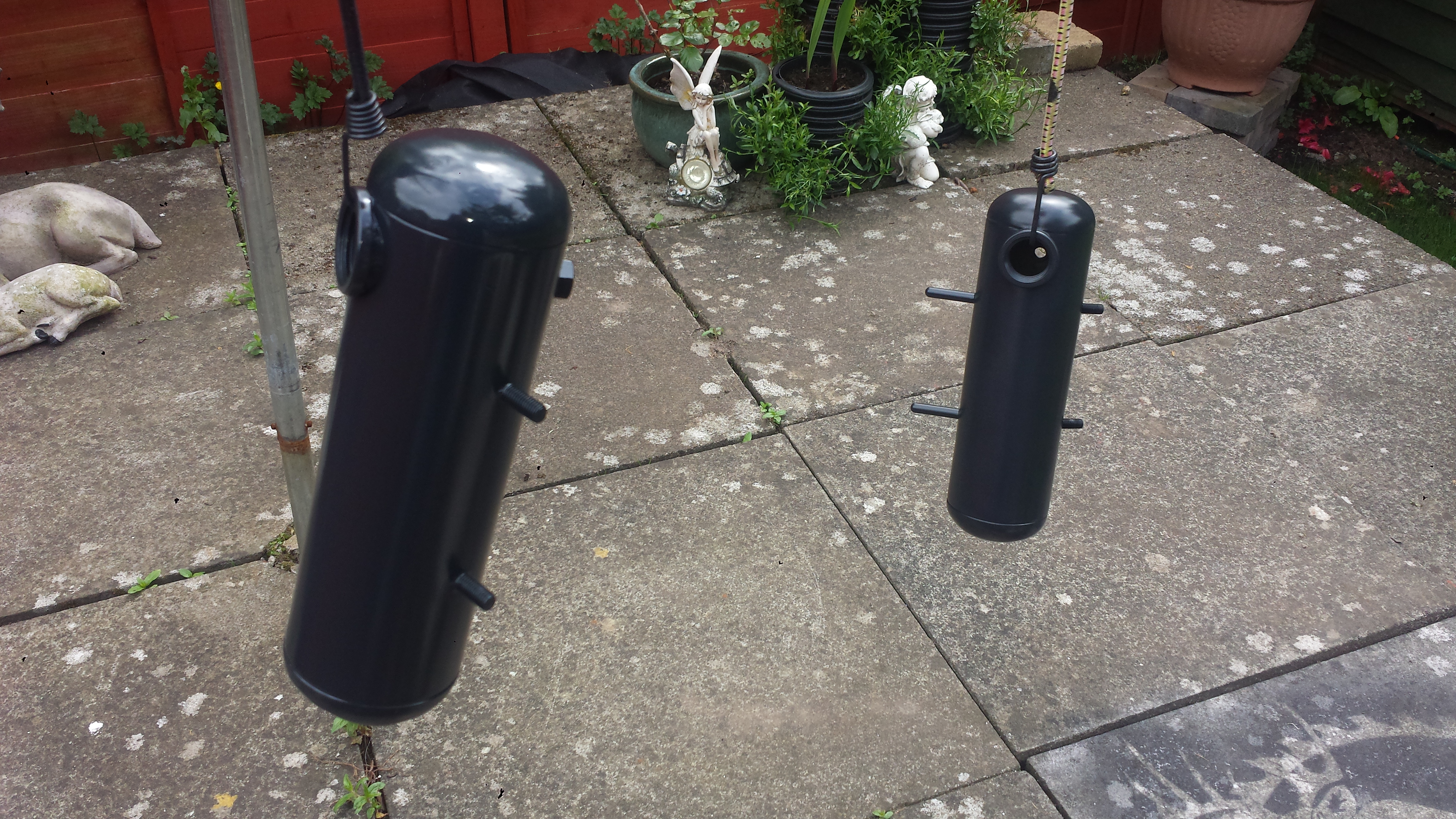

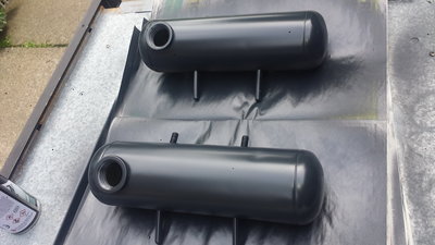

Tam they look amazing
