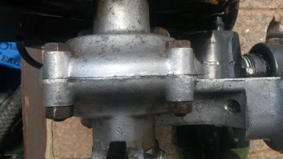

Finally got to use my Featherweight after all the tests in a bucket !
All was going great, having a wonderful time cruising on Ullswater, hoping to make the campsite in good time, then disaster :x
Now sorry in advance for my lack of engineering know how and jargon but the water stopped flowing out of the little hole on the engine block. I let it cool down and tried again and as before the water flowed at the start, but as the engine heated up it stopped again. I also noticed two stroke leaking from here:
and a little gearbox oil from here:
(Just below the serial No.)
I have flushed the system with a hose and all seems clear. Am I correct in assuming that these small leaks are the cause of the problem, and that I will have to replace the gaskets, and is it a difficult job ?

Re: Pleasure & Pain
I learned to sail in a mirror identical to that 8)
Anyway, it sounds like your water jacket could do with a clean out, take the tank off and apply some gentle heat to each of the 4 head bolts, then carefully take the bolts off. Take your time as they can shear. Once the head is off you can clean out the water passages using a thin screwdriver or the like. Make sure all the debris is removed, and reassemble. You might consider a new head gasket. Don't overtighten the bolts when you reassemble. Run it up again and see how it goes. Water flow does reduce down to nothing at Tick over on these engines so keep the revs up..
Also remember to keep your gearbox oil fresh. The box only holds a small amount on the featherweight. You will see the filler down next to the prop. Change it the oil at least twice each summer and again at the end of the season.
See how it goes and report back.

When I got my first seagull I had a similar problem, that when I was running the seagull in the barrel it was pumping water no problem with a good flow, but then when I got it out on the boat, it seemed to only flow for a few minutes before stopping altogether. I ended up stripping the outboard down and there was a load of crud blocking the water passages.
There is a also the water flow pipe inside the exhaust that could end up out of place. Perhaps the previous owner had it taken apart and didn't quite get it back in it's place properly. Give us a bit more detail about how long it was running properly for before the water flow stopped.
