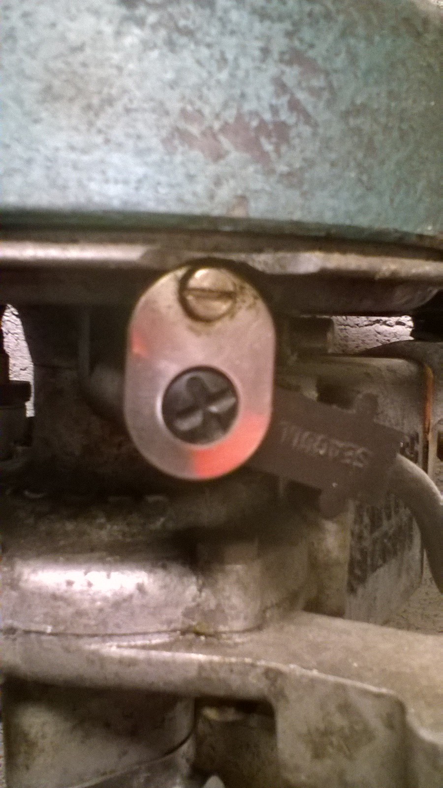

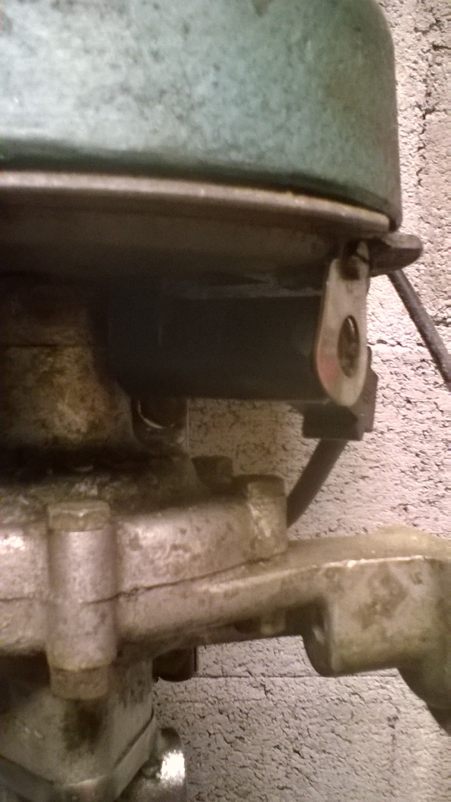

hairyjim wrote:Hi all.my newly acquired seagull is a century 100 model,engine No.. LLS 29111.where the ht lead plugs into the stator is a Very Loose fit.he thinks there should be some sort of plate? for the spring on the iead to butt against???.
...but in the mean time if anyone can shed some light on the ht lead connection system i would be very grateful. Cheers for reading..byeee
These pictures may be of some use to you.
Re: New member
Would it not have a Villiers ignition, Manufacture Date: 1961 to 1962.
pat777
Posts: 333
Location: Ireland
Re: New member
Post by pat777 »
Keith.P wrote:Would it not have a Villiers ignition, Manufacture Date: 1961 to 1962.
Quite possibly, I didn't look up the engine code before I posted the pictures...
I was just posting the pictures to show the missing "plate", so does the Villiers ignition have a "plate"?

http://www.saving-old-seagulls.co.uk/i_ ... series.htm
Here is a picture from SOS main site, showing century with villiers ignition, with lead held in place with steel wire.
Re: New member
There are grooves in the bakelite plug that the wire springy thingo locates onto.

Hi all.many thanks for the pics.my ignition is the Villiers as stated but having run the meter over it to discover it's lack of spark...its got a knackered coil.. This apears to be compounded by an attempt at fixing said spark issue by fiddling with the points and they have a short too.so looks like ile be needing a coil and points unit.is it worth me swapping the whole stator/rotor for a wipac system and updating or spend out on another engine and have a spare as a donor for future seagulls in the Avery.I think a flock is so much more sociable..
Re: New member
Remember that you have a condenser under the points box, that may give you bogus readings, wipac ignitions are more modern, I think you would have to change the flywheel as well if you change.
Its up to you, which way you go.
