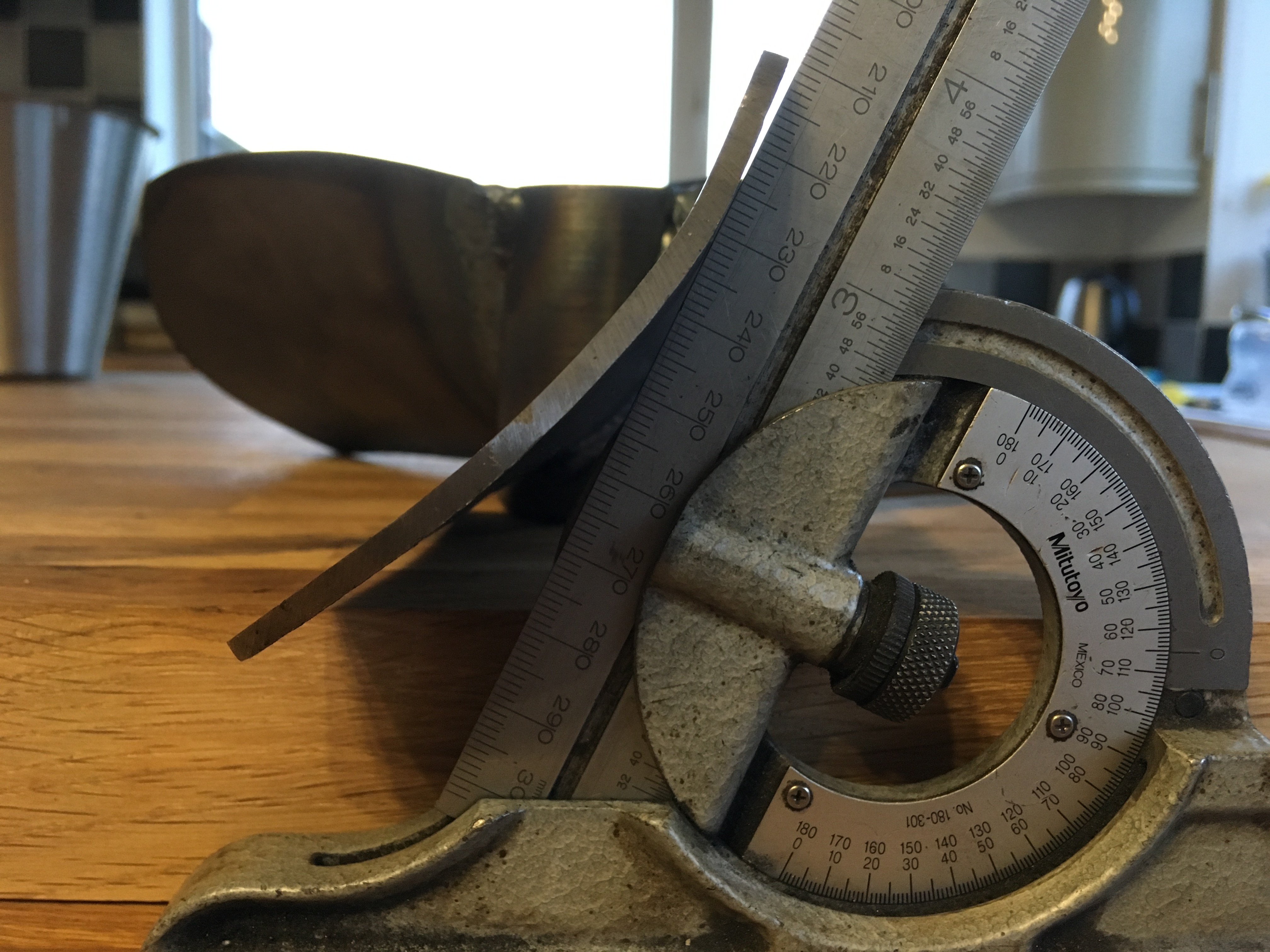

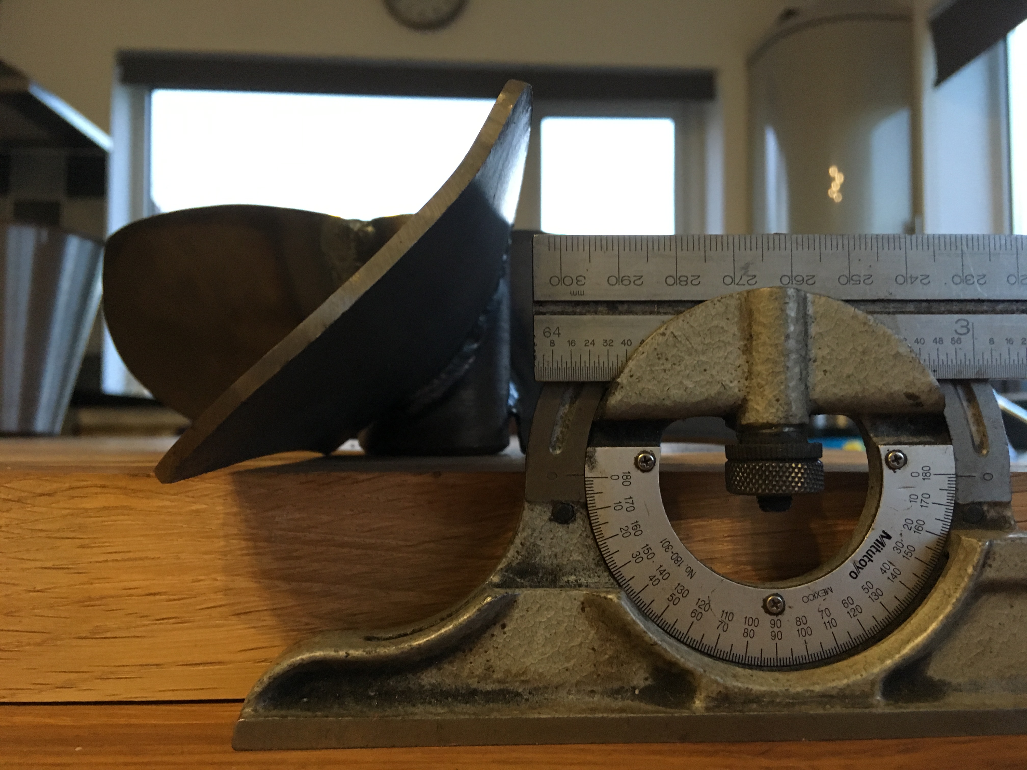

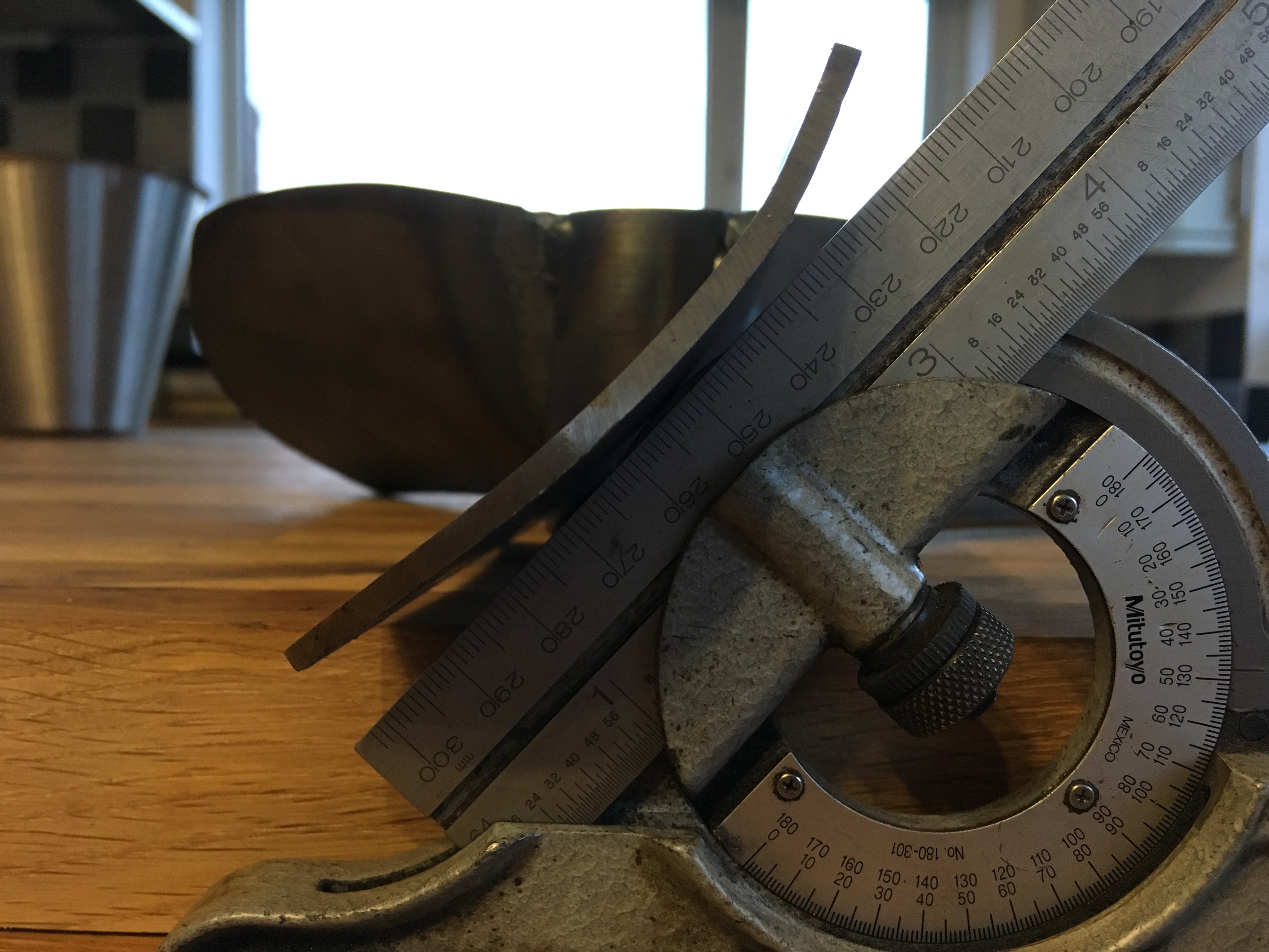

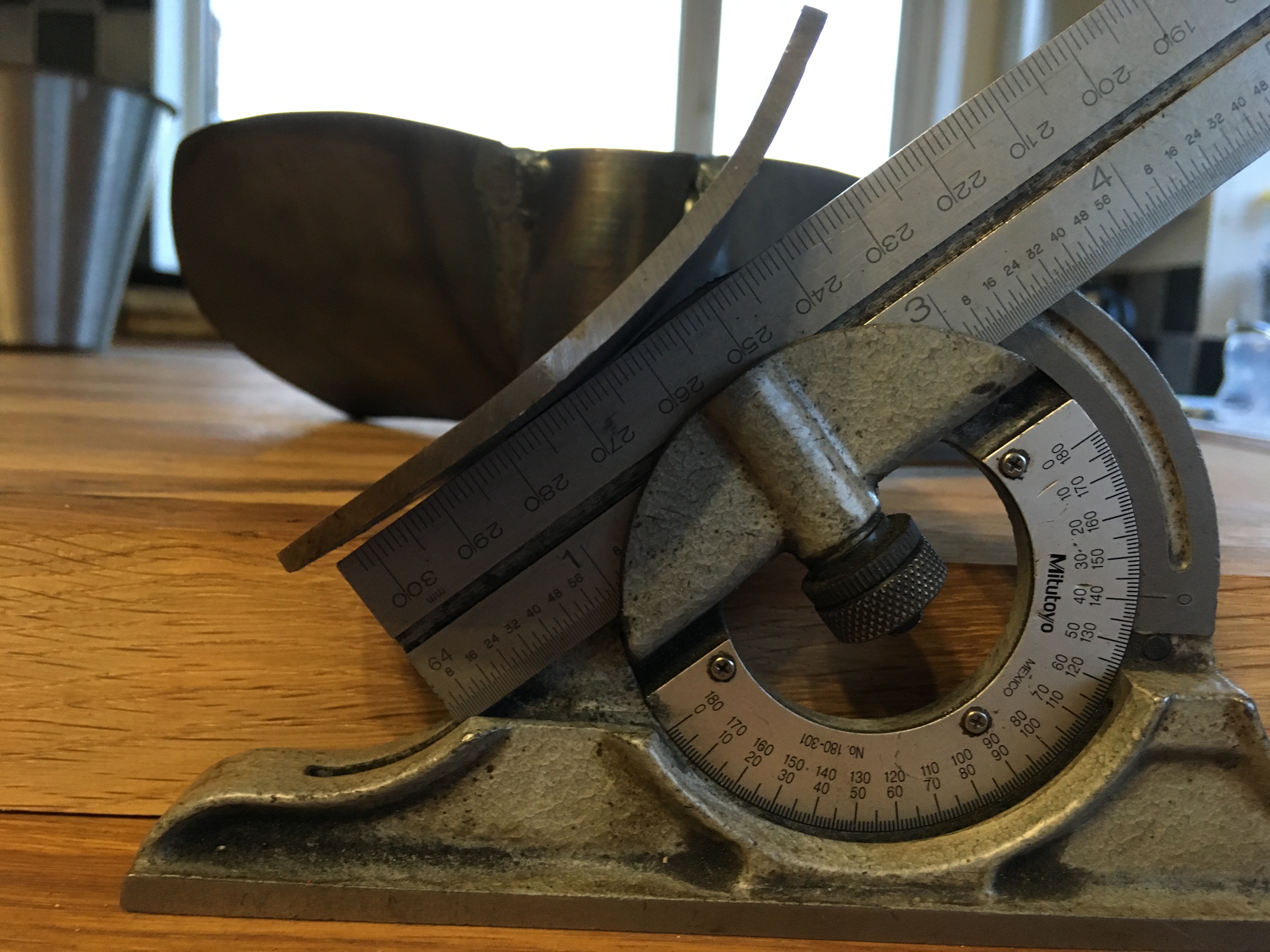

Some angles from my prop
65 deg
39 deg
so 42deg average

That would imply around 24" pitch, that equals almost 23 Mph at 4000 revs with zero prop slip, with a 4 : 1 lower unit.
It's easier to add pitch than to remove it!

24” ooops I might have over done it.
I might be going sideways rather than forwards

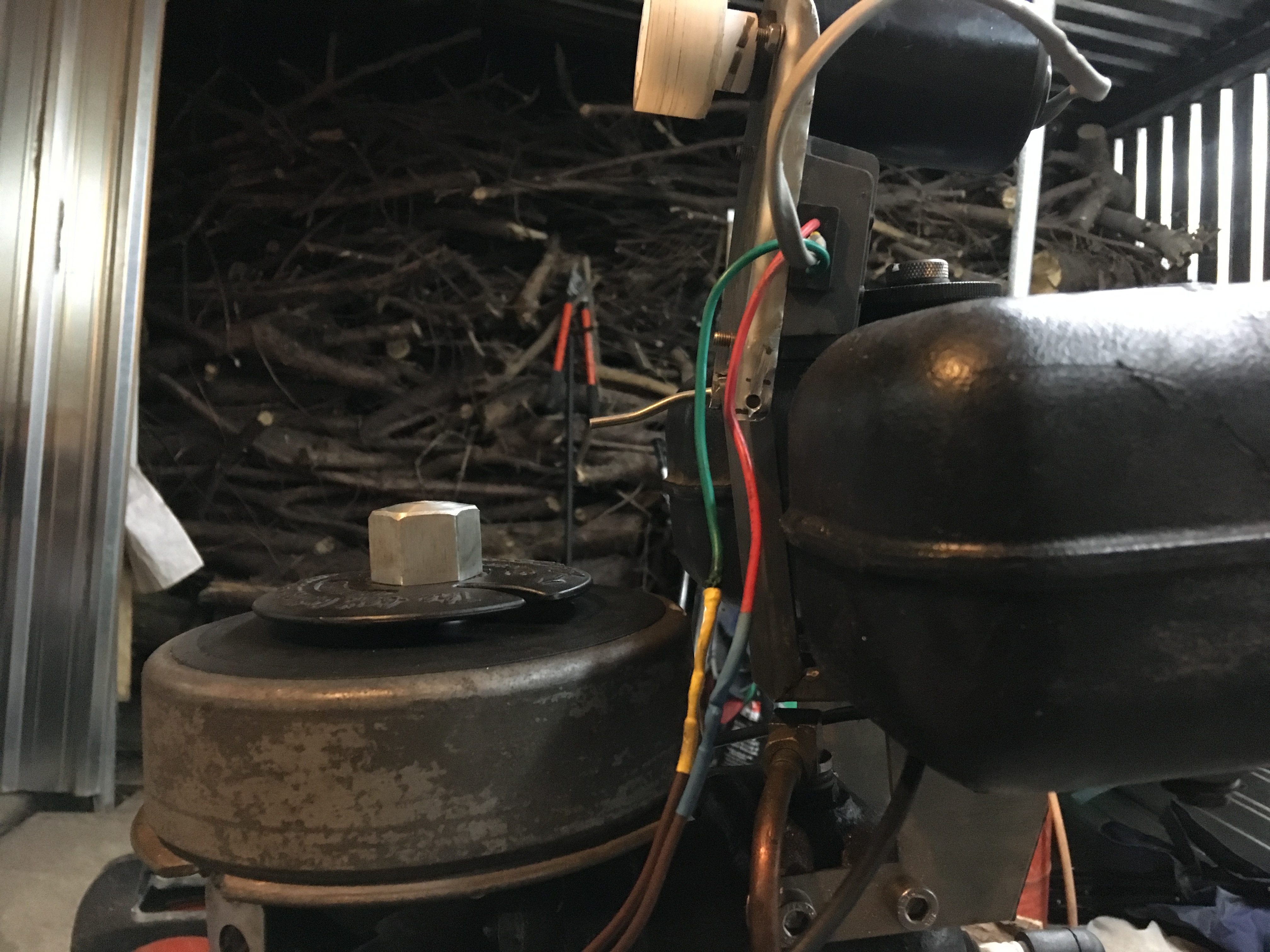

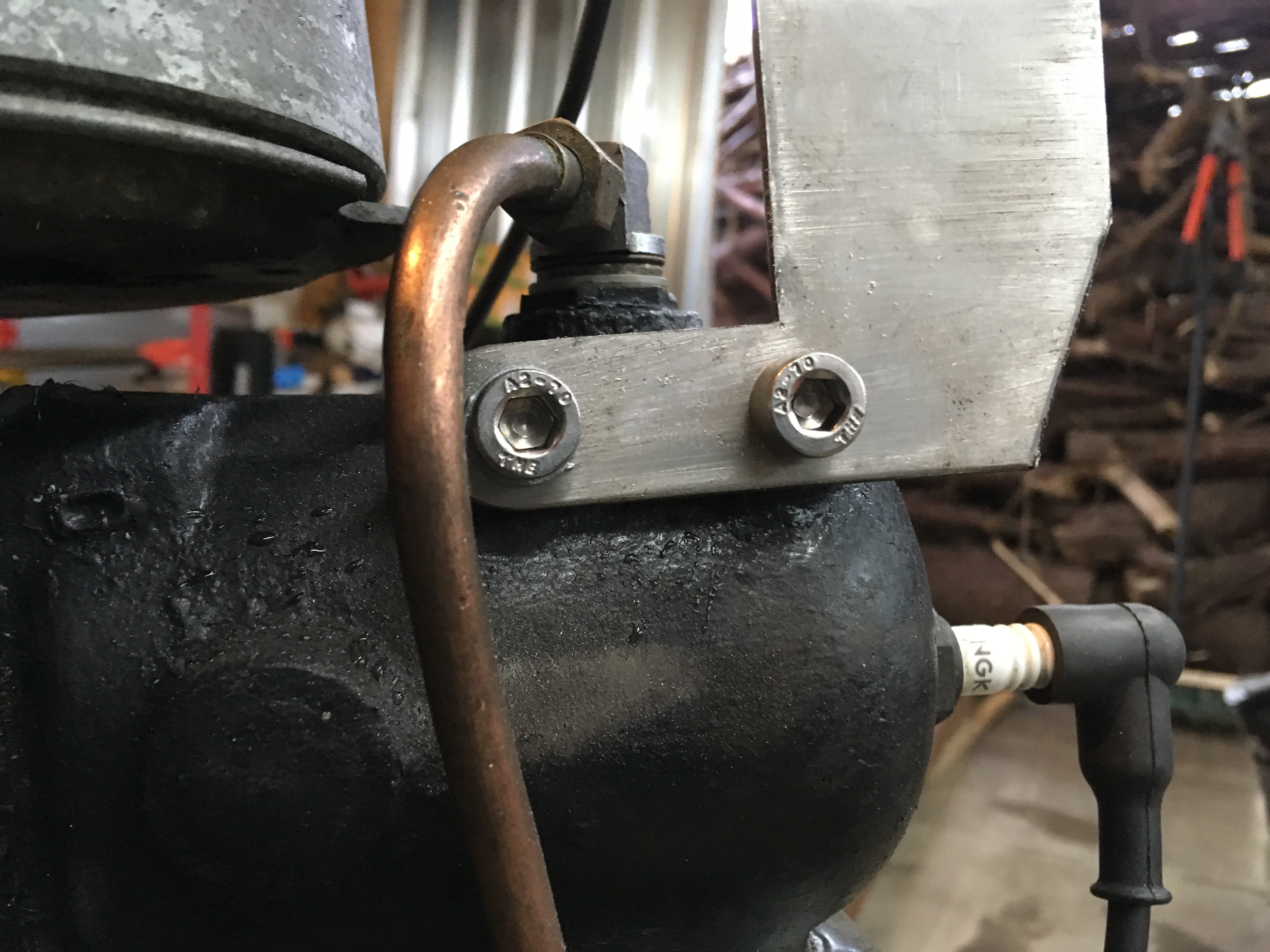

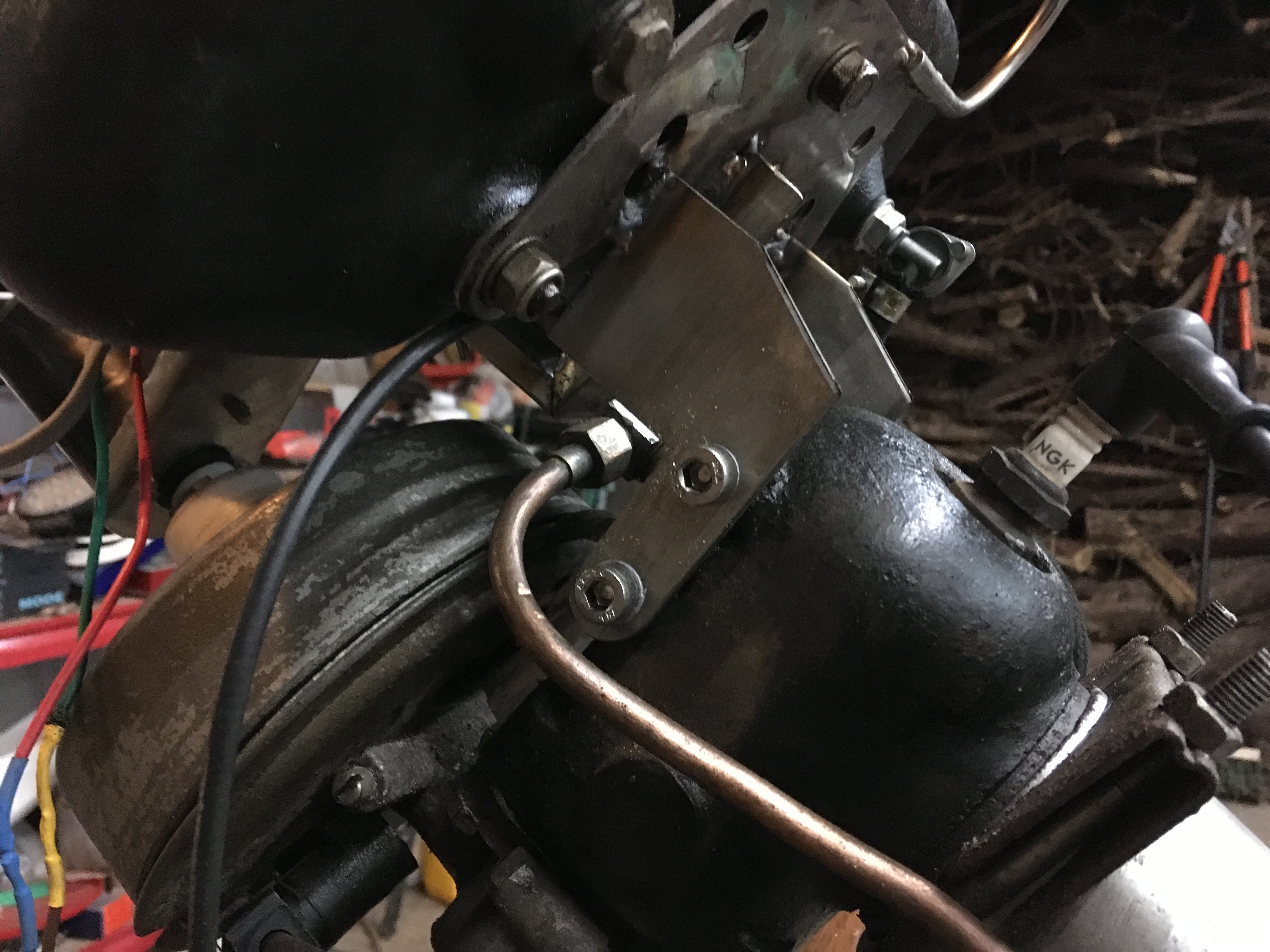

Found a minute and My fuel tank is mounted. with my alternator mount. Ready for a test run this weekend all being well
Re: Cracked waterjacket
I'm liking it :P
Flip up too, there's a novel idea. Is the nut on the flywheel a handmade job or is it repurposed from something else?
Nice job so far, thumbs up from me.

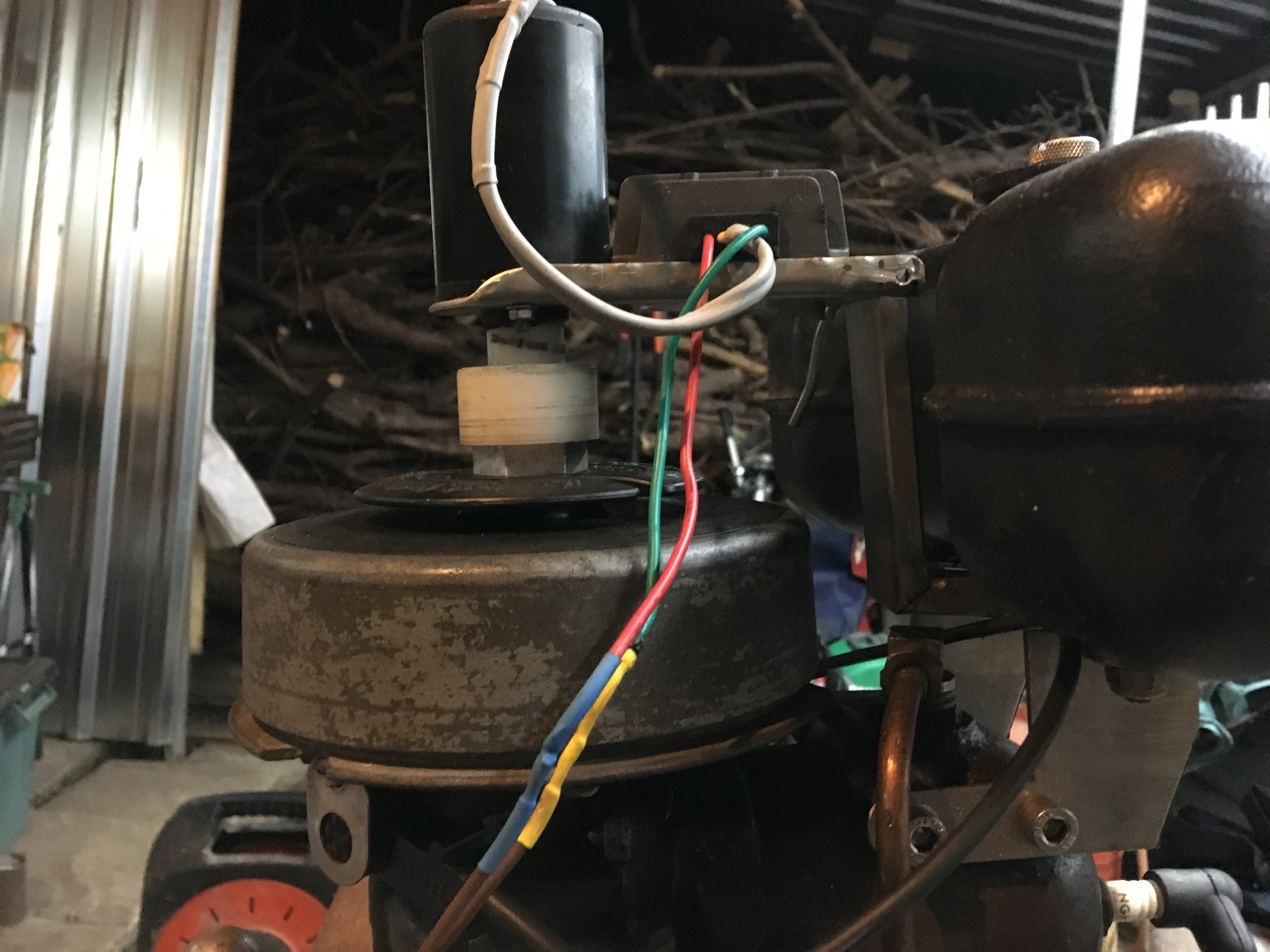

Many years ago as a young sea scout I rigged a push bike dynamo onto a seagull flywheel. Worked a treat!

Homemade 30mm af nut. So that it was the same as my LLS engine. Hopefully this motor and regulator should put out enough power to keep my small coolbox running. Keep the beers cold while were out and about.

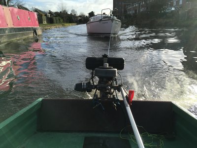

IT LIVES. woo ha ha ha
Second pull stood in a bucket with a flash light in my mouth.
Couldnt wait till i got down to the water to find out if it was gona start.
Post by Liam2k3 »
Not with the homemade prop yet. Still tinkering. But the bitsa runs great. Towed my new boat 12miles home at the weekend with the bitsa on the dilligaf dinghy. Never missed a beat all the way.
