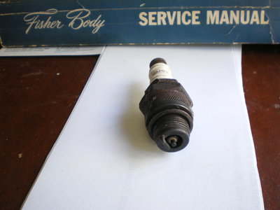

Re: Strange Spark Plug find
I took a quick pic and though it is fuzzy, it may help others know what that plug looks like.
- Posts: 11
- Joined: Mon Jun 10, 2013 7:19 pm
- Location: California, USA
Apparently a fairly common spark plug back in its day.
A lot of my older 102's have this same type of spark plug, along with the pink coloured Lodge equivalent.

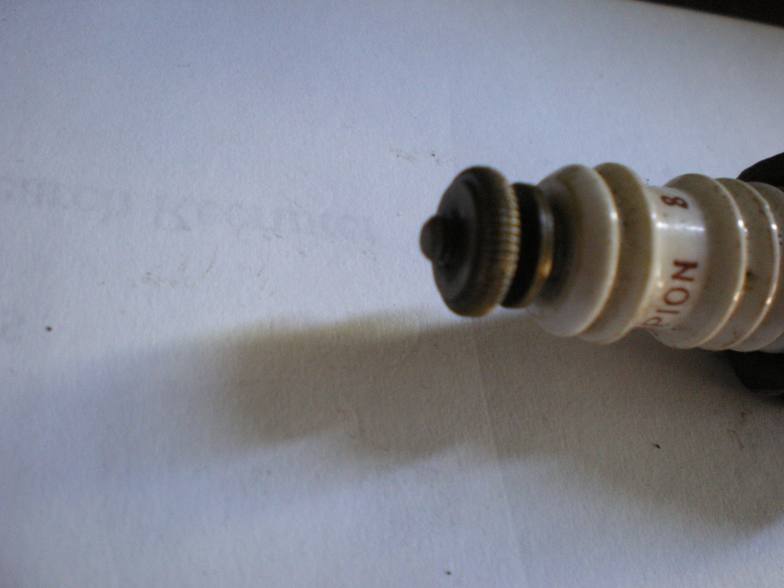

Yup, left click to expand.
Nice knurled top. The Fisher Body manual Captain Dave you may feel more at home with. 472ci of iron

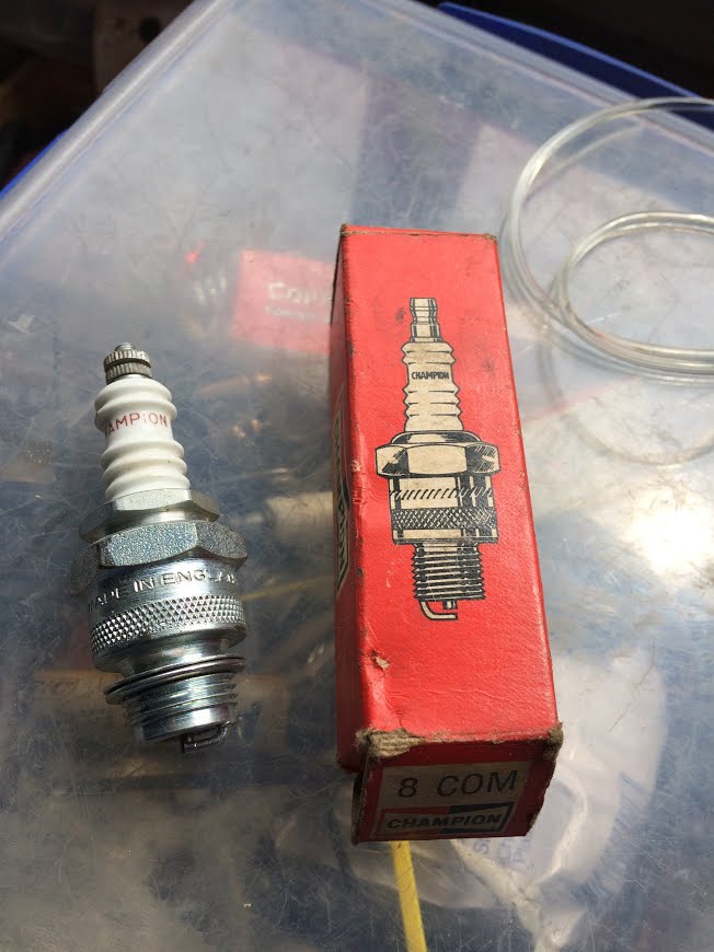

I have a new one in a box, also have 2 lodge C3's i also have one of those knurled tops in the spares bag for my SD.
- Attachments
- sd bits 5.JPG (19.58 KiB) Viewed 3317 times
I have a good collection of original unused spark plugs, I use original plugs that would have been in the motor at the time, I have never used a modern equivalent, I mostly use Lodge and champion, plus I have others like KLG Lissen and I have only ever had a problem with one and it was a more modern Lodge one piece 14mm spark plug.
None of my plugs are crap returns, they are original unused stock, saying NOS plugs are rubbish, maybe your experience, but definitely not mine.
Whiskering was caused by the oil used at the time, that's why decokeing was also so common in the past, you don't see that now using modern oils.
