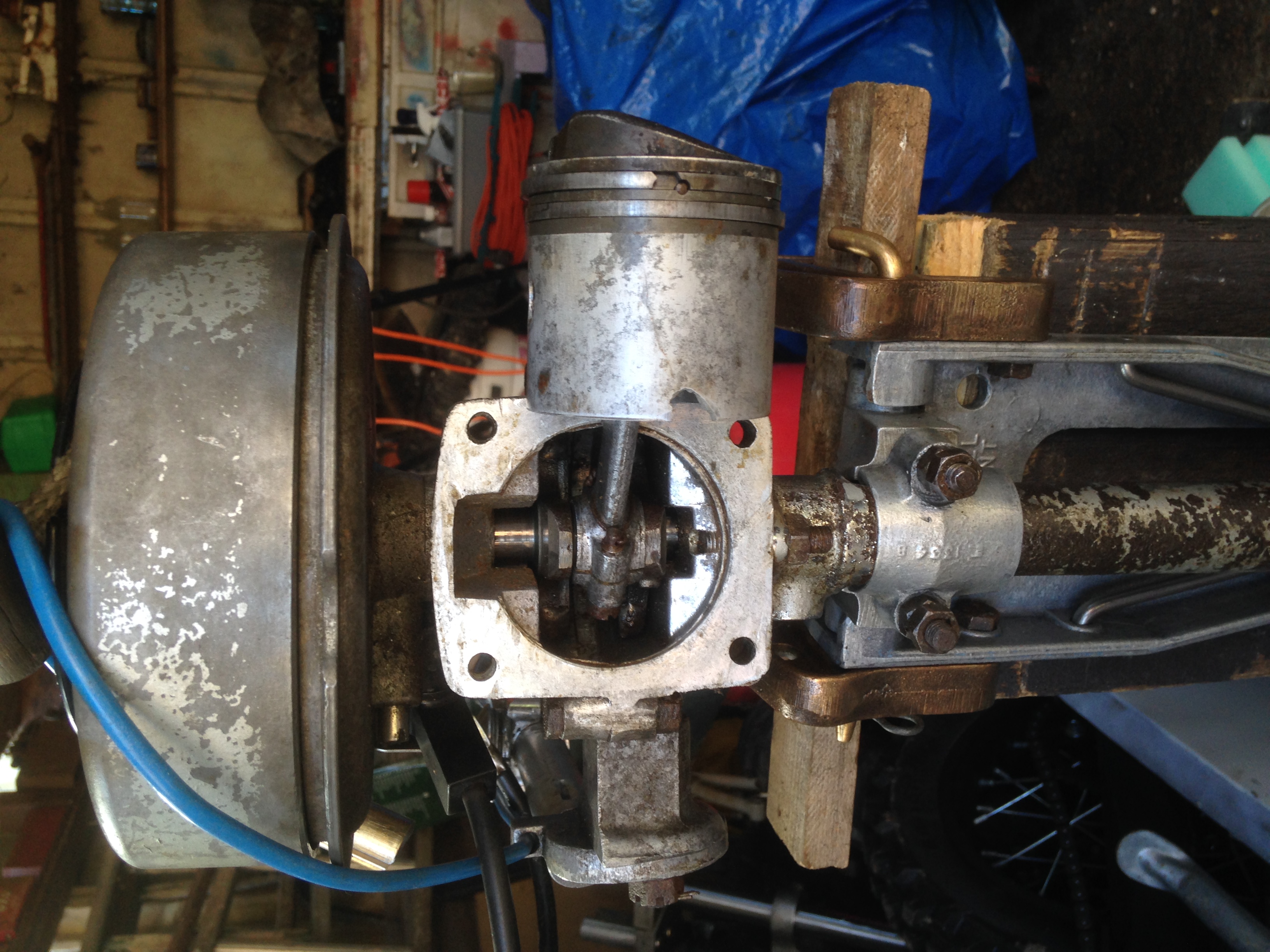

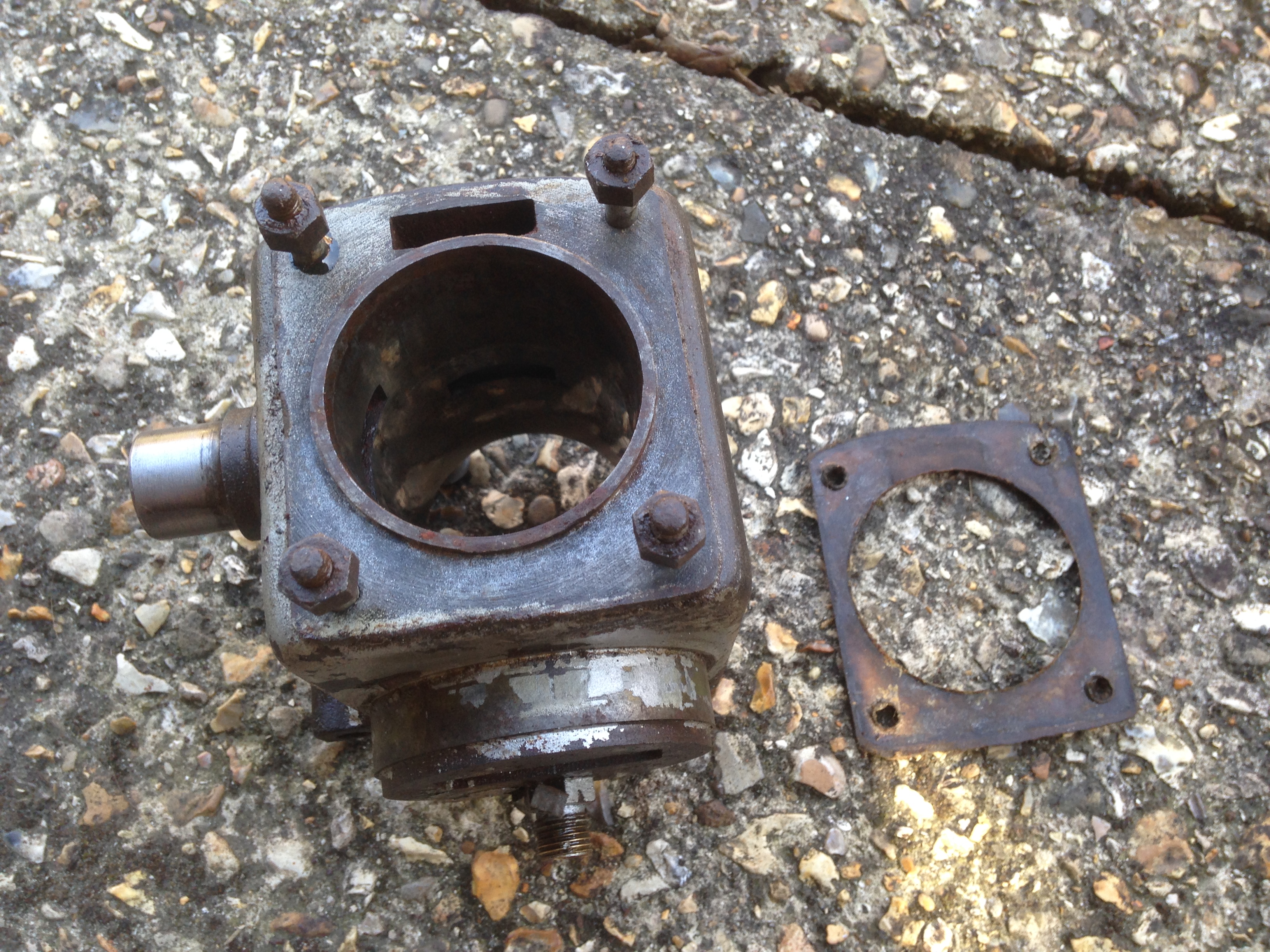

Ok, spent most of the morning tinkering with the suggestions made. No luck, so I bit the bullet and started on a power head strip down. The bolts were all suspiciously loose, on removing the block I found the crankcase to block gasket did not have the hole cut out for the transfer port. Hence why no fuel/oil charge was getting to combustion chamber! This was not rebuilt by me!! Well now it's all apart, I plan to hone, replace piston (damage to port side of skirt!) and new rings. Then will rebuild with new gaskets and a high compression head I have from a 59' Century I'm breaking.

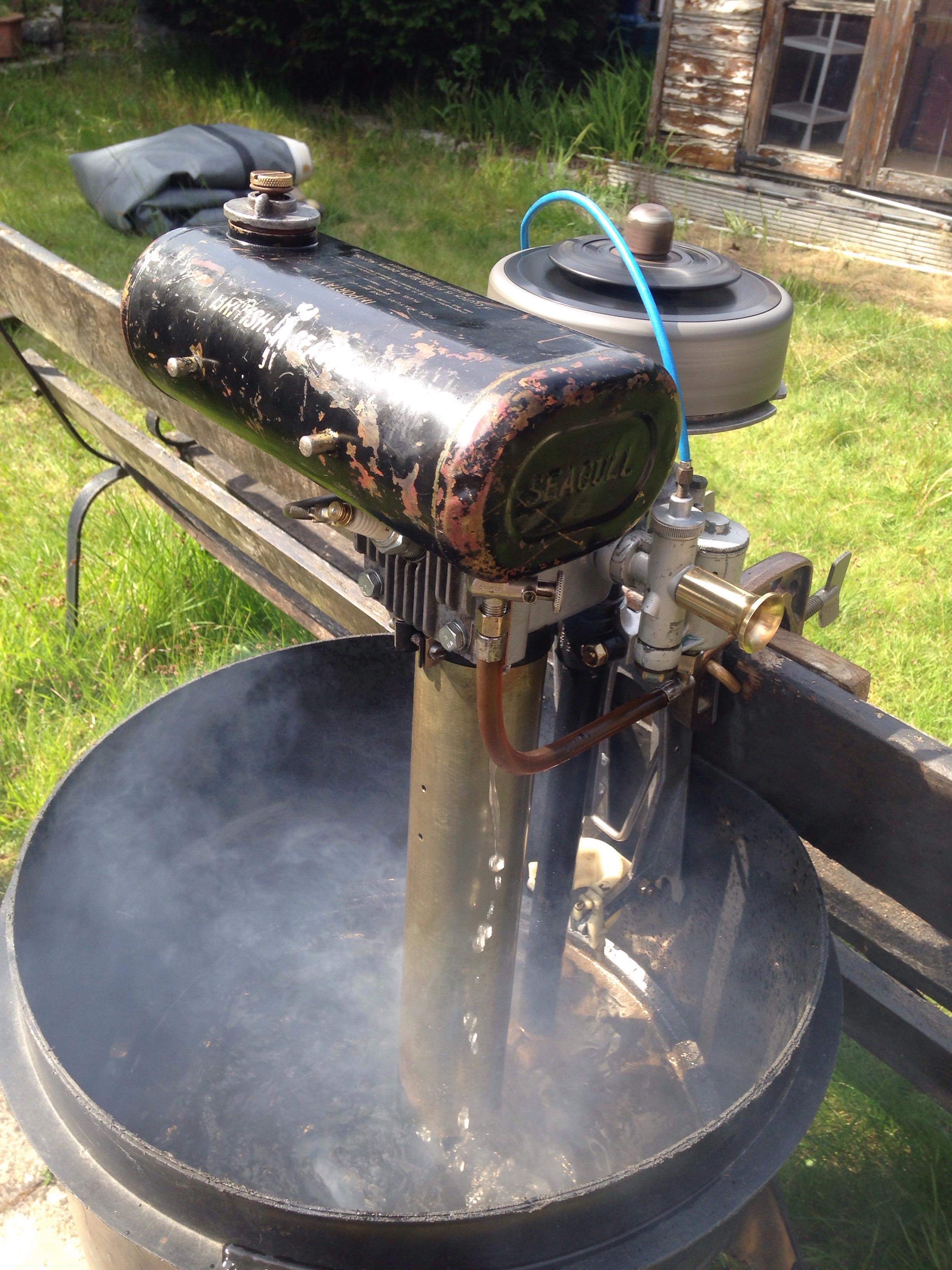

At long last. Rebuilt @nd fired up on 4th pull. Few more little tweaks before dinghy test. Thanks for the advice everyone.

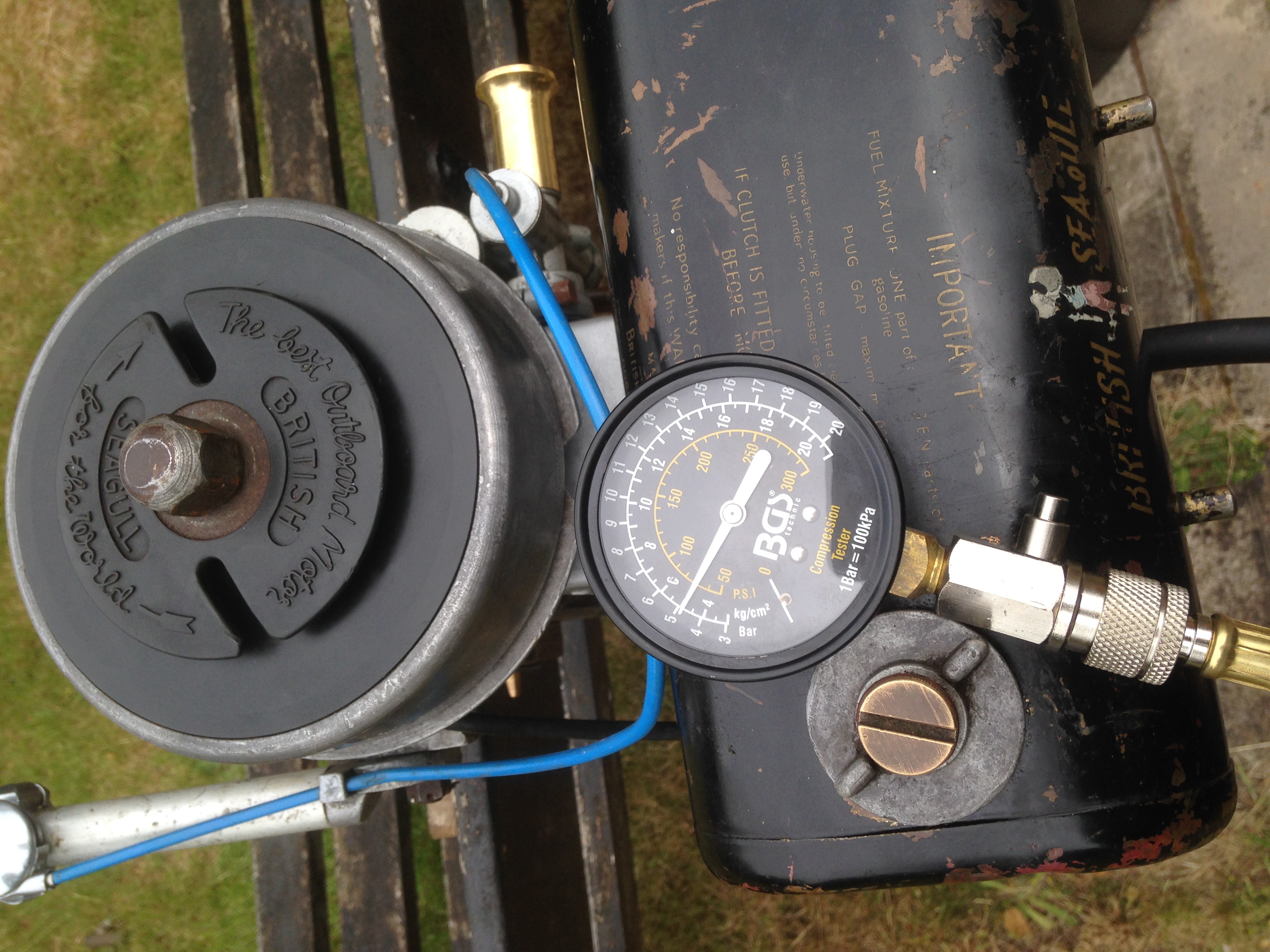

Much later than stated so sorry for that. Finally got new rotor in and pumping good flow of water. Did the compression test and returned a solid 70psi. Well up on my base reading with the low compression head. I would say this conversion is well worth the effort.

50 before, 70 after. Can't judge real world difference on the water as it wasn't running when I got it. Should make a difference to cold starting. Ran it for 10 mins today to clear fuel out of tank. Might get a sea test with fresh fuel tomorrow.
