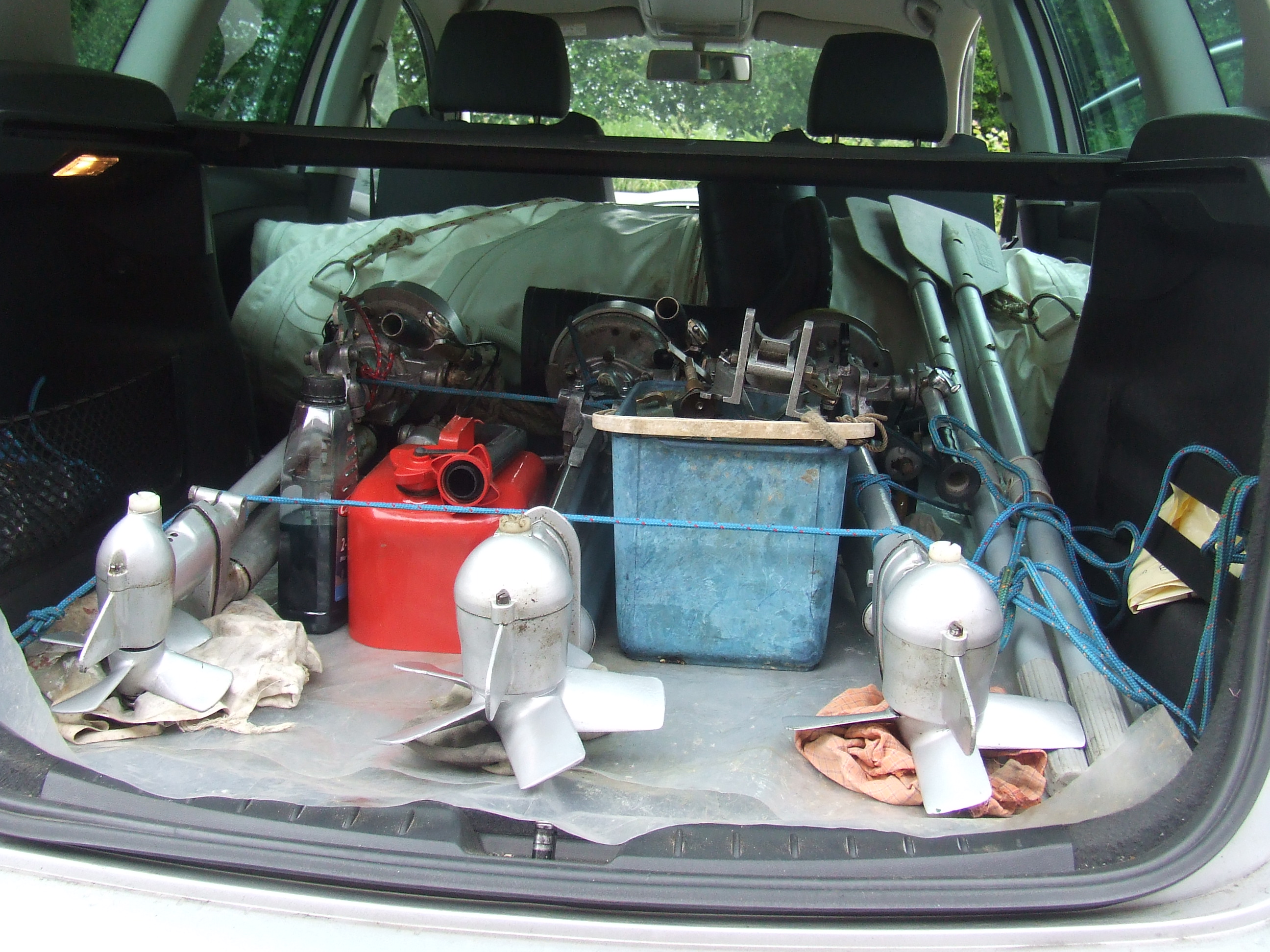

Packed up the three smaller Gulls and an inflatable and set off to catch the tide.
The idea was to give all three gulls a good run and decide which was the more suitable for a proposed adventure involving some French people.
The Forty Plus is the most likely one so took that for a longer run and ended up at the Lawrenny Arms

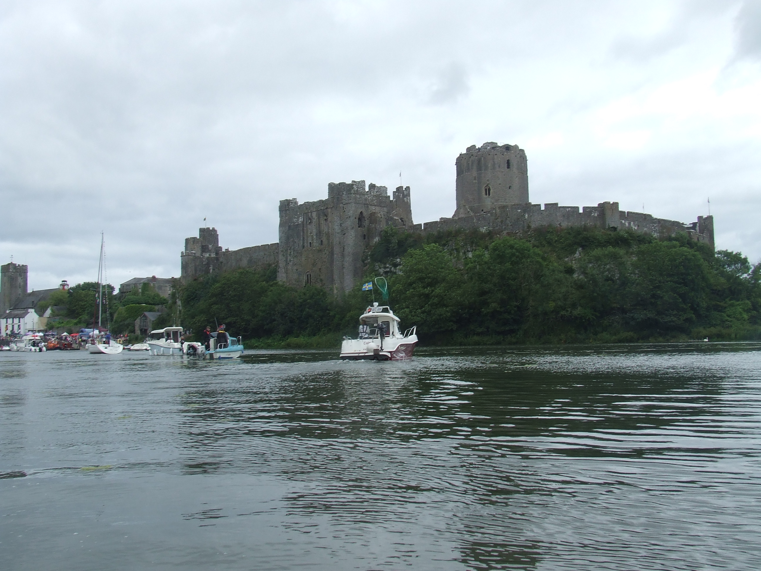

On the way back I met up with the Tenby Lugger "Heritage" and they mentioned that the Pembroke River Rally was the next day so I decided to go along.
Arrival at the Pembroke barrier
Under the Castle
I wasn’t the only Seagull on the rally this was a Featherweight on the back of a Wayfarer.

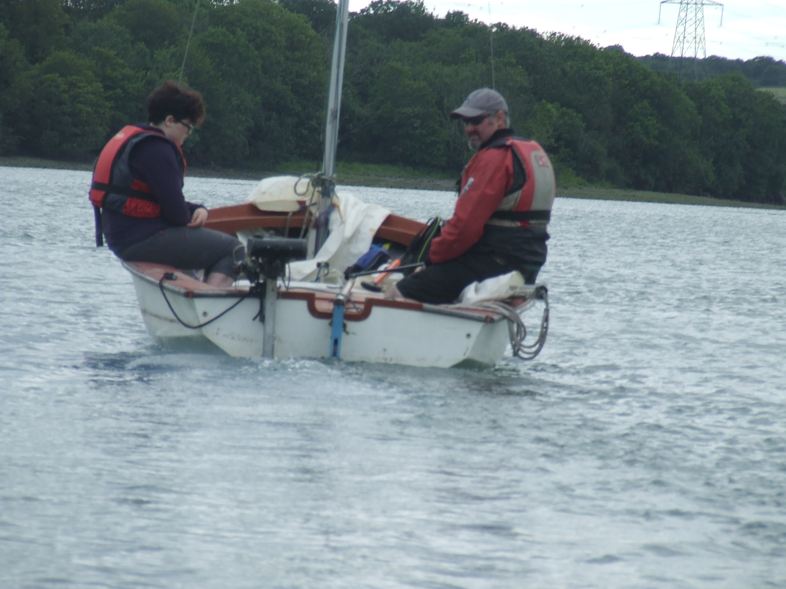

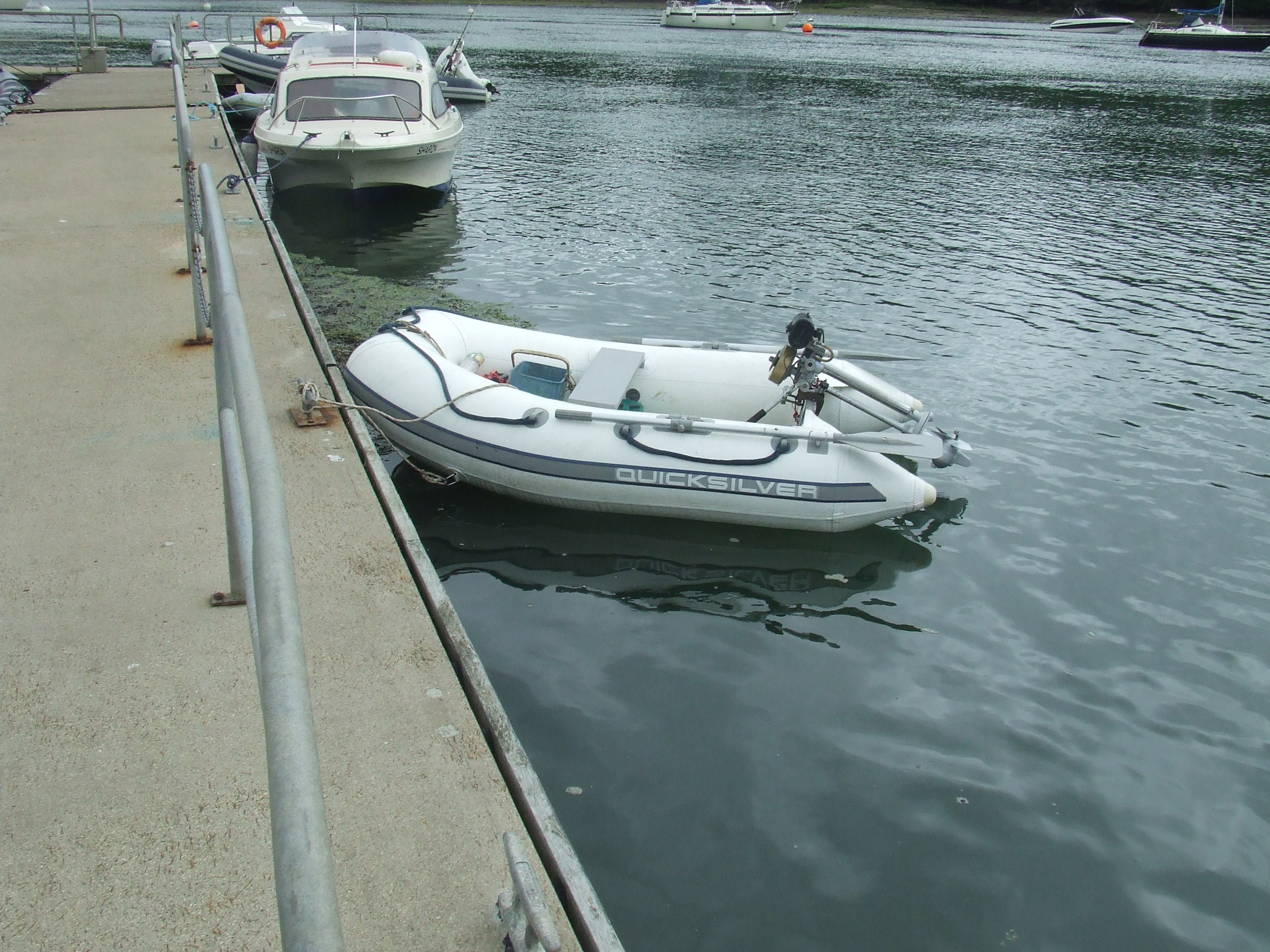

The 40+ stoped as I came out of the river, at first I thought it had run out of fuel and refilled it. But when I tried to start again it was very tight, nothing on the prop and nothing to be seen externally. It looked like it was going to be a long pull back against the wind and tide.
Then the Tenby Lugger came into view so I held up my Painter and they came along side, took me aboard, then I streambed the dingy behind. They had to catch the tide at the Dock Yard so could not take me all the way back and I ended rowwing for the last mile.

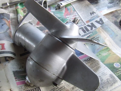

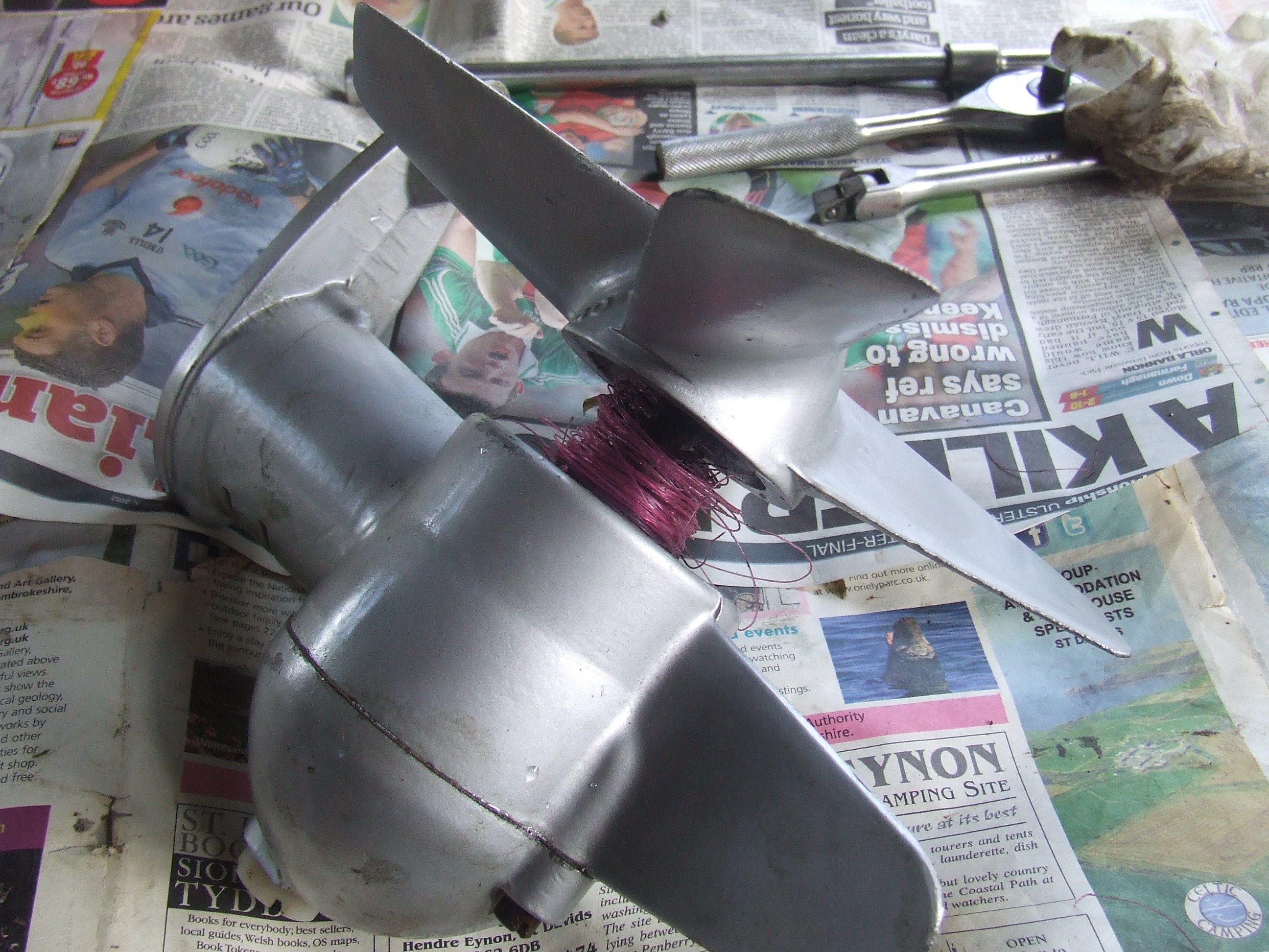

No sign of any thing amiss. But here is the reason the Gull ceased to proceed! She had managed to draw in all the fishing line filled the back of the prop without any showing on the outside. A lot of it had got between the collar and the gear box eventually it melted and the melted line jammed the shaft but left the prop free.
Even if I had found it I could not have fixed it on the water as I needed to remove the pin to take the collar off and clear the jam, what a mess.
