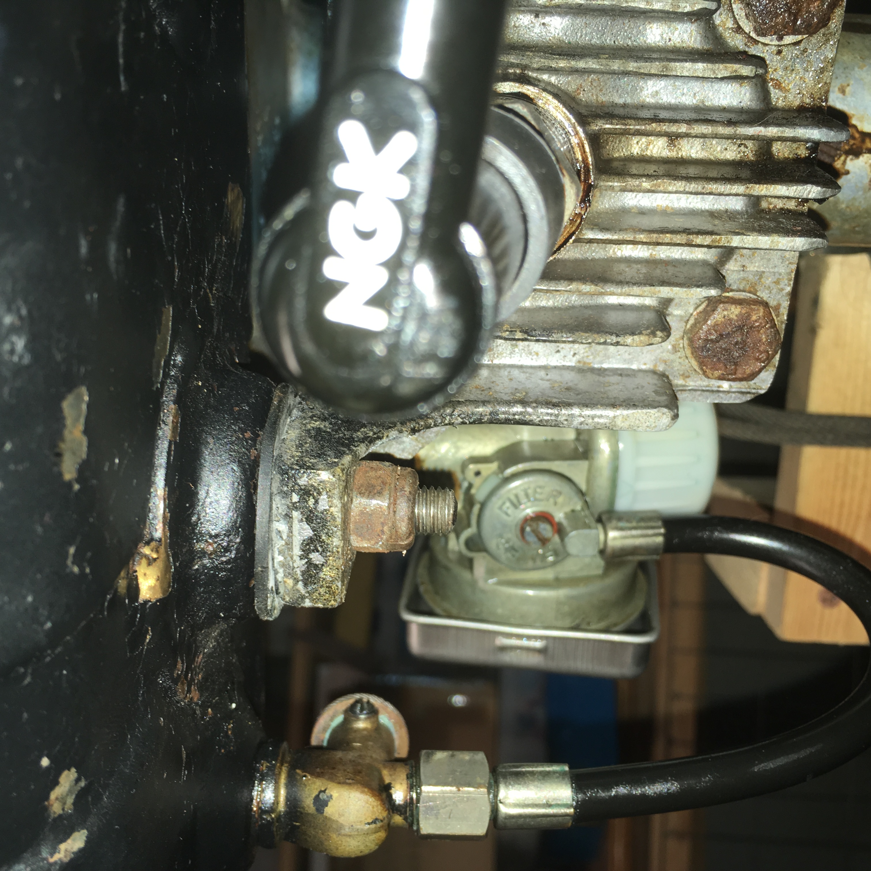

I am missing one of the two studs which are screwed in to the bottom of the fuel tank. The other ends pass through the two holes in the cylinder head to and fastens with a nut to secure the tank.
I am pretty sure the stud shaft is 5/16” I am not sure if it’s a BSW thread or not. I presume it is but I don’t know.
I would be surprised if it’s not a standard bit of British industrial hardware but I have no idea where to find one. Any help understanding the dimensions, thread standard, and sourcing clues would be greatly appreciated.

Pete, shine a light inside the tank so you can see how your tank is constructed, the thread is 5/16 BSF.
There are several different tanks used on Seagulls it would help if we knew the model (serial number)?

Pete look inside the tank at how that thread is fastened there, then you will understand the difficulties your facing!

My 40 Featherweight 1977 type GF engine has a different style tank than H-A’s photo shows. I do not have the reinforced hard points on the tank. The inside of the tank is bare except for the screen for the fuel tap.
The only means of attachment is by two studs that screw into two reinforced plates on the bottom of the tank. The studs pass through the two holes in the cylinder head and secured by nuts as you can see in my photo.

Steel tank, just weld on a 5/16" B.S.F. stud.
I would turn down the head of a bolt and mig weld it on , de-gas tank first.

H-A....I may end up doing that. I am going to explore the possibility of finding a double threaded 5/16 BSF 1.5” stud. That appears to be what Seagull put in these old steel tanks and I hope to keep it original. Failing that, welding a 5/16 BSF bolt may be my only hope.
I hope that it is not a BWS stud. I can’t find any BSF or BWS stock to compare.
I did get an email today from John at SOS who was pretty sure it was a metric steel stud. I dragged the tank down to a local supplier and have convinced myself that it’s not metric. The nut threads easily on the existing stud on the tank but only takes about 2 turns on a metric bolt before it jams.

Thread is definitely 5/16" B.S.F.

John was right in my case - my steel tank on an early electronic featherweight was definitely metric - M8 I think - I was replacing the studs with stainless. I had to cut one end very short - slightly longer than the length of the female thread in the bottom extra plate on the tank, otherwise it bottomed out on the tank Inner bottom steel sheet, instead of the end of the male threaded stud
