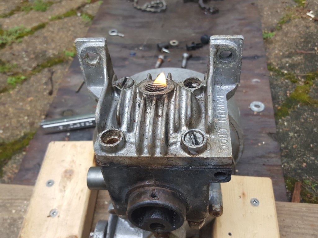

The biggest challenge now is the frozen piston. Took the time to find a large slotted head bit to fit the cheese head cylinder head screws. Used an acetylene torch to heat each screw head and the cast iron corners in the area of the screw threads. Most broke free but the most difficult was the one near the water exit.
Got the block hot enough to start a fire
A number of heat cycles and the head finally came off. The water jacket wasn't too bad and cleaned out with a minimal amount of rust. Now I have access to the cylinder walls and the top of the piston. So far so good.

All the really stuck head bolts, I've had problems with seem to be locked in place by aluminium oxide, that horrible white powder that seem to hold the much tighter than Loctite, in the head itself not in the threaded part of the cast iron cylinder.
After I've cleaned the holes in the head, I now always put them in place covered in RTV silicon, no room for water ingress & they come out without any Drama!
