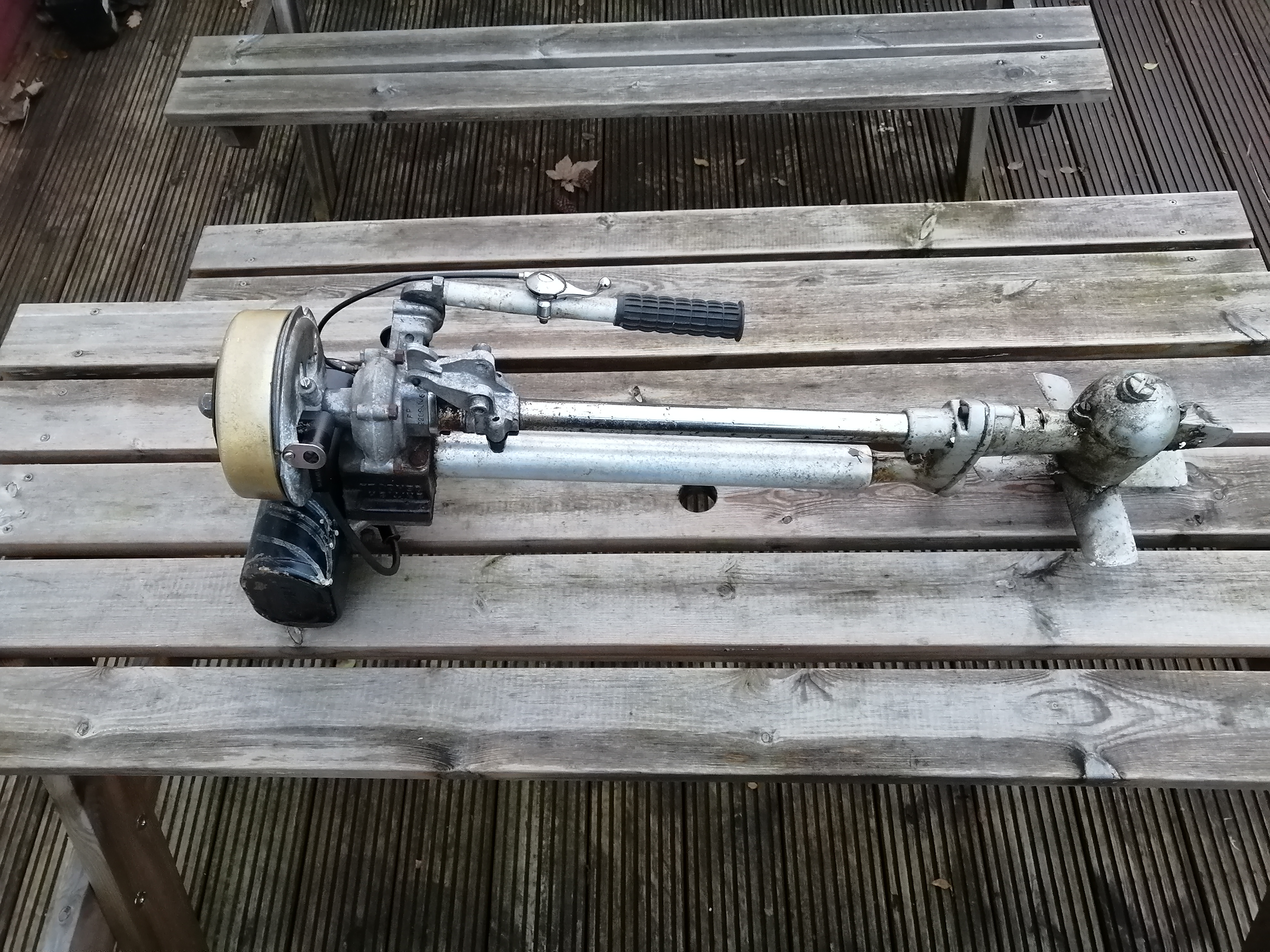

I have recently purchased a working 40 plus and I was hoping that you might be able to help me learn more about it.
The idea behind buying this outboard was to learn a bit more about how outboards work, have something that I can put apart and learn how to do maintenance on put it back together, etc. And in particular with the British Seagulls I love the fact that you're buying a piece of history with it. (And might I add the golden ticket to join a nice community as yours.)

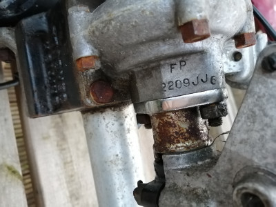

- I am hoping to find a manual for the 40 Plus, so I can read a bit more about it. In the meantime, could you please let me know what material is the seagull made from? Is it aluminum on the shaft? Is that brass on the top spinning thing (what do you call it? )

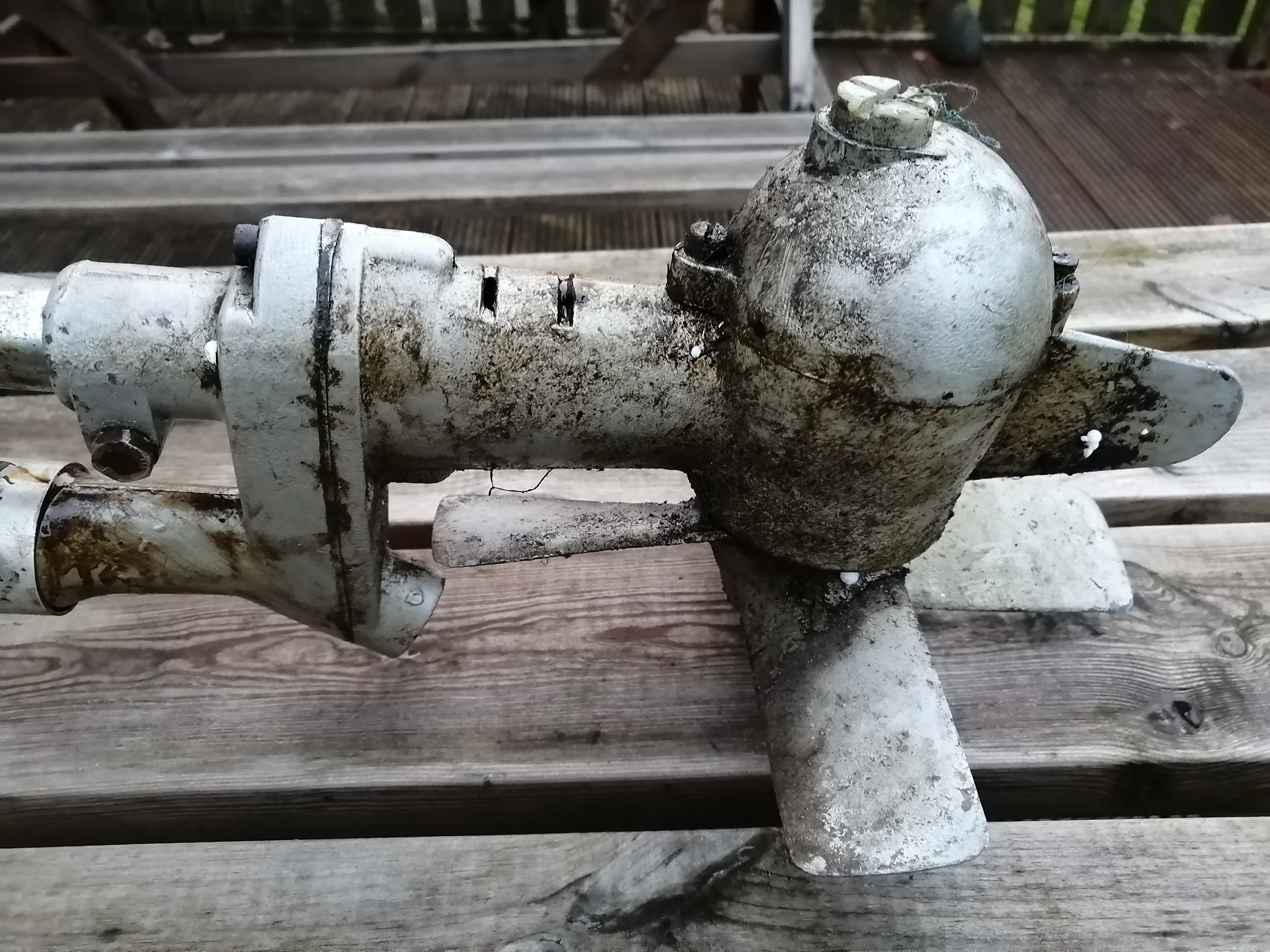

- What would you use to clean the oil ? What would you do to remove the rusty spots (for example in photo N7)?

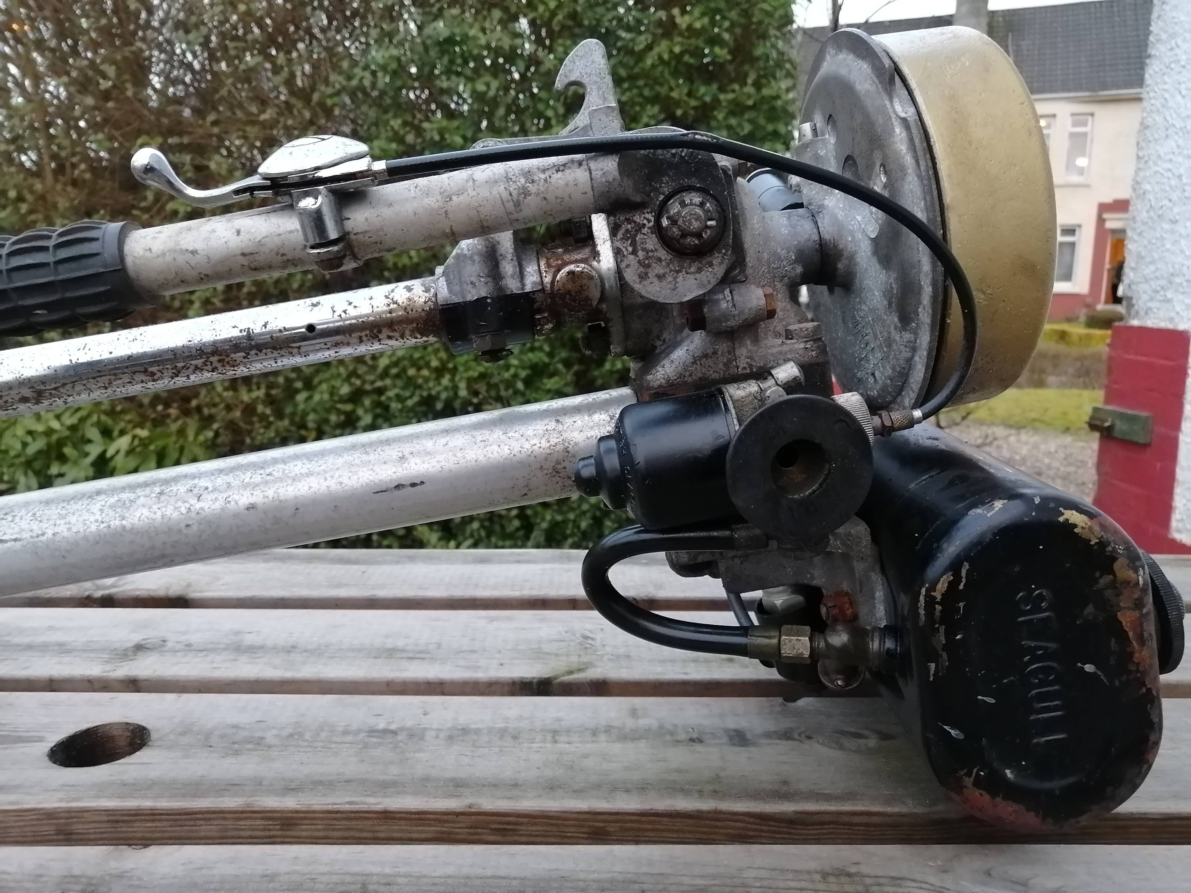

- I read a lot about the Villiers carburetors, I believe mine has this type - correct? Is there a choke on it?

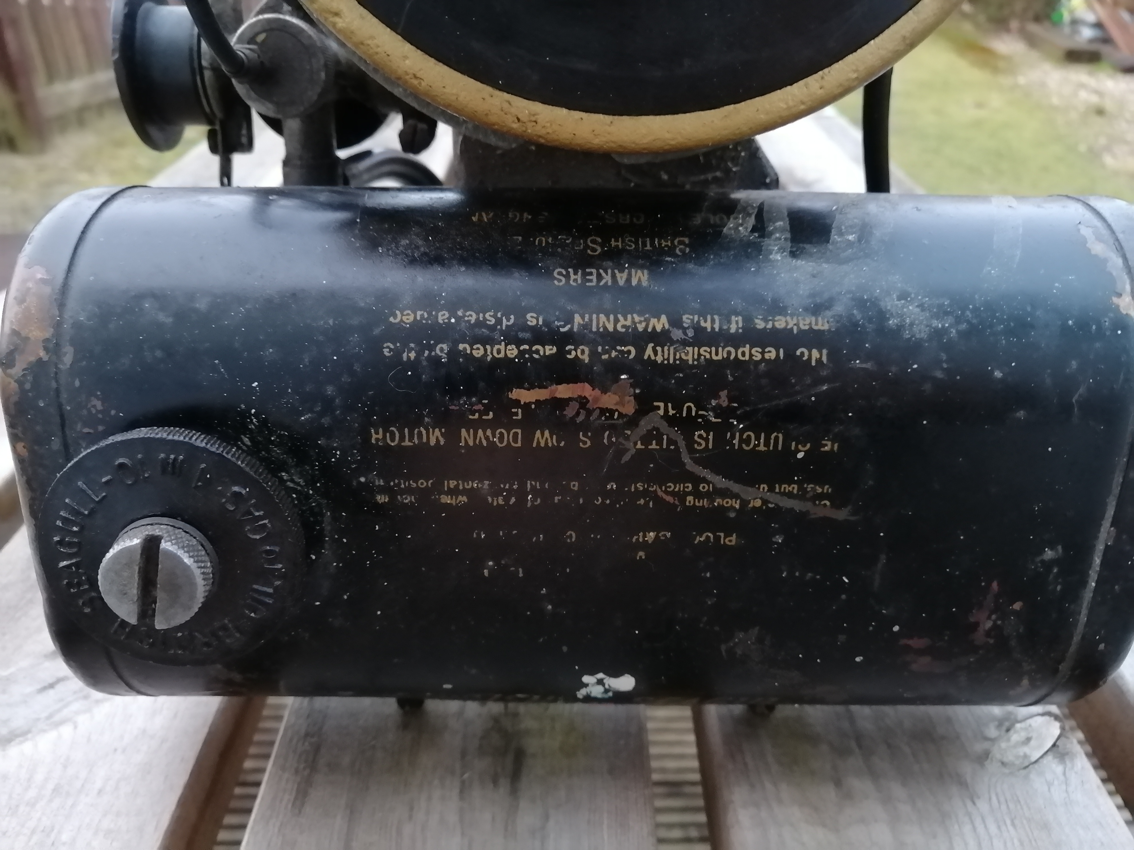

- Does anybody know what it used to say on the top of the fuel tank?

I will attach some photos I've made of the outboard. Please excuse the fact that I still don't have a frame for it.

Your motor has a Villiers carb, the choke is a flat metal plate that pivots between the air intake and the main body of the carb. In the closed position it covers the air intake (choke on). Pretty much as soon as the engine starts open it fully for the motor to run freely.

Both my motors were in a similar condition to yours, when I acquired them. I cleaned them up with a rag dipped in the same fuel and oil mixture that you put in the tank. That got most of the gunge off. Because I intend to use my motors on boats, I will not be trying to restore them fully. I polished the worst of the rust away with AutoSol chrome polish.
Be sure to change the gearbox oil before running the motor for any length of time. The oil, if there is any still in there, is very thick. I warm the gearboxes with a hot-air gun (a hairdryer on high might work) before trying to drain them. Don't melt the nylon drain plug!

The motor looks good, do you have the complete clamp?

The top spinning thing is the Flywheel, it’s made of aluminium and is painted a sort of Gold.
It is the Magneto and contains the points (that you can clean and set,) the coil and associated magnets.
The large diameter exhaust tube is made from aluminium, the smaller diameter tube houses the drive shaft it's made from chrome plated steel, it acts as a torque tube.

The writing on the top of the tank is just the name and the fuel mix, again John can supply new transfers if you want to repaint the tank.

I do have the clamp, I realize I have not included it with the pictures, now that you've mentioned it.
