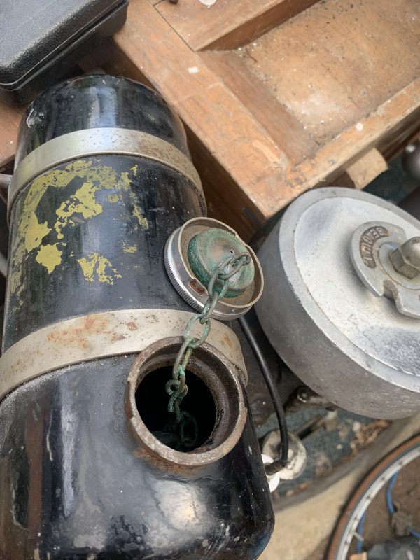

I am starting to become addicted. Having a perfectly nice 40 Plus, I wondered if I were up to the challenge of restoring an early 102, and I have just acquired C.1912, from 1946, which has spent the last forty years on the floor of a garage.
Everything seems to be present, apart from the induction silencer/choke body that ought to screw onto the Amal 2 jet here:
The tank filler is not one that I have seen before; it looks like a motorcycle type, made by Ceandess Ltd,Wolverhampton. It is nicely made but it looks as if the filler tube is mild steel soldered onto the brass tank, which is seldom a good plan in the marine environment! The filler cap can be closed completely or if given a quarter turn it pops up thanks to an internal spring and the breather can operate. To open the cap, press down and give it a full half turn. A more elegant design than the separate breather screw.

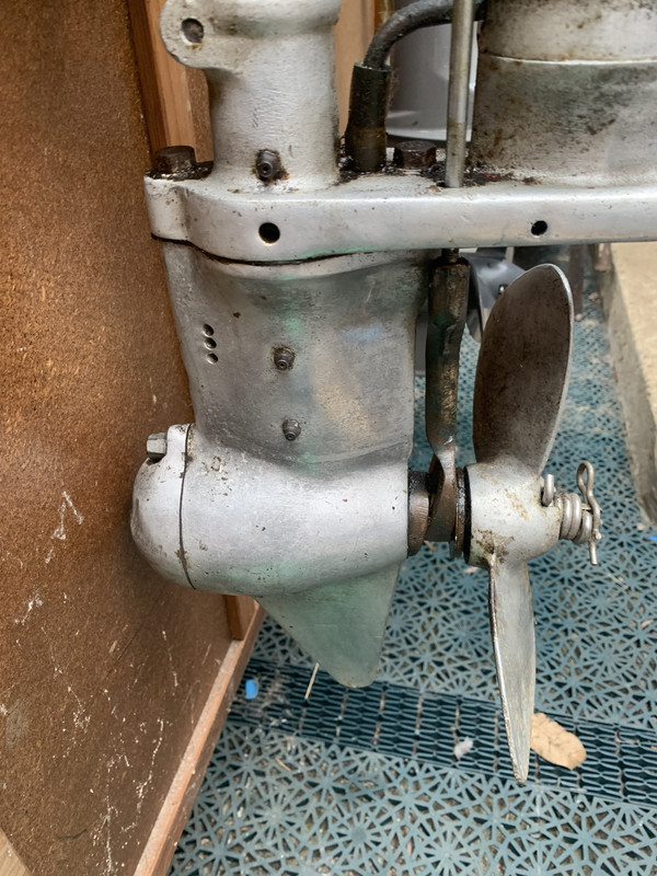

There are two grease nipples on the gearbox, and of course a bow tie propeller.

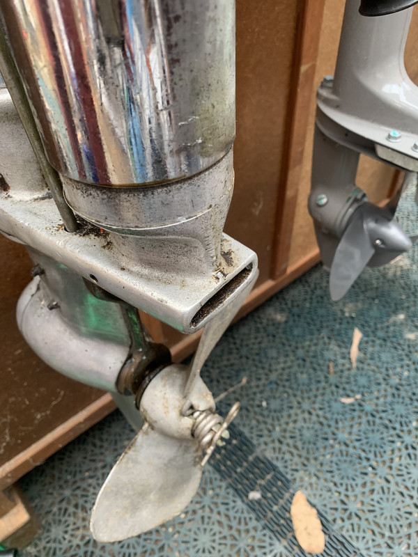

If I am going to do a proper job on this, I am going to have to get the leg and the exhaust pipe re-chromed. I assume that the Villiers coil is long dead, and I am watching Amal two jet carburettor videos. :lol:
Correction: there are three grease nipples:
I think the “straight through tailpipe” is an early feature?

Nice find :P The C models were a very early post war engine, which were quickly superceded by the AC (Clutched) and AD (direct drive) So a fairly desirable model to restore.

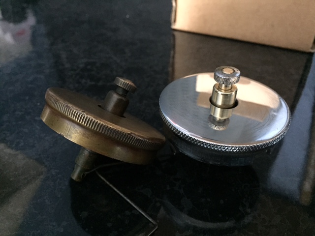

The filler cap is not correct, it should have a vent screw in the middle, these are hard to find, I made some new ones a while back as the Ceandess caps are still made.
The prop you have there is from a later 102, you should have a 2 blade "swept" prop as fitted to SD engines.

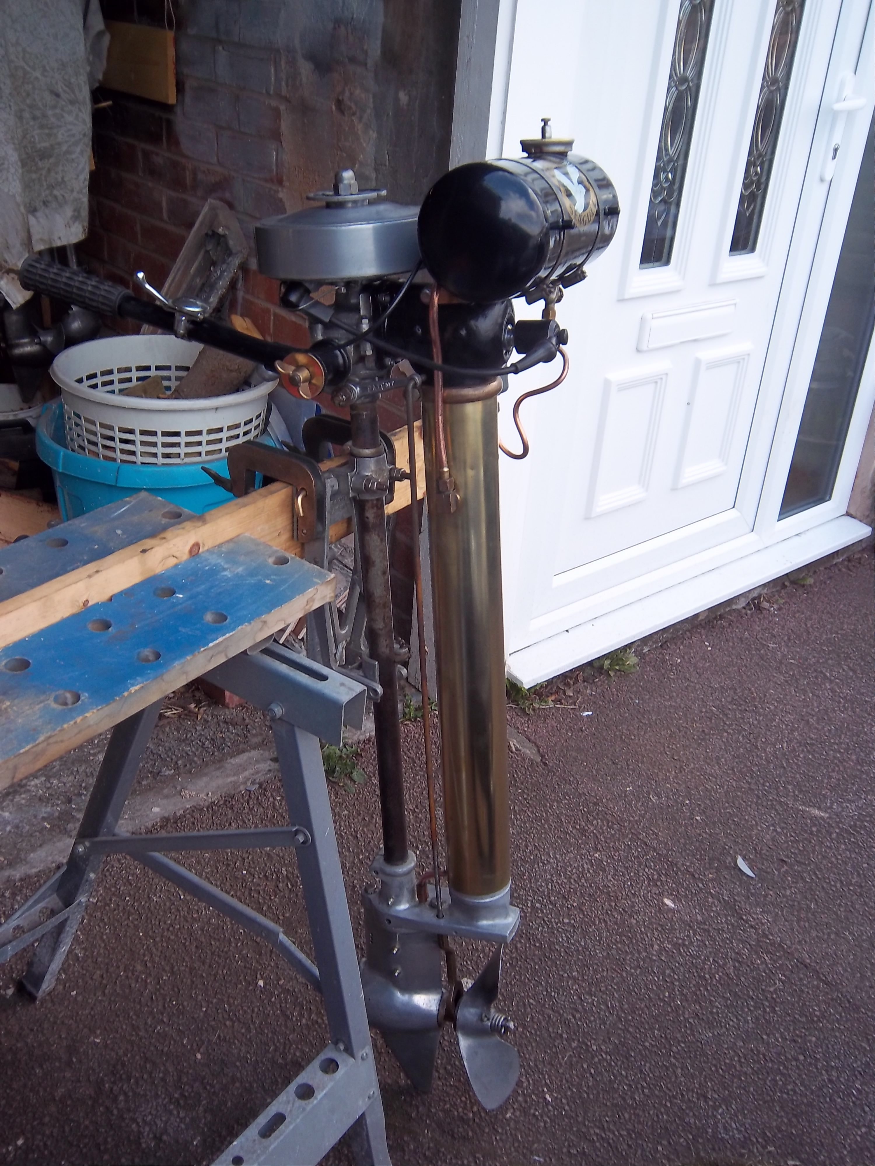

Here's the prop you need.

Also dont fall into the trap of putting grease into the gearbox nipples, they are actually oil nipples and a heavy grade oil such as 140 should be used.

The brass tank with a bayonet cap was standard on many of this series & later ones had the bow tie prop, if you use SAE 140 in the lower unit which we believe was designed to run on Castrol K70, (the nearest viscosity I've been able to locate is SAE 460 which is less viscous), you'll end up with a puddle as the bearing clearances seems to be greater from new.
