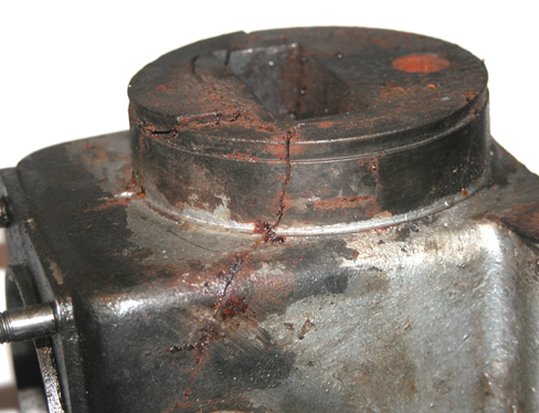

Let's carry this subject further can anyone with a "cracked" Silver Century cylinder, post pictures of the damage, so the areas most prone to salt water damage can be established.
How much heat do we need to get rid of via water cooling, from a Silver Century running at peak revs.
Does anyone have a dead Silver Century cylinder that can be dissected so all the water gallery's nooks & crannies can be noted, so it can be seen if blasting would work as a rust removal method?

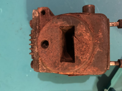

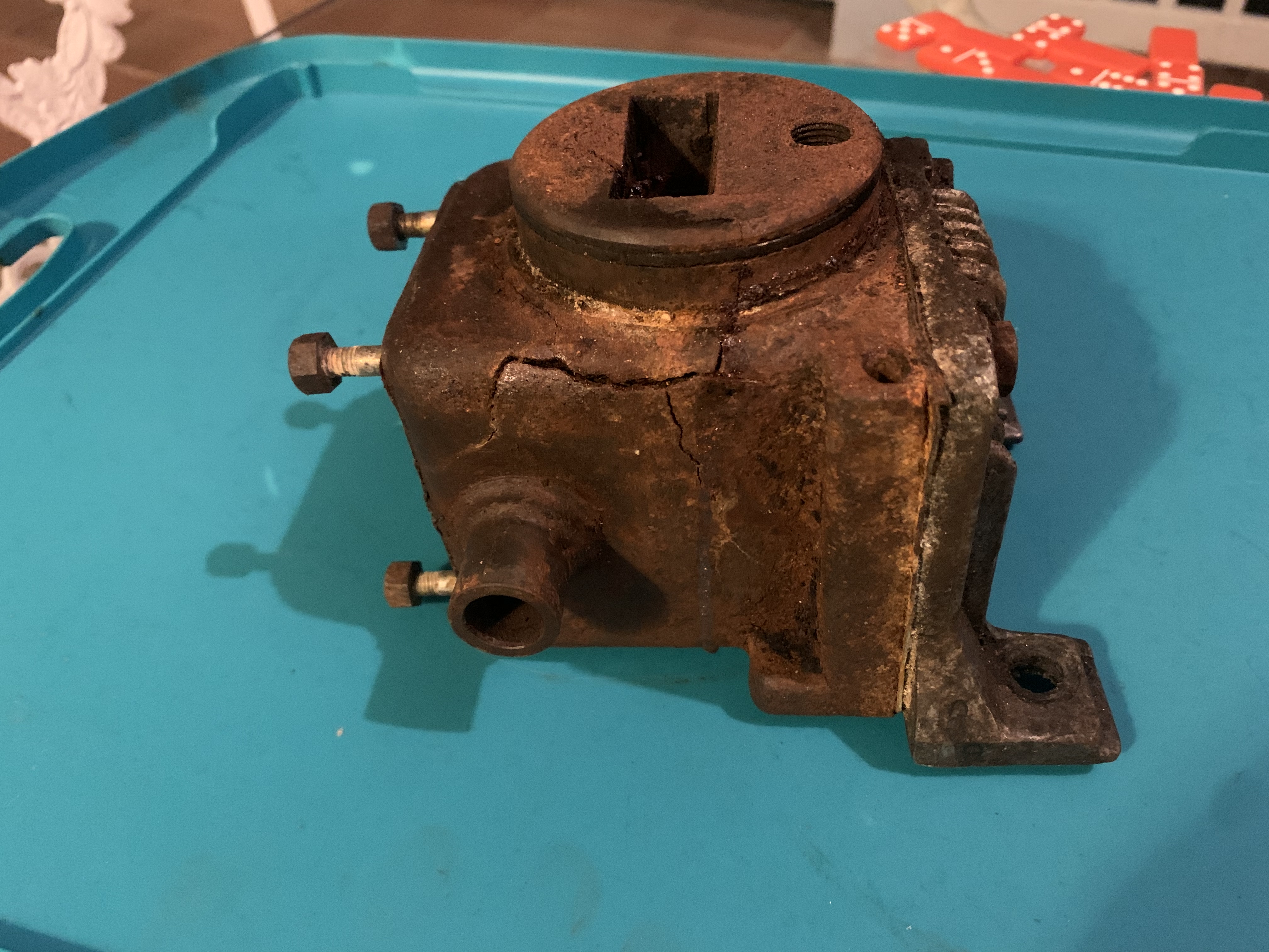

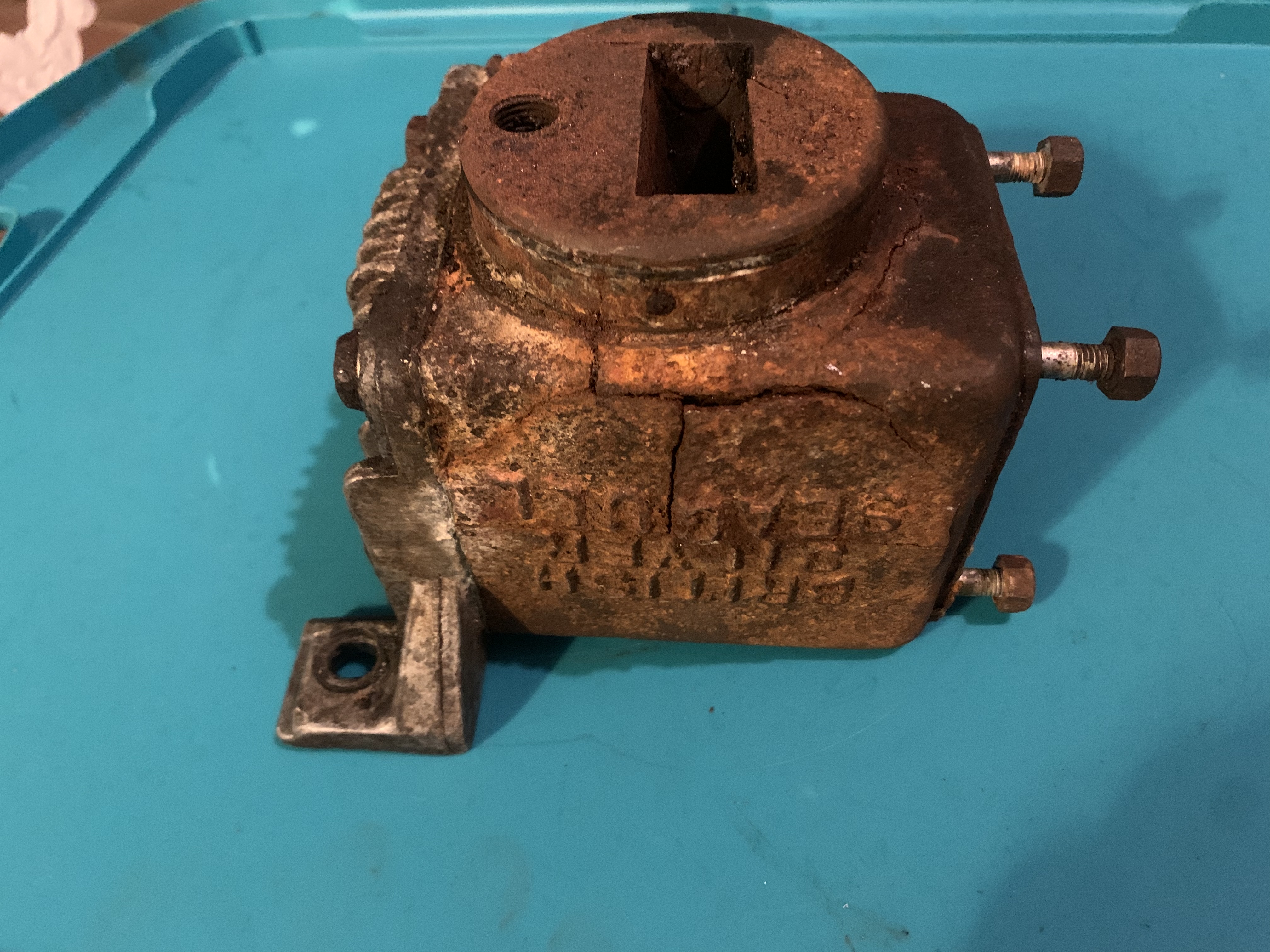

here is a rusty one
andrew
Site Admin
Posts: 180
Location: ..
Re: Heat Transfer - POR-15
Post by andrew »
This one was my fault, I ran it in salt water about 10 years ago then stuck it in a damp garden shed without flushing. Found it in this condition last year.
Sandro_Picchio
Posts: 116
Post by Sandro_Picchio »
Did it crack because of frozing in the shed or just because of the push of the swelling rust?
Sandro
andrew
Site Admin
Posts: 180
Location: ..
Post by andrew »
Only rust swelling! Doesn’t freeze here fortunately.
