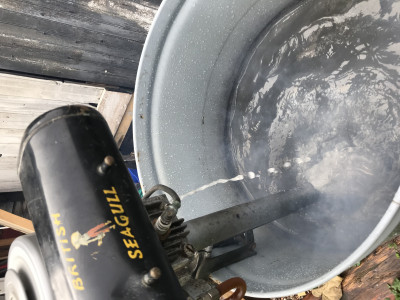

So I tried several of the rotors for fit and found one that was snugger than the others. It went together just like it should and this time I removed the prop. IT WORKS! I barely had enough gas left in the tank to fill the carburetor, but got it running and below is a pic of the 40+ pissing. It stopped when I idled it, but I think that’s expected.
