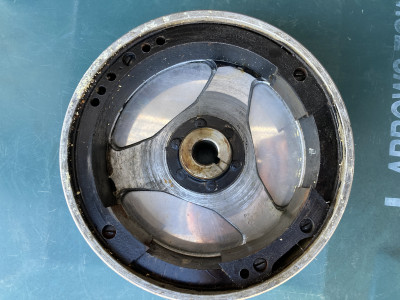

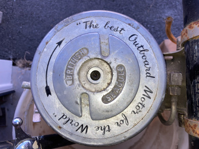

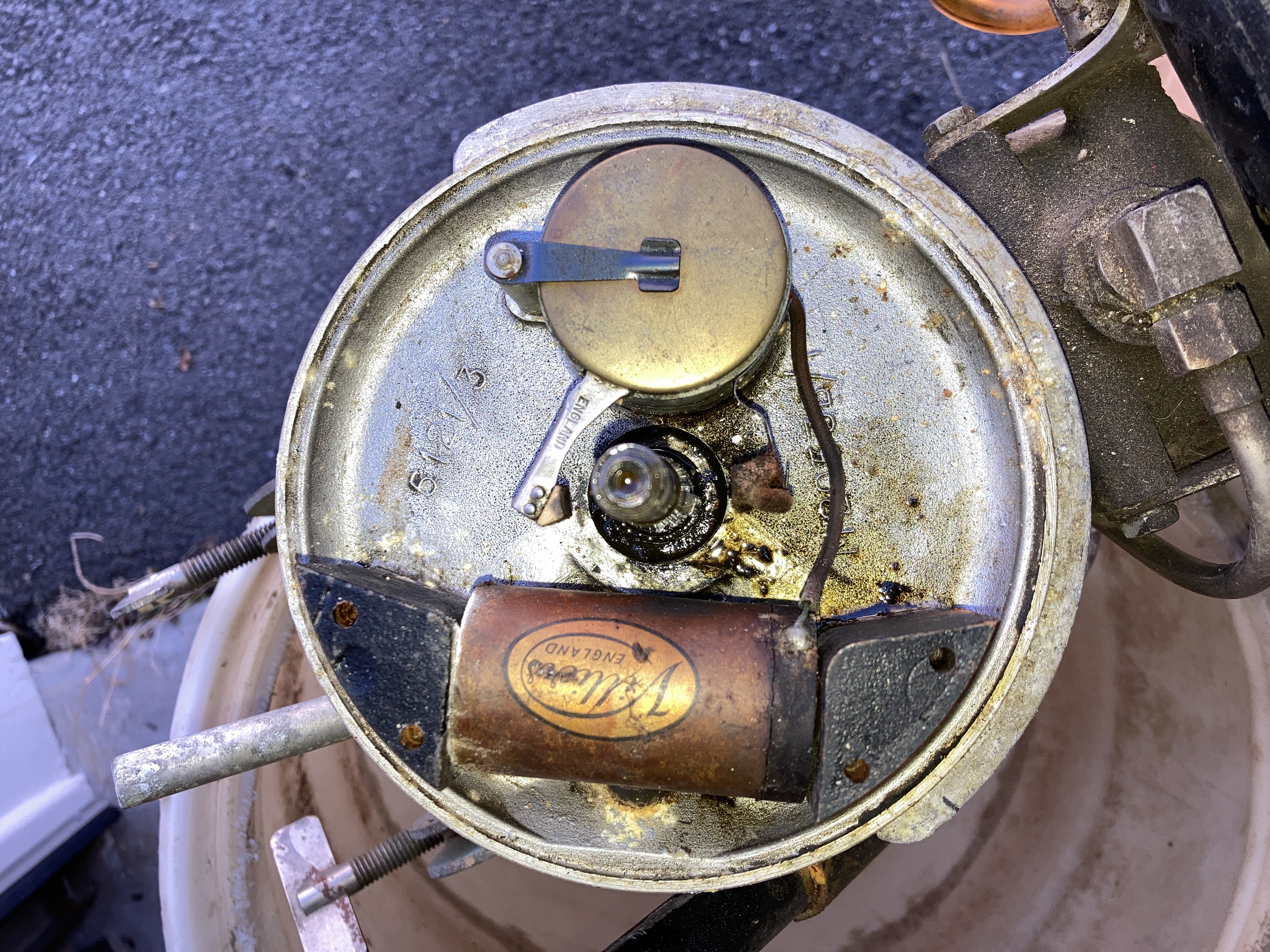

Here is what it looks like. What is the best way to safely remove some corrosion found on the magneto base plat and the flywheel?
Coil and points
Coil and points
Flywheel cover
Flywheel cover
Interior of flywheel

Yes the ignition is a Villiers Mark 1 (MK1).
