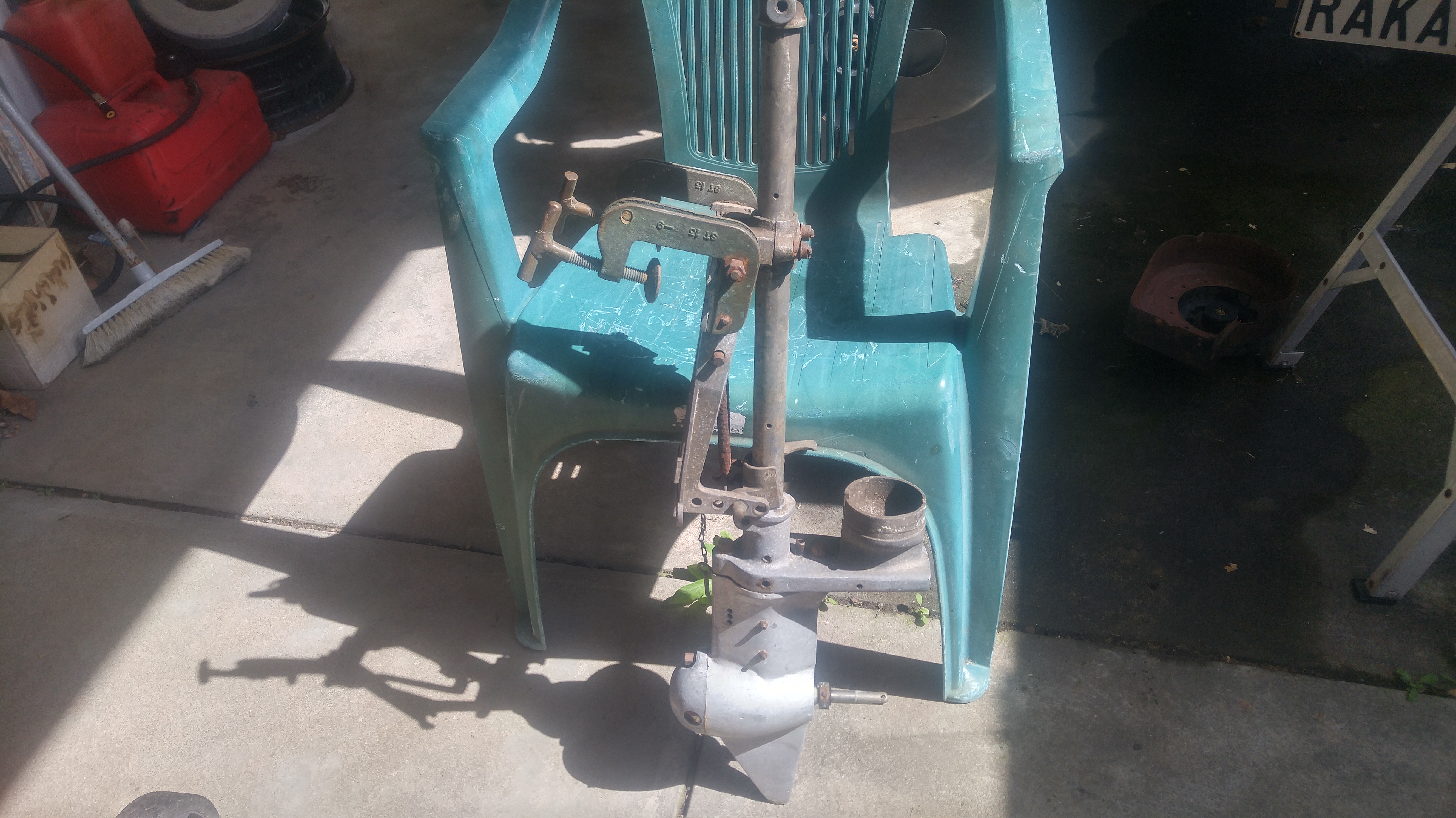

The hard bits about to be attended to. Wash down with ATF and kerosene. then a couple of towels soaked in same and into a black plastic Sulo Bin liner.
Leave in increasing sunshine for a week, maybe two, and apart it will be.
The transom clamps will be brought back to dogleg with some reverse brazing after that.

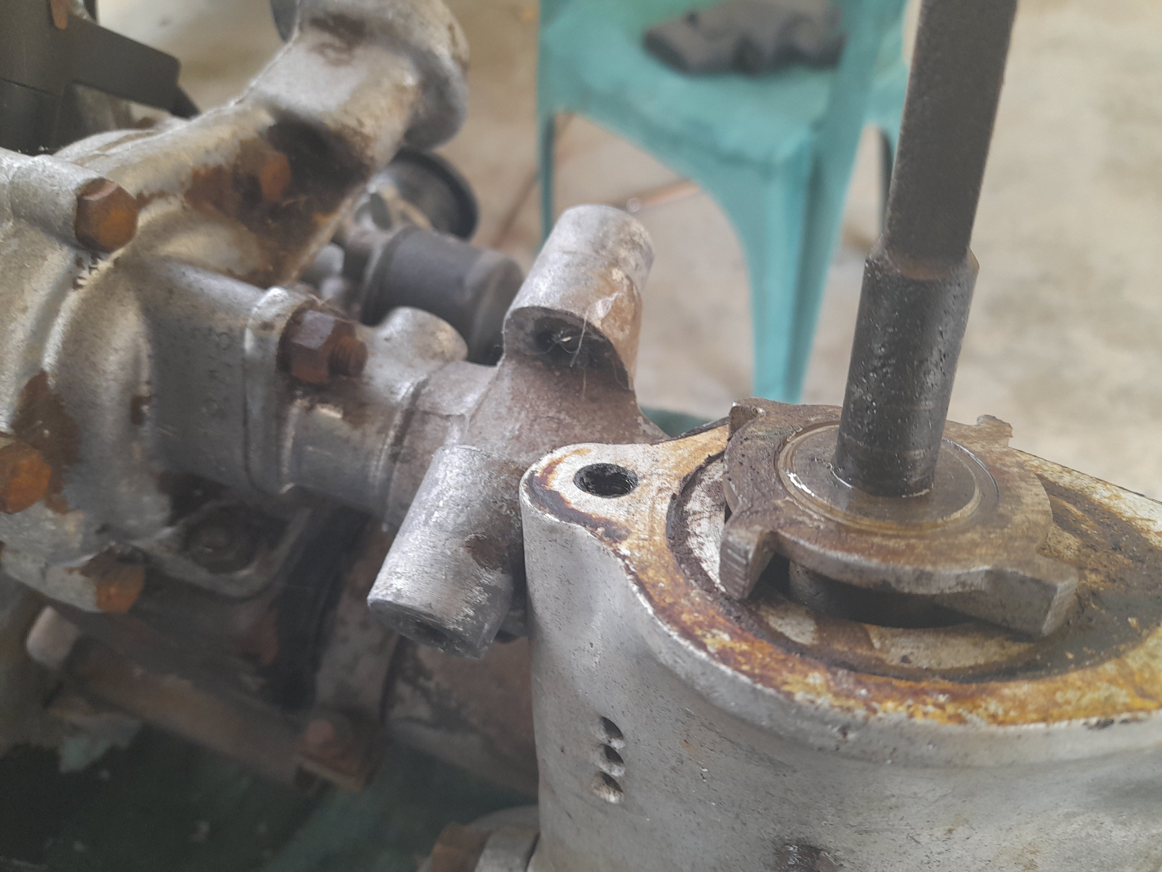

Nearly forgot... The white bush (or something) staring me in the face.
All coming apart soon for inspection and will find out I expect.
Any info appreciated in the short term.

Interesting! Wonder if just a spacer added at some point? To what end no idea.
Looks like a century in the background, two rebuilds at the same time? :)

Friend shortened it and no cooling flow.
Sorting it out ATMO....got everything adjusted to pump 6ft (Leg only with high speed drill)
Weather warming up so on with the power head and try. Could be combustion leakage. We shall see.
If that case is his problem aye.

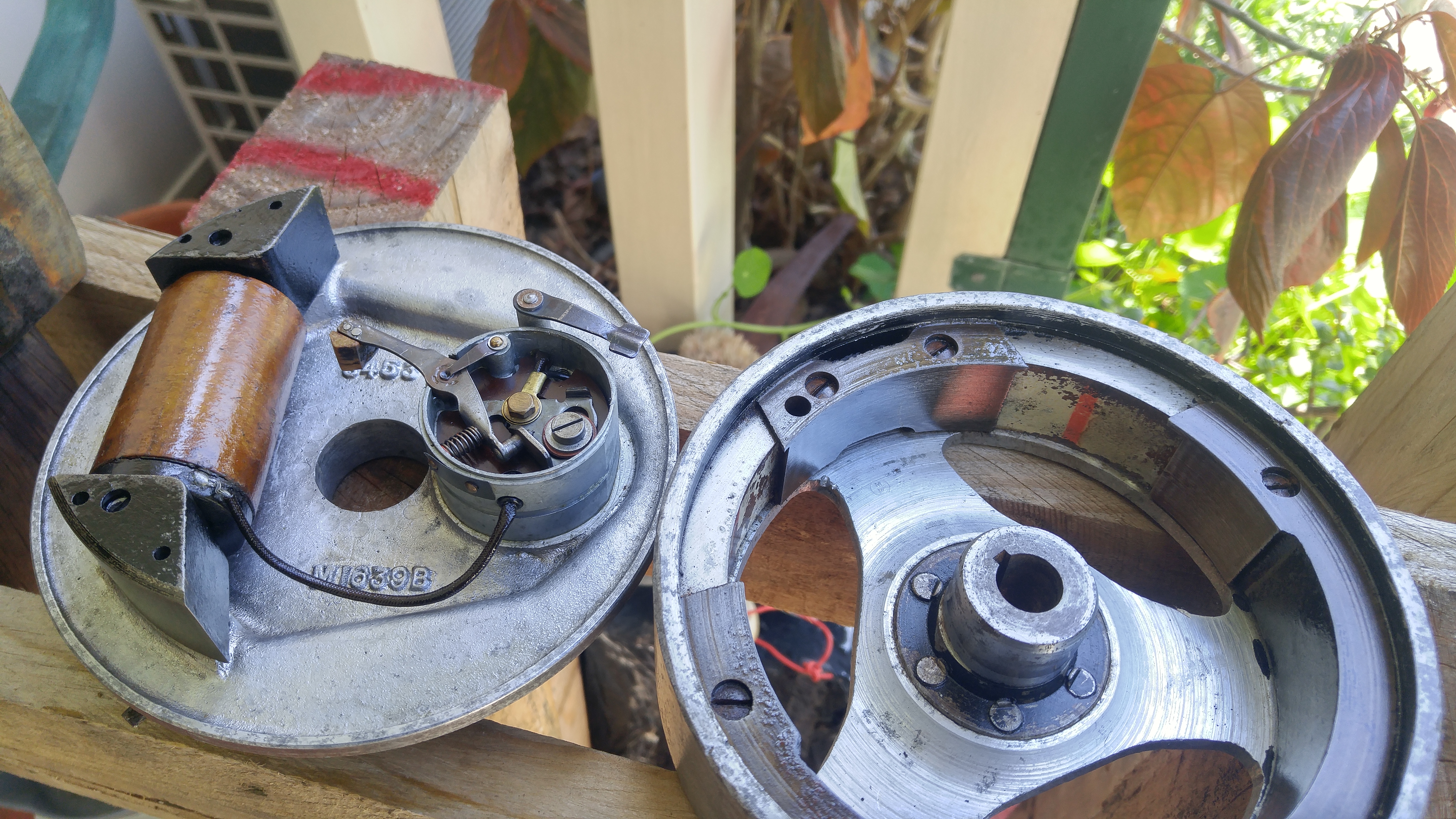

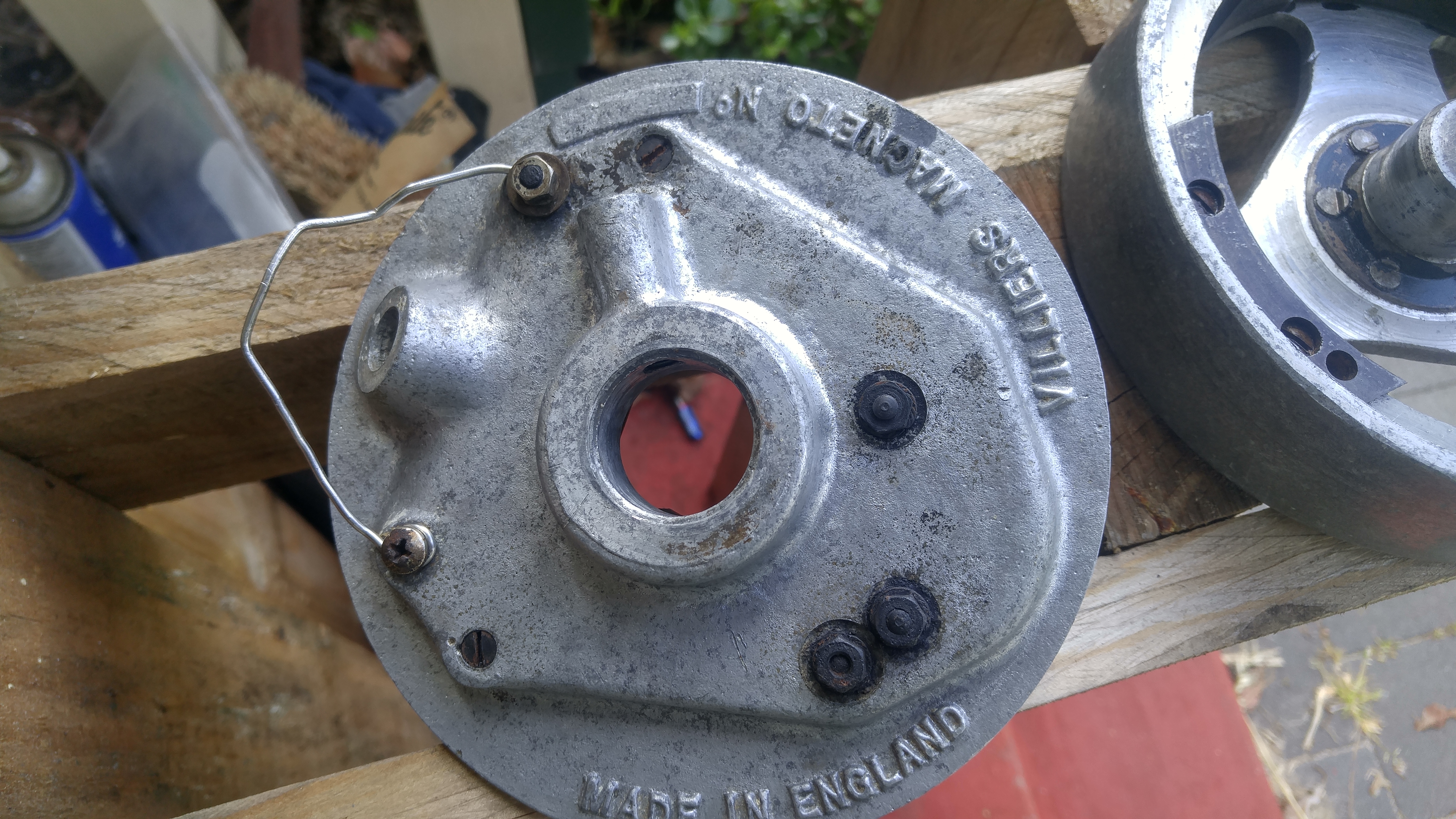

I see an upside-down 9897 stamp on the upper crankcase half. Not sure I’ve notice a stamp there before on other motors. Is this normal for the AD range and/or others produced around that time?
Re: AD2710
Not too sure that crankcase number but have seen similar random.
Usually a factory refurb job has matching stamps.....the gearbox has matching stamps.
Edit; There is the same number of the cases on the prop......interesting.
