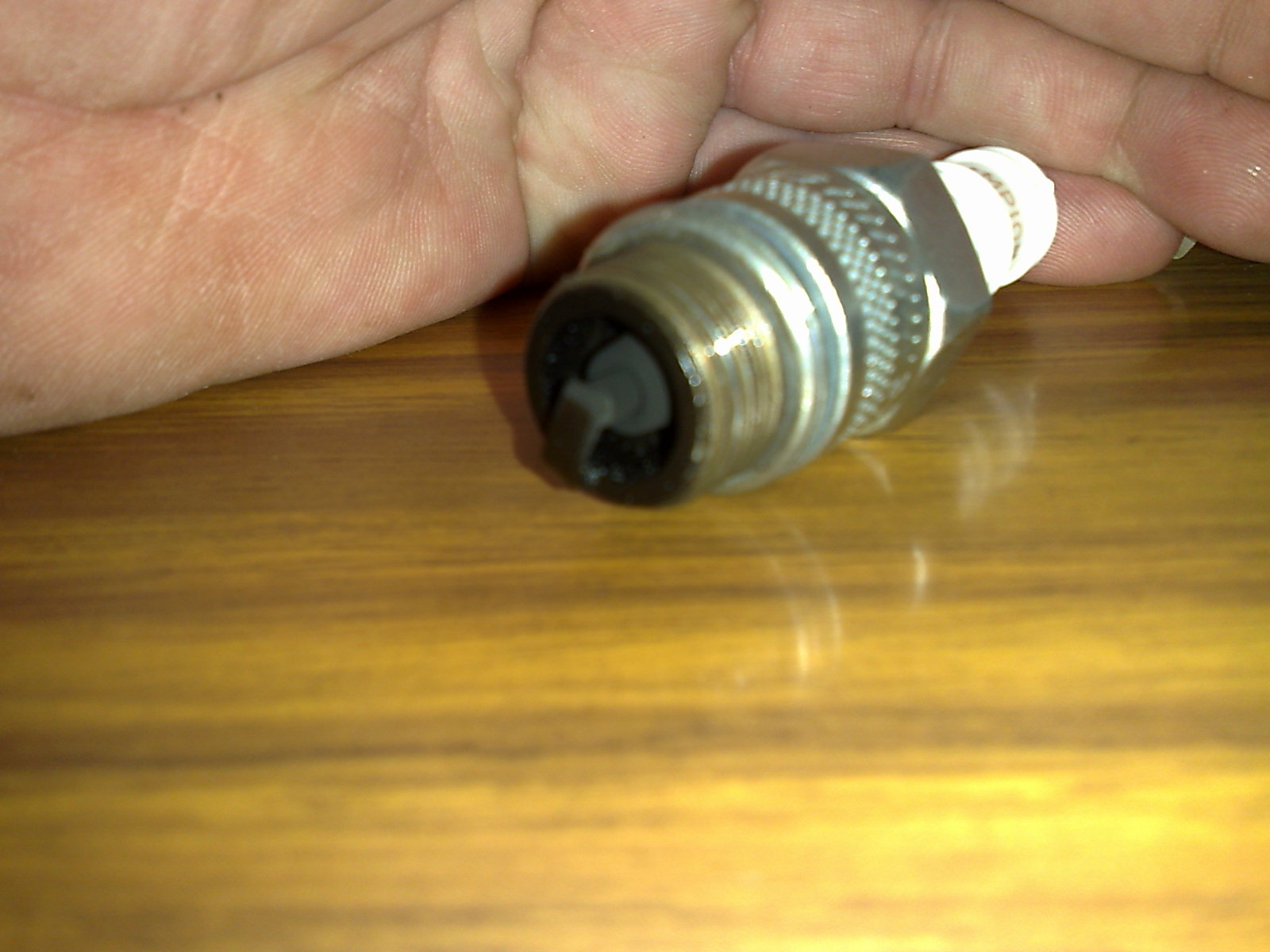

here is a pic of the plug after extended run in a tub (NOT on a transom)
I see no possible damage being done so far. Mix was 12:1 TCW3. Dry fluffy centre and 1/2 of electrode with semi wet/wastage oiling about circumference..............

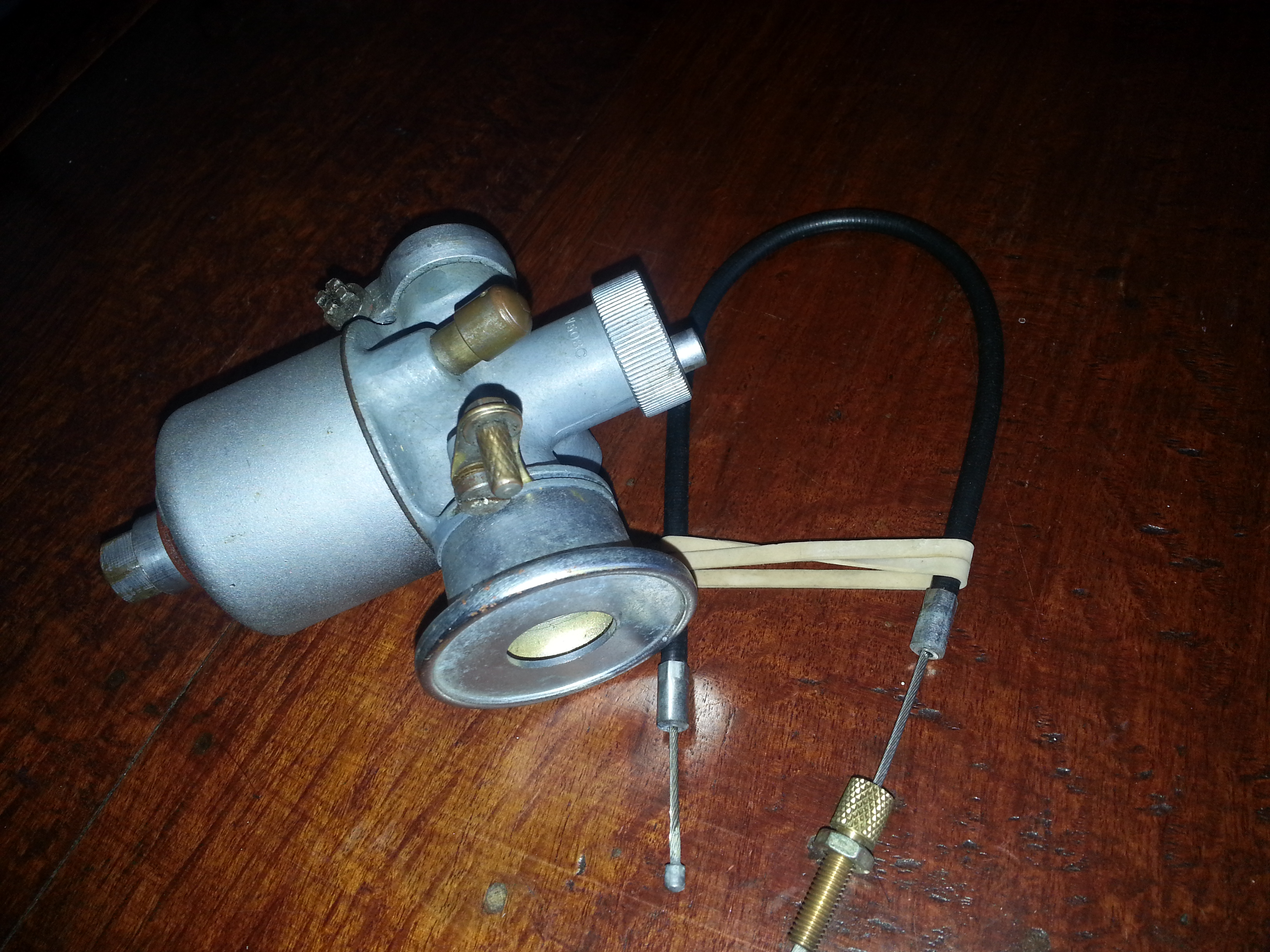

Carb Sorted!
Thank you very much Charles.

That will sort the old dear out B.
The correct carb will work SOOOOO much better than any old replacement that fits and sort of works!
Fuel mix screw might need to be "fiddled with" to get it spot on. (i bet you end up at around 1/2 turn down from flush or somewhere very near to that)
Have you done a basic compression test on it yet?
Most of mine push out between 90-105 psi and run quite sweet at that, although the latest one i'm working on is quite a bit lower at 75psi and is a PIG to start.
The 3 LS's that i have now seem to be about right at 1/2 turn down from flush. Plugs not too sooty (grey/brown) with just a little bit of wasted oil mess around the outside of the electrode. (10:1 fuel mix)
All 3 of mine have a 7/16 carb, the newest being 36688 so one of the last ones, which might confirm that all LS's have (or should have) a 7/16 carb for best results.
