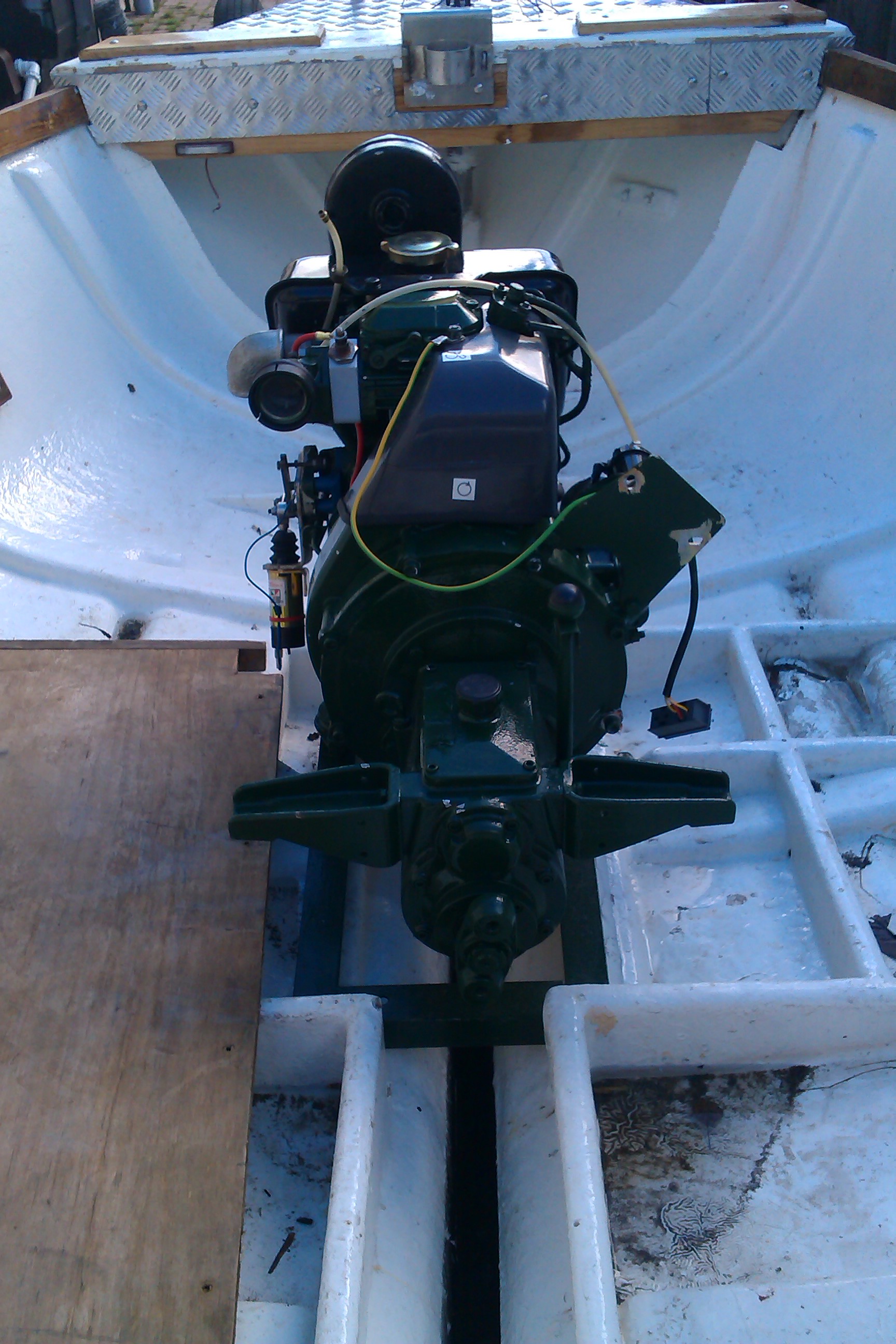

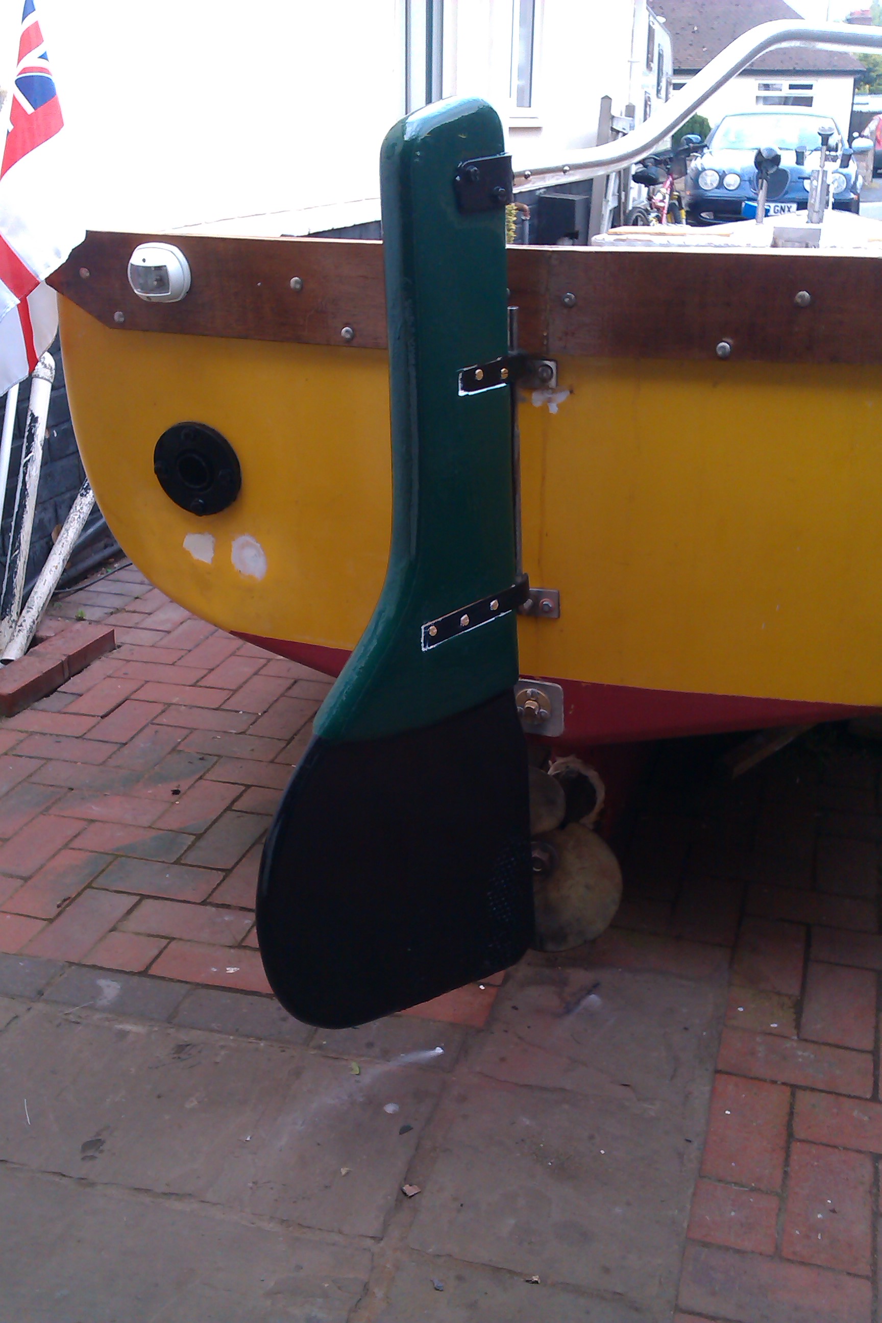

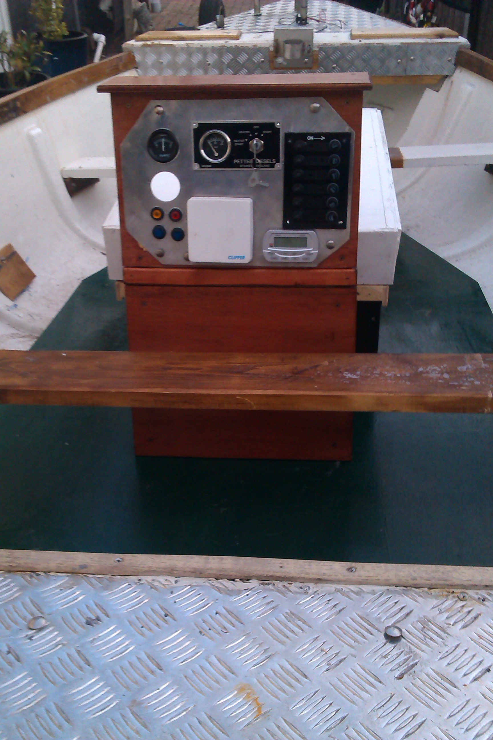

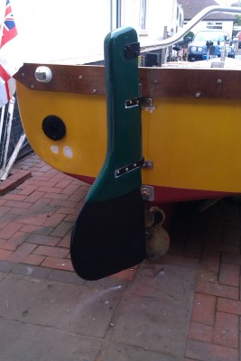

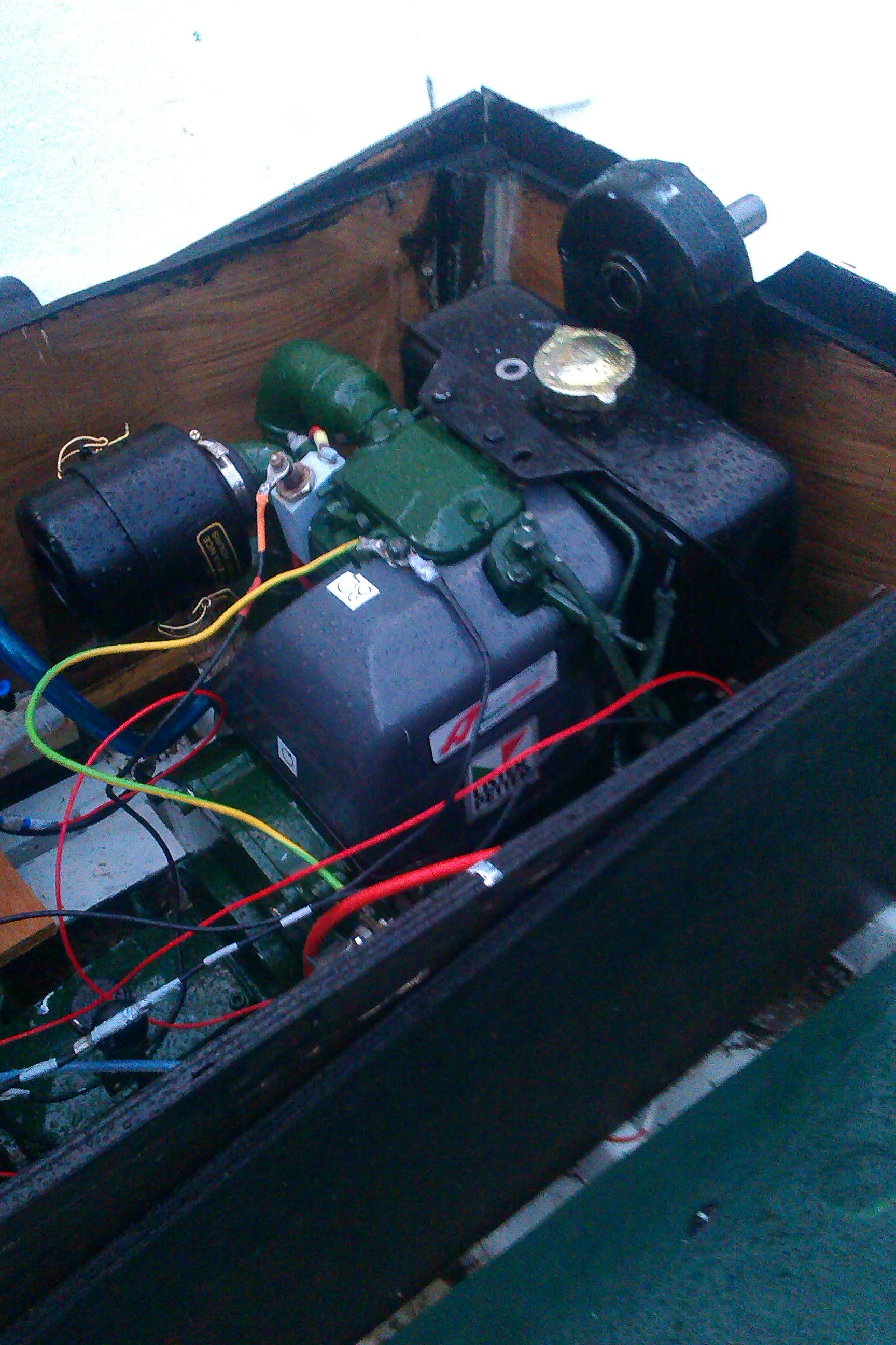

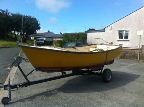

bought this hull 2 years ago and fitted a lister petter. the century plus pushes as well as the 6.5 lister

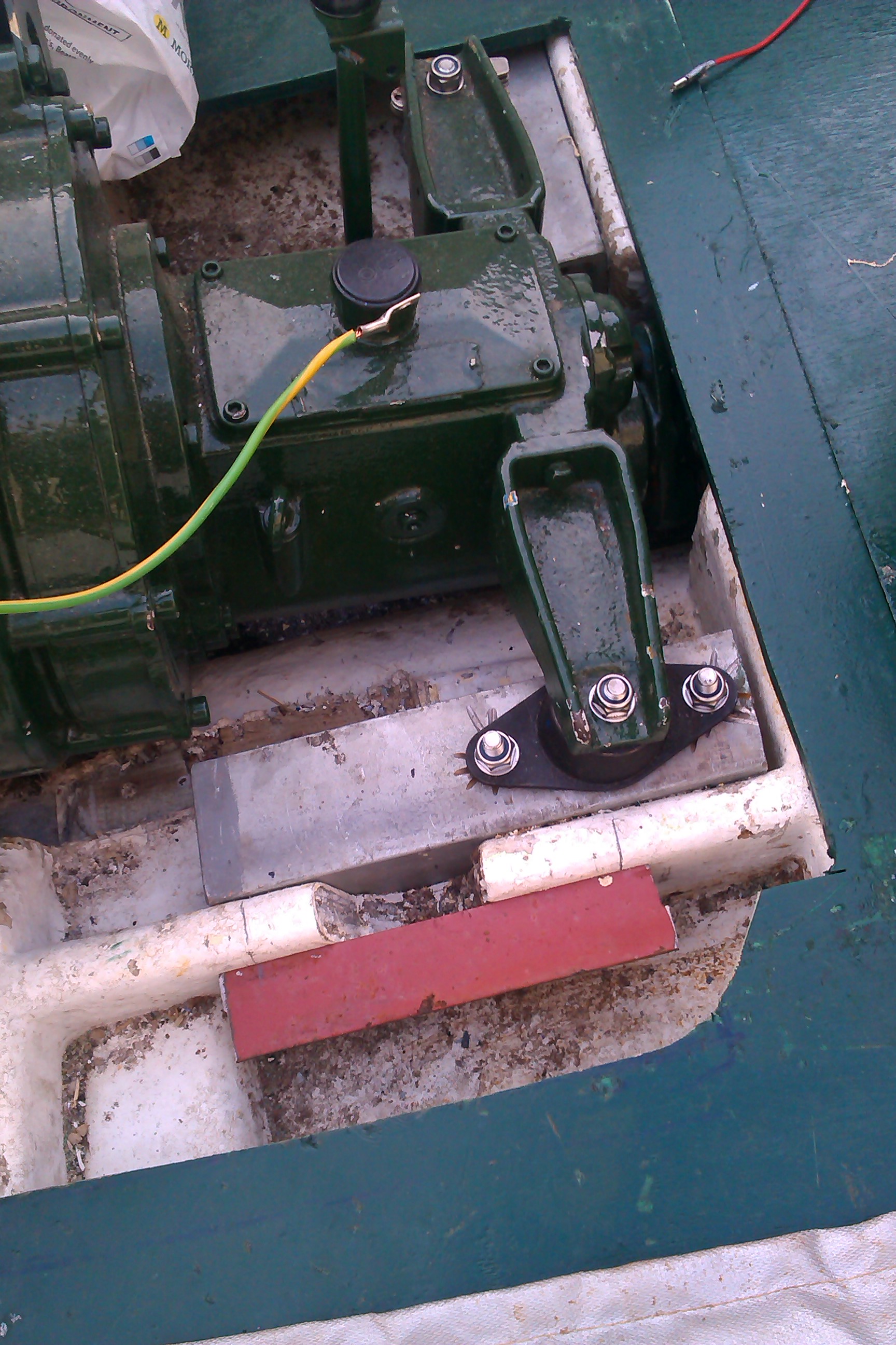

hi df to be fair it was not too hard fitting the lister in the boat the engine did just fit low enough to line up with the shaft with a bit of luck more than any
thing all went well not a professionl but a solid diy job.
as of the angle of degree the engine is at i was luckey the lister came with a deep sump.
i bought the engine from a chap on smokstak new old stock and the som gear box was reconditioned
it starts off the key or by hand and has abuilt in charger system.
i fitted an oil catch pot on the breather incase it gets rough and the extra oil in the sump goes through the pipe cause a run away .

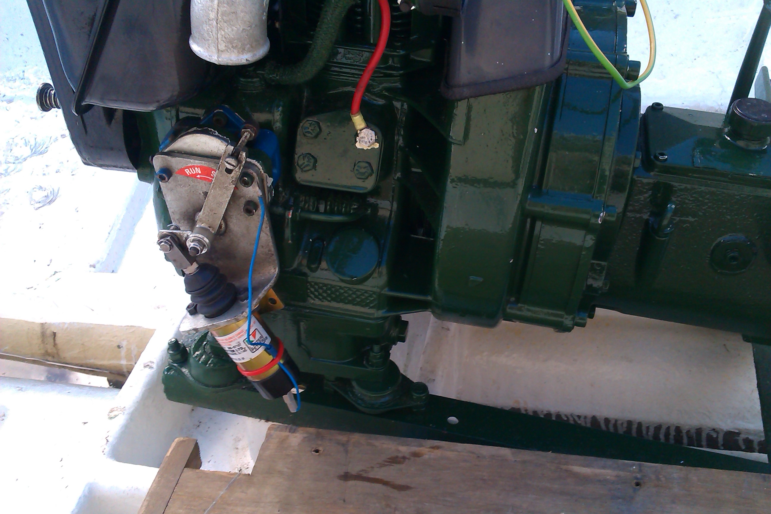

the actuator you can see has a 12v feed through the oil pressure switch so if the wee boat gets bounced about and i lose oil pressure the engine cuts out.
both mods to be honest not needed.

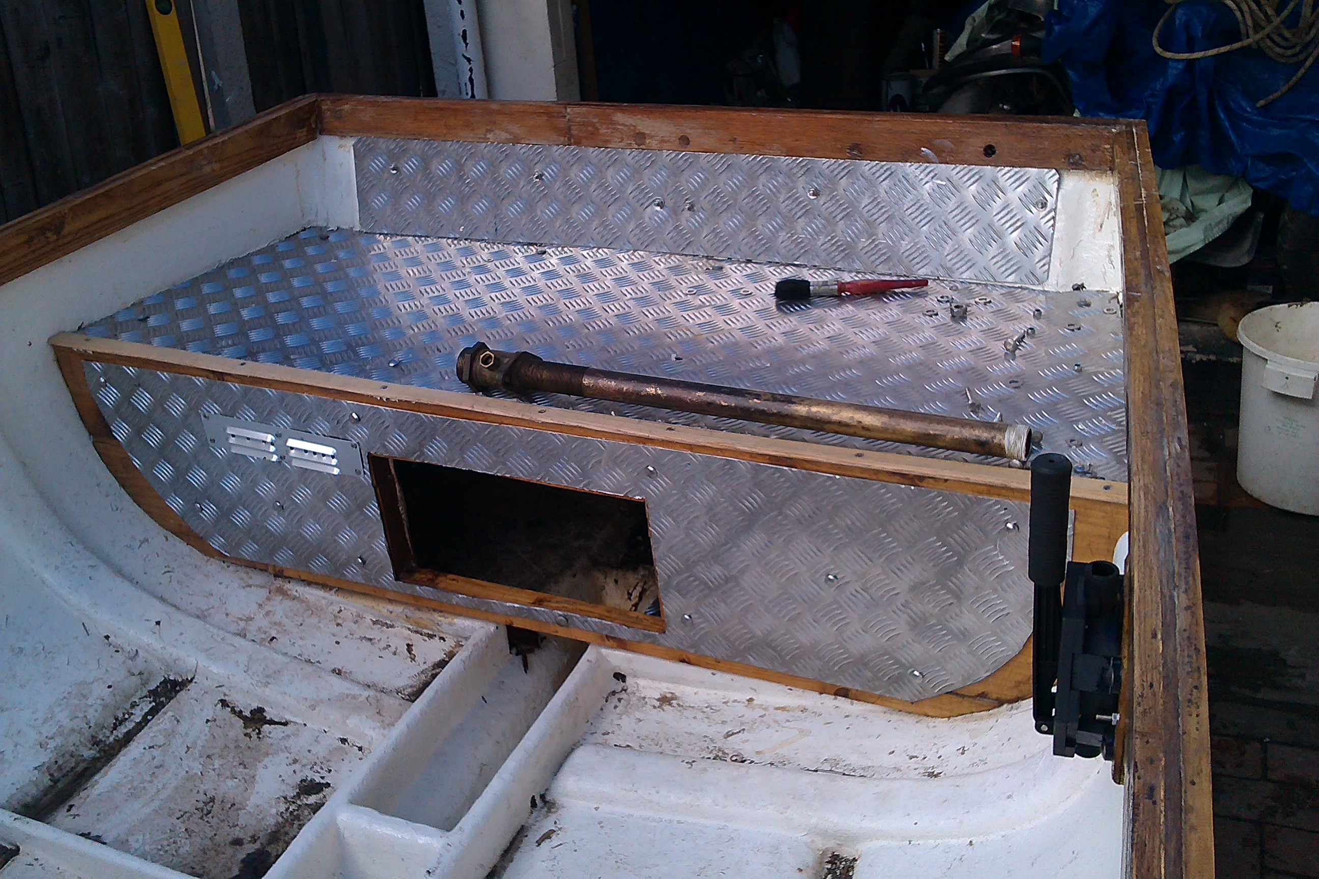

yes i used a stuffing box and yes it needs a small drip out of the packed gland to keep the packing from burning.
just like the gull, lister giver reliability and solid build and the parts are cheap. hmmmm i have 2 more liser engines a 6 hp and a 7.5hp and a spare som box.
seagull bug and the lister bug yes and the dinghy bug, well i do not drink or smoke so hording is my vice.
