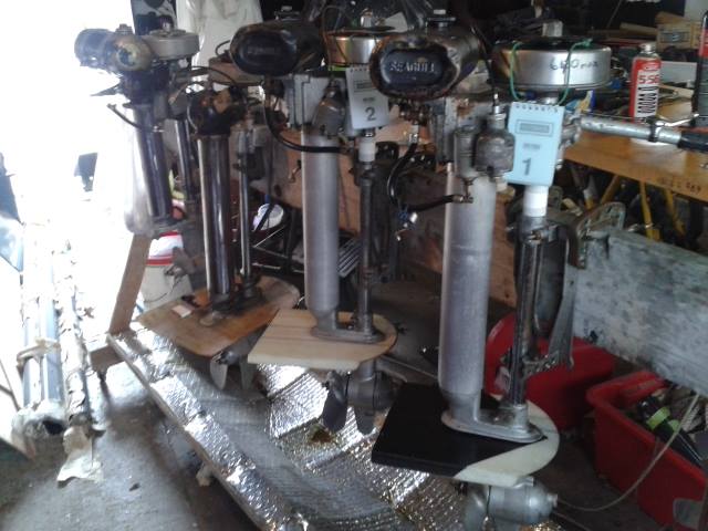

I made a anticav pan!

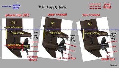

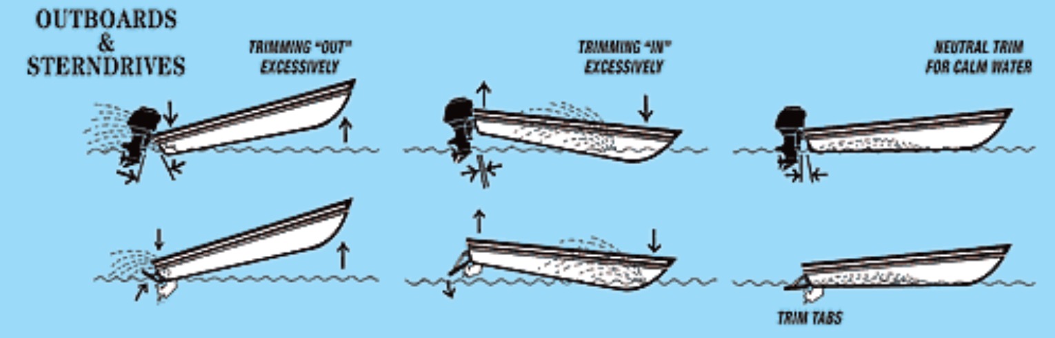

Middle set of pics is how my boat seems to be running at the moment!
Even though the thrust block is set as far out as possible, it still isn't enough.
I'm re-thinking with a block of hardwood cut into a wedge "sandwiched" between the bracket and the transom. This way i can set the motor to vertical (first set of holes on the trim setting) with plenty of option to go outwards more if i need to.
Re: I made a anticav pan!
Your problem might not be the motor angle Jon, it's probably designed for the weight of a 15hp + motor & to run at more than 5 knots, some time after 5+ knots you will start to get bow lift.
The bow down attitude doesn't matter, when the only time your going that slow is when your driving in & out of the marina, when it's fitted with the correct size power unit.
The thing is Charles, even when the boat is completely empty, it sits very level in the water.
The transom has got quite a bit of rake to it, so even when the motor is adjusted OUT as far as possible, it's just not quite enough. (i know that now)
I've done some quick measurements with brackets and levels and come to the decision that with the thrust block set to maximum OUT on the bracket, (century/102) the motor is STILL not vertical by around 15 degrees or so, maybe a bit more. Hence the decision to make a wedge to get things more or less vertical to start with. Can't do any harm can it?
It was only A-J that commented earlier this year that he thought the boat was trying to bury itself in it's own wake?
ODD as i was carrying some (ahem) "heavyweight passengers" in the back all the time, which should have offset this a bit.
Interesting that you mention about a heavier motor, as the boat originally came with a 40hp merc which i never could get to start, let alone run!
I'll have a look at the weekend for some wood to carve. Should be fairly easy to sort this out i should think.

So how is the Pan going?
I am going to copy what Olympics have.
I got another 2 1/2 knots out of my boat by adding one..... things may still change with a full tank of fuel in the bow.
