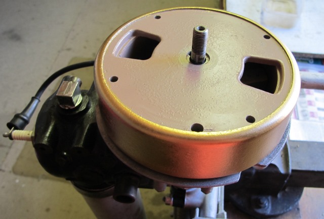

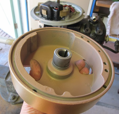

I have serious safety reservations with filling flywheel dinks with epoxy or any filler, at full revs the flywheel surface speed is around 70 mph, a flake of epoxy that comes unstuck could hit you in the face at that speed, the chances are, that as you've sanded & painted the flywheel, they could have sharp edges, not too good for an eye!

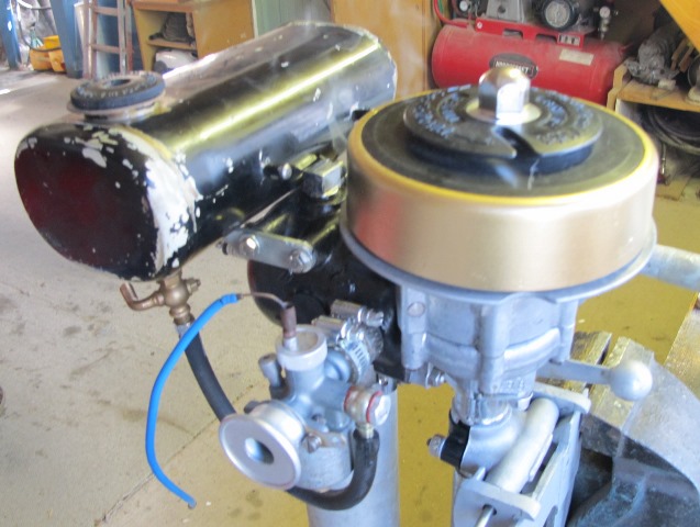

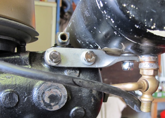

I had one section of flat bar nearly the correct shape, it was easy to finish the bending and drill one more hole.
The second tang can be done next.
I have turned the tank around so that the fuel line to the carb can be one that I have and a short one.
I really did not expect to reach the stage where fitting the Villiers carb can be a reality, today I proved that the Wipac 2 coil provides a good spark, next I need to fit the carb and a throttle lever to the epoxy bonded control arm that I repaired today
Note, the twist in the 20mm x 4mm mild steel flat bar can be done cold with a large steel bench vice and large adjustable spanner .

Charles uk wrote:I have serious safety reservations with filling flywheel dinks with epoxy or any filler, at full revs the flywheel surface speed is around 70 mph, a flake of epoxy that comes unstuck could hit you in the face at that speed, the chances are, that as you've sanded & painted the flywheel, they could have sharp edges, not too good for an eye!
Thanks on your concern, noted.
The size of the dings were really small, the epoxy bonds super tight and is then coated with twin pack etch primer before the top coats, the paint adds to the bonding.

With the epoxy paste and then the glass fine weave tape and epoxy liquid now cured I have a solid control arm once more, next will be to paint it silver and have it looking sort of normal?
This really has turned out to be an odds and sods parts bin rebuild, still as it started with a seized motor, to get this far is good?
Next is the throttle control and then to fit the Viliers carb and see if we have a runner?

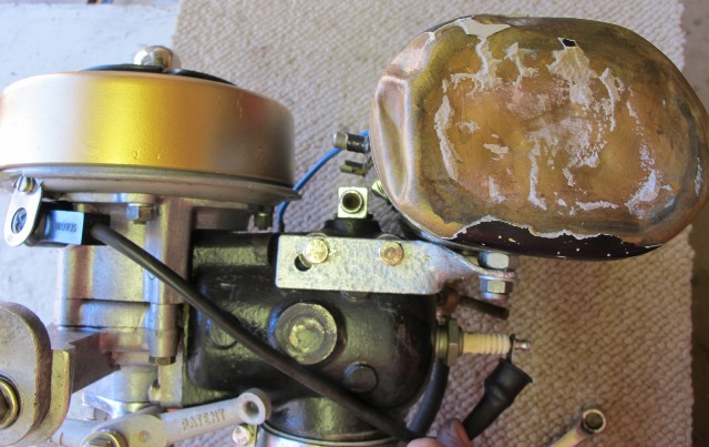

The tank flange mount on the steering handle side went ok, its not a match for the other side but works well enough.
Note the rather beat up tank, I would need to cut the end off to sort that mess out ?

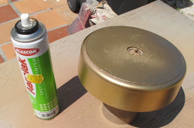

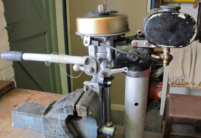

The painting went as before, bead blast the old paints off, wash the cleaned metal with Teepol Orange liquid soad to degrease if any paint remover was involved, then apply some Dulux twin pack hi build etch primer to the bare metal.
The gold top coat came from a Plascon paints rattle can, Plascon are makers of top quality paints and to a similar standard as Dulux.
For the block I have used black DTM (direct to metal ) paints made by Duram, another quality paint manufacturer.
- Posts: 395
- Location: Hout Bay

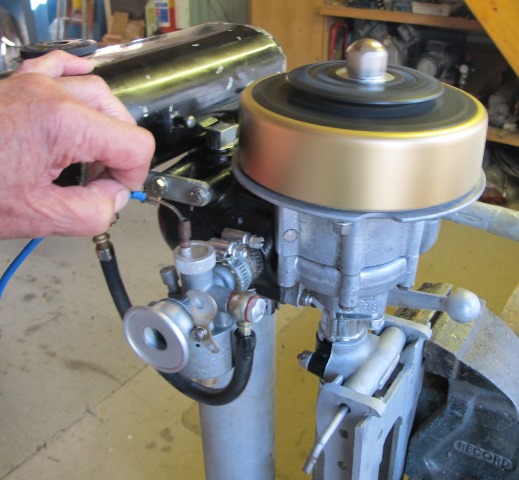

This 102 engine has been fitted with a spare Seagull Villiers carb, as I do not have the correct Amal 2 jet carburetor.
With a 10:1 petrol to 2 stoke fuel mix in the tank, I had the engine running on the third pull of the starter cord
I had to use a hand throttle control as I do not have a throttle cable that is long enough to reach around the flywheel and to the throttle control lever.
Job done, whats next as this is my last British Seagull engine, it was brought back from the dead after being seized near solid.

Now that the engine has been run a few times I can report that throttle response is good, I notice no difference between this 102 series and the Forty series with the same sized carburetor.
There is no exhaust smoke either, so as I suspected I think this motor has very few hours on it?
The camera is a Canon G11 which will now be ten years old, check the way it has stopped the flywheel black plastic cover but we can still see the gold paint is spinning.
I should say that this 102 engine and assembly rebuild was an interesting adventure, as up until this engine I have never needed to open one up to remove and then rebuild and engine.
