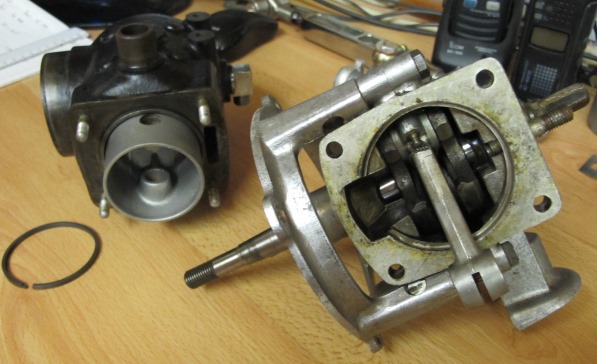

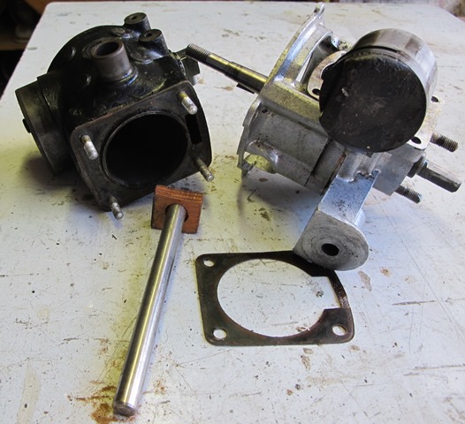

The motor has been opened and found to be in really good condition, so much so its close to being new, why it was seized I have no idea, there is no evidence of water, it was the second piston ring I think?
That stainless steel rod and plywood scrap was the push rod that I used with a large G clmp to press the seized piston out of the bore and via the spark plug hole, the idea worked rather well.

[quote="african imp"]The motor has been opened and found to be in really good condition, so much so its close to being new, why it was seized I have no idea, there is no evidence of water, it was the second piston ring I think?
The piston once removed was soaked in an oxalic acid solution overnight, I have now freed off the second ring, the first ring is still firmly in its groove but given time I think it will free up.

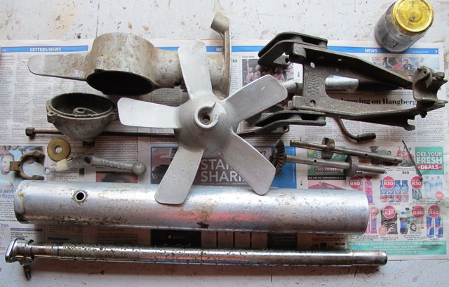

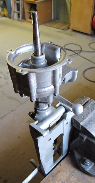

My parts bin may not have the right sized gear box for a 102 motor?
Can I fit a smaller sized gearbox, I may have to use the smaller Viliers carb as well?
I wll have the motor and down tubes, there is no shaft to the clutch, my prop may be too small?
Lots of questions.
Lots of questions.

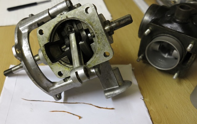

The motor I am using had a seized piston, it was some calcium type stuff under the top ring.
When the block was removed from the crank case I found some strips of red silicone material.
If they were from the crank case joint, a factory build, I have an idea that this motor has run very few hours as the silicone would have been blown out the exhaust a long while back otherwise ?
I will open the crankcase and reseal it just in case of a leak?

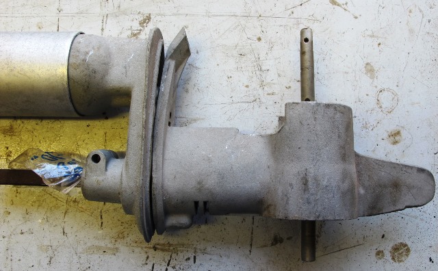

The only complete gear box that I have may be too small for a 102 series engine?
- fleetingcontact
- Posts: 275
- Location:
A 102 coupled to a featherweight gearbox is probably the most common 'racing' Seagull out there. What you have there appears to be a 12:30 reduction sealed box as fitted to Silver Centurys and later Fortys. The only issues are making a good seal between the box and the pump housing and (naturally) lining up the driveshaft. Apart from that its all good. Suggestion: make your own gasket from aluminium and seal with goop.
african imp
- Posts: 395
- Location: Hout Bay

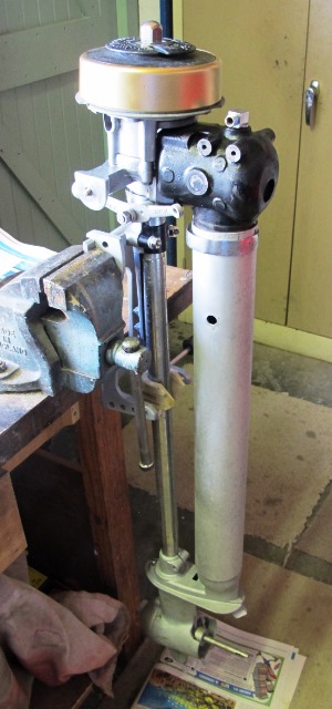

Thanks on the advice, I have now test assembled what may work, the parts seem to fit?fleetingcontact wrote:A 102 coupled to a featherweight gearbox is probably the most common 'racing' Seagull out there. What you have there appears to be a 12:30 reduction sealed box as fitted to Silver Centurys and later Fortys. The only issues are making a good seal between the box and the pump housing and (naturally) lining up the driveshaft. Apart from that its all good. Suggestion: make your own gasket from aluminium and seal with goop.
The flywheel is a spare.

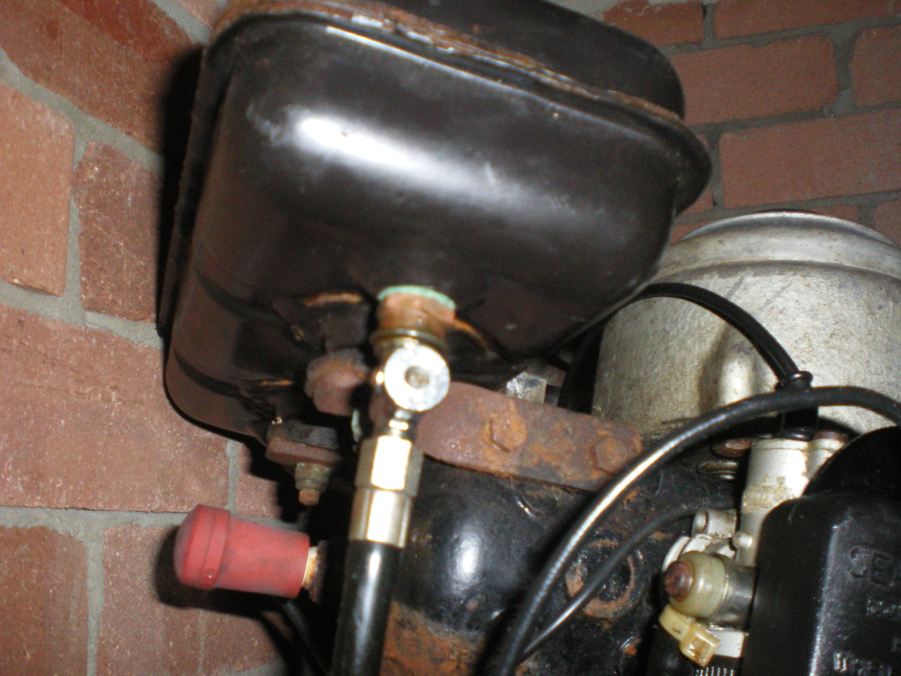

I do not have the correct round fuel tank, Is there any info on fitting the later rectangular fuel tank to the 102 motor?
- fleetingcontact
- Posts: 275
- Location:

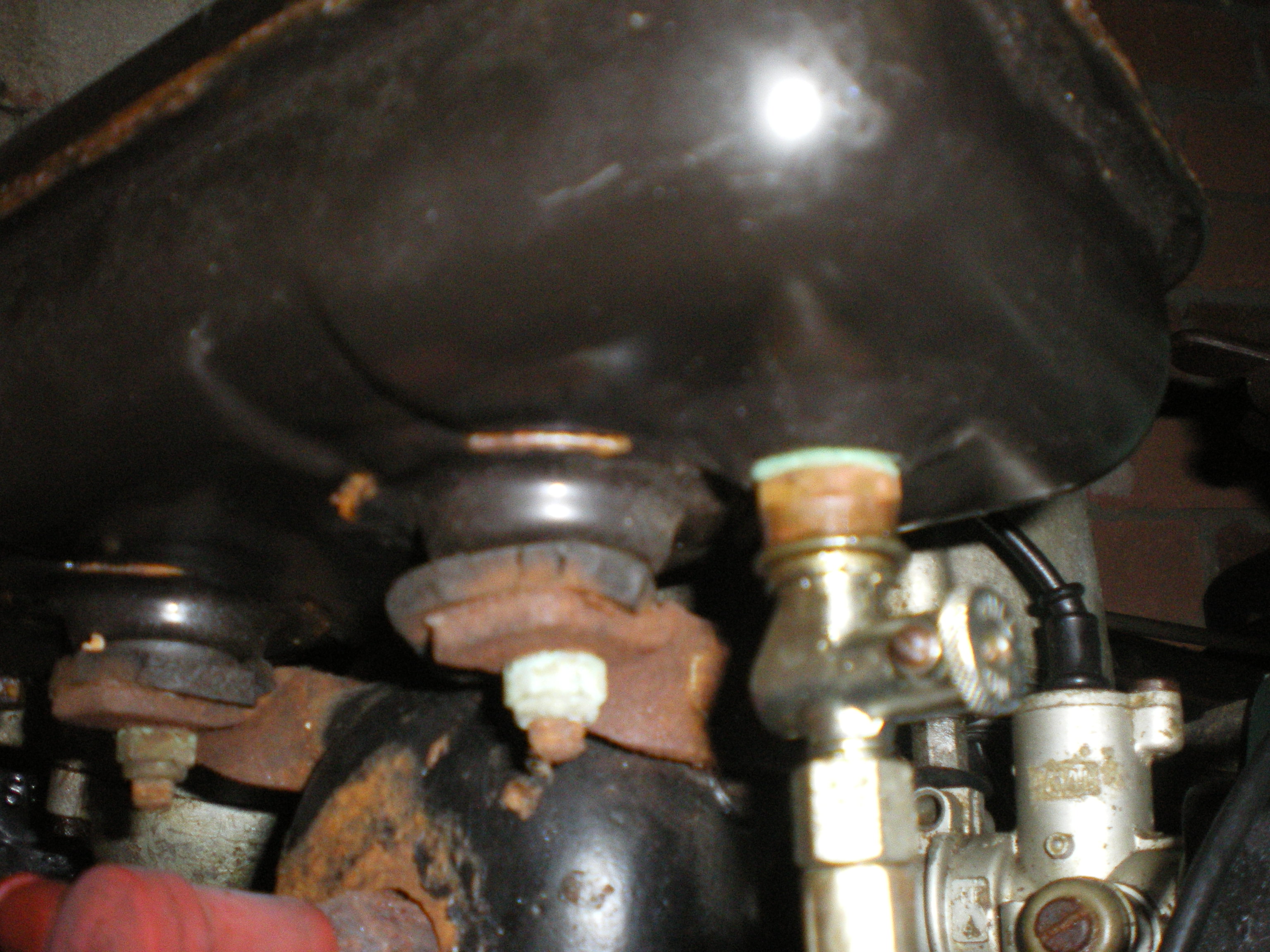

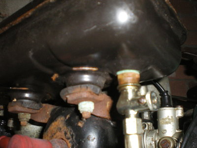

Look at Seagull101's ED 102 in the for sale section (Jacob, can you post a higher resolution pic please). To my (limited) knowledge this was the only 102 which featured a square tank. The model was probably not that common and the chance of finding some mounts are, I presume, slim.
So you either find the more common earlier types or get busy in the workshop - can't be that hard...principal tools for the job - angle grinder, drill, blowtorch, BFH.
Yes... rectangular strip of iron with 90 degree twist and three holes. You could use an oval tank using same principle!

Hugz wrote:Yes... rectangular strip of iron with 90 degree twist and three holes. You could use an oval tank using same principle!
Thanks, I see the twisted flat iorn and I have some in stock some place.

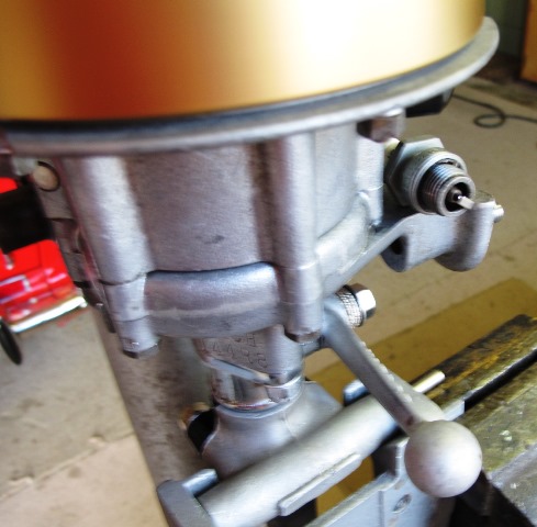

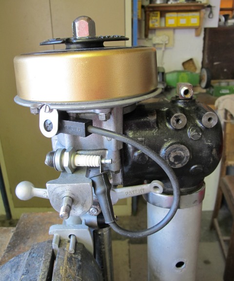

A digital meter on the Wipac coil that I did in January said I had 4.9 ohms, in practice would I see a decent spark though?
I have just run the power head up with an electric drill and a flexible joint, the spark from the NGK plug is fine
If you look closely you can just see the spark.
I am now thinking that if I had a carburetor and petrol tank on this assembly the old seized motor would run again once more?

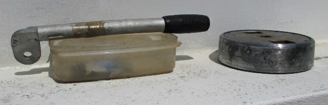

As a one time boat builder I have used epoxy glues and pastes for many years, the epoxy is in many ways a welding tool, wood to wood, wood to metal and metal to metal as well.
The only Seagull control arm I had was bent, I straightend it out and it then broke, its now bonded with an epoxy paste, when that has cured I will wrap the repair with glass cloth and a thin epoxy mix.
The 102 engine flywheel had some dings in it, I have given it a basic clean up and filled the dings with epoxy paste.
The items are out in the Sun which will speed the cure time up by some hours.
